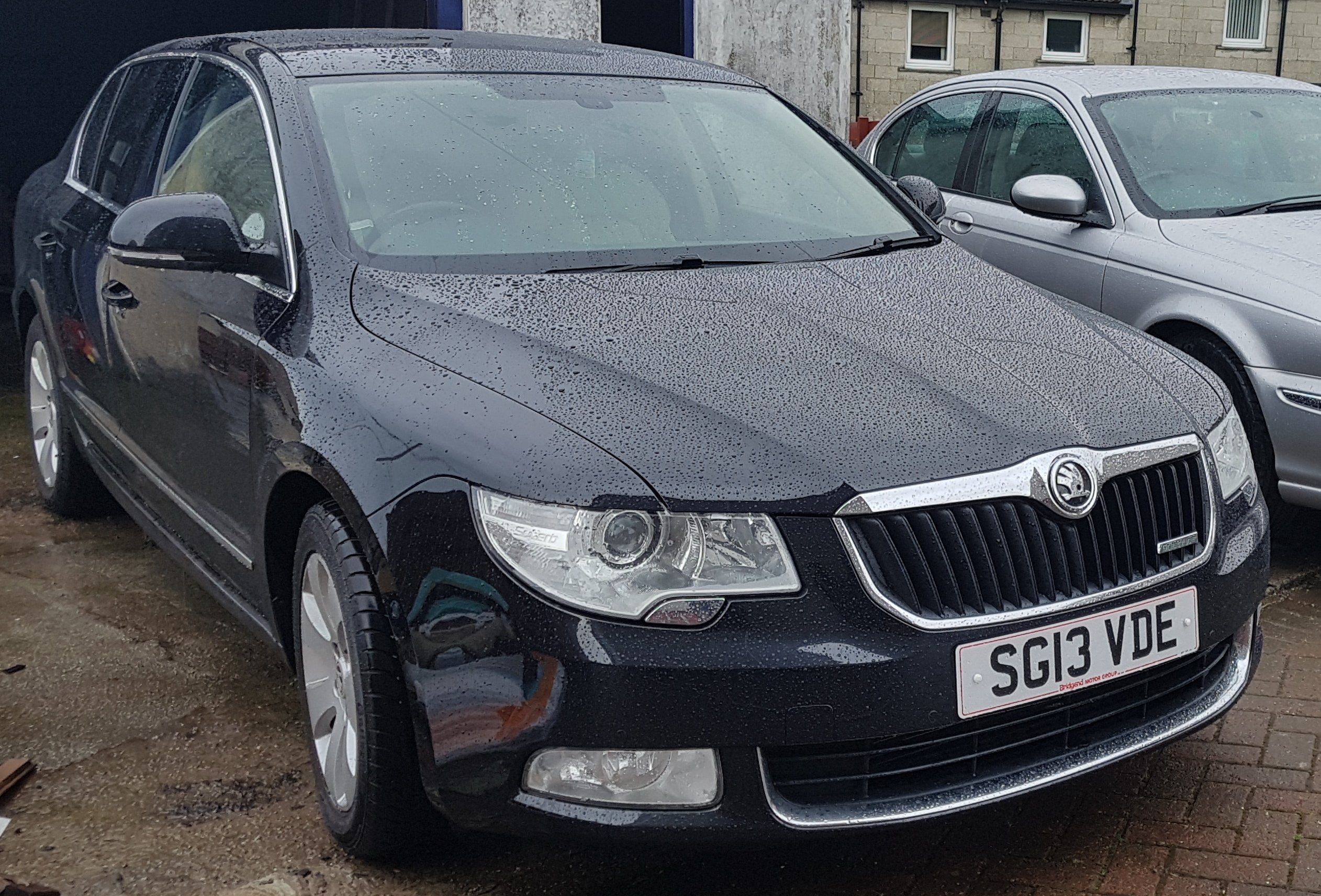

I have a 2013 Greenline Elegance and have the Bi-Xenon headlights. Yesterday one of my lights (passenger) went out on my way home. I got home and pulled the bulb out, I went and ordered myself 2 new bulbs. Out of curiosity I plugged the old bulb into the drivers side and it worked, I swapped both bulbs and the passenger side still wasnt working. I have just been out and checked all the wires and fuses, still no joy. I find it strange how it just went out without any warning. I cant find anything wrong with it and really don't want to have to take it into Skoda.
