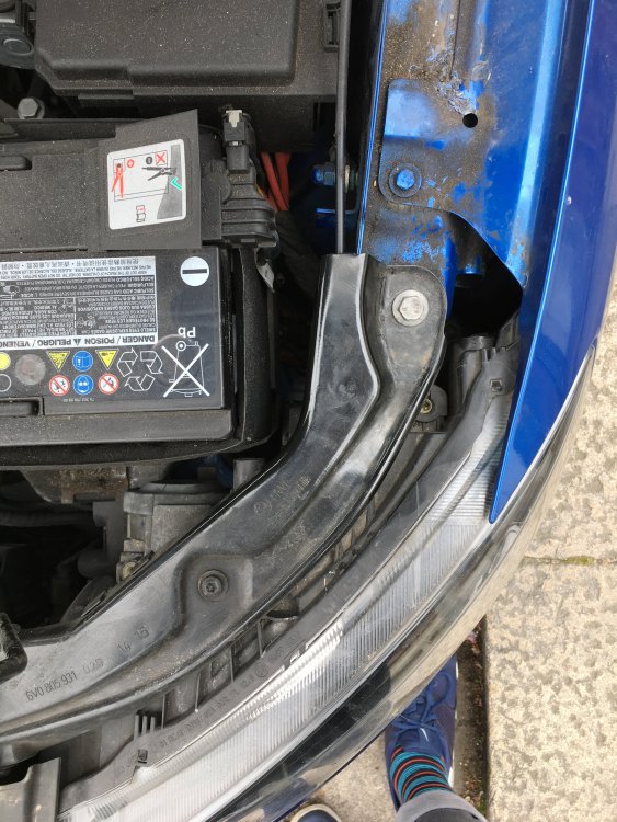

The little plastic bulb holder is just down the gap to the right of the silver bolt. My hand and wrist can only just contort between the battery and whatever the black thing is -- so can just about get it in and out, but I'm just not going to be able to get a proper look at the socket on the back of the headlight assembly, I don't think.
Excuse the socks.
Are you getting the bulb holder fully turned in the headlight unit? I would take out the access hatch in the front of the wheelarch, that's not easy either, which will give you better access to the rear of the headlight.
