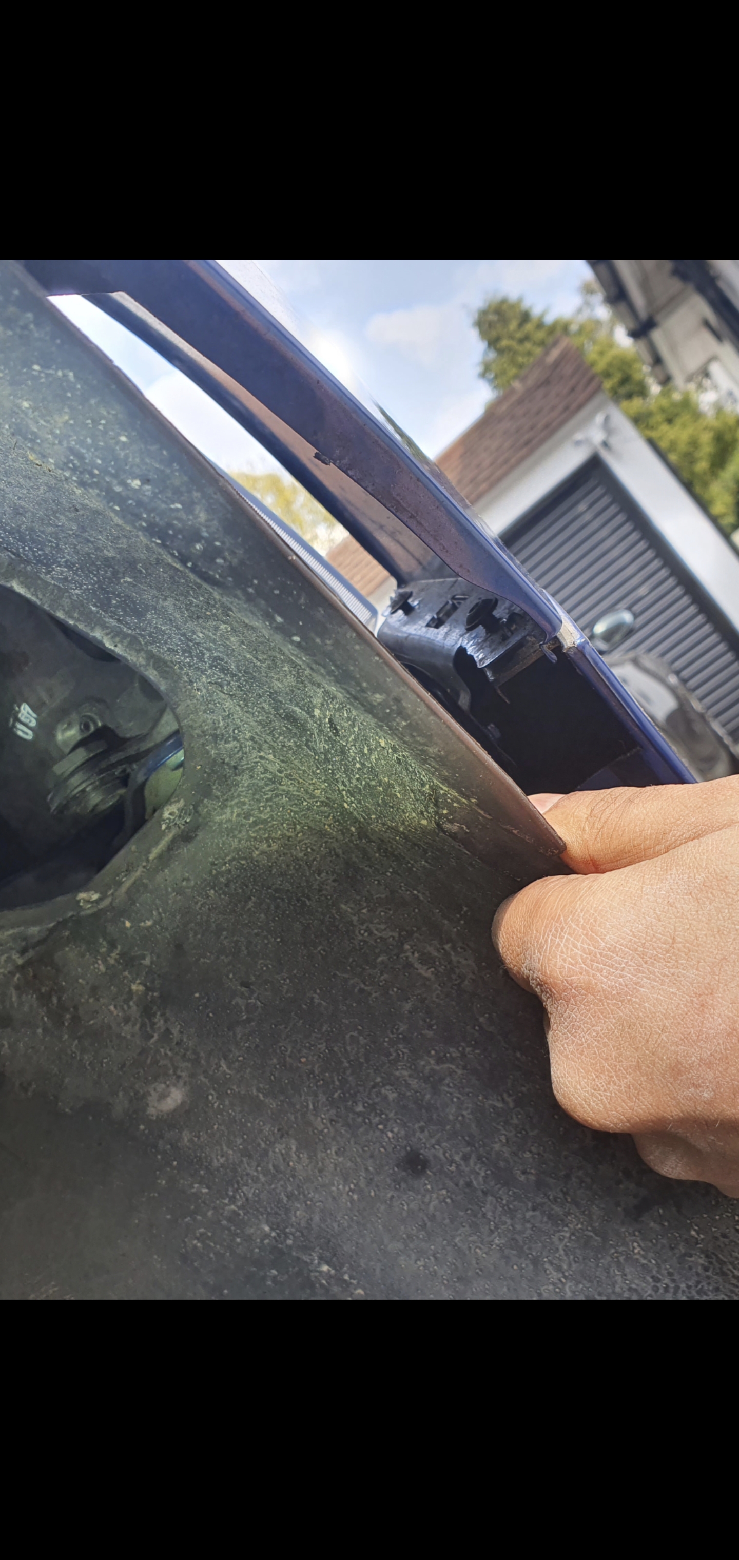

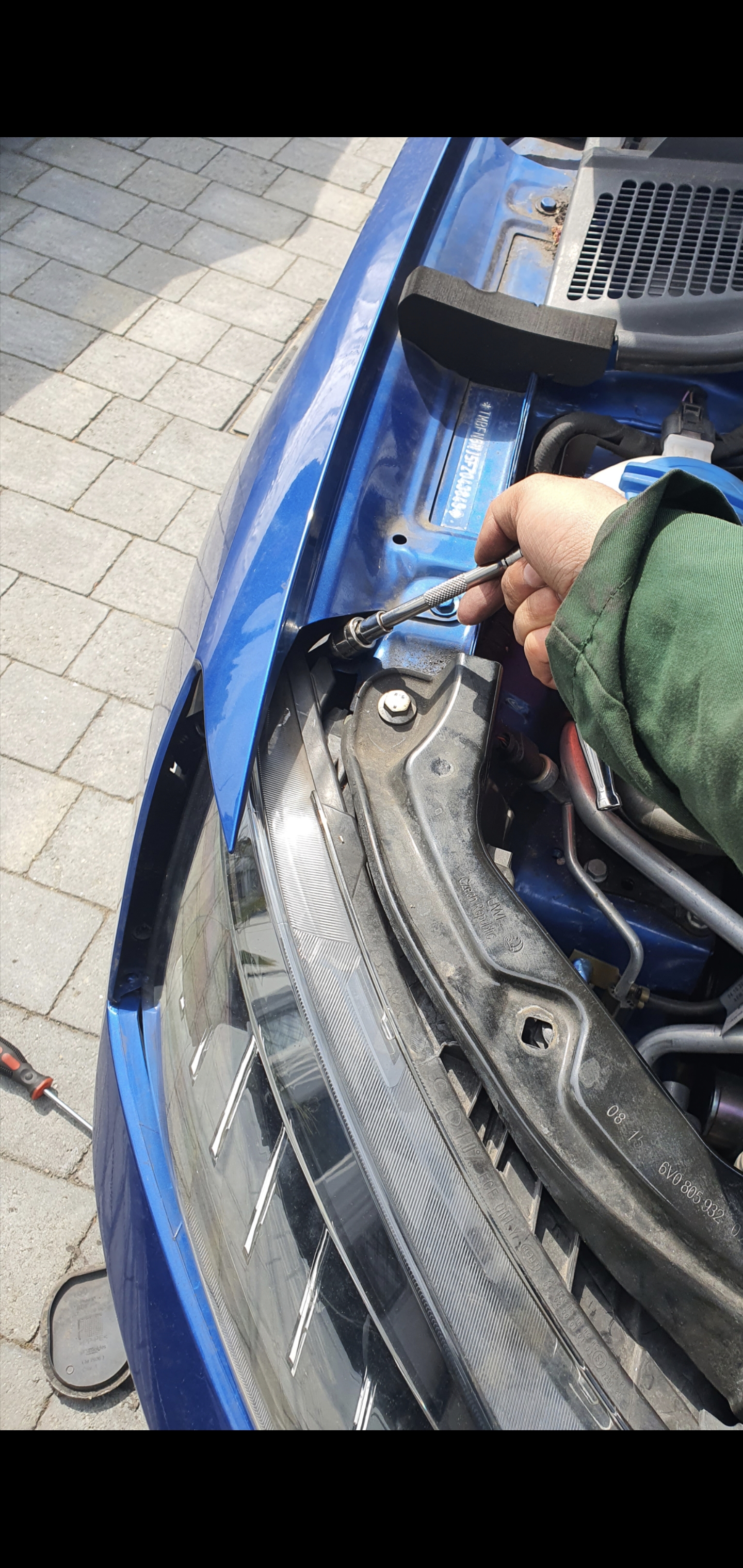

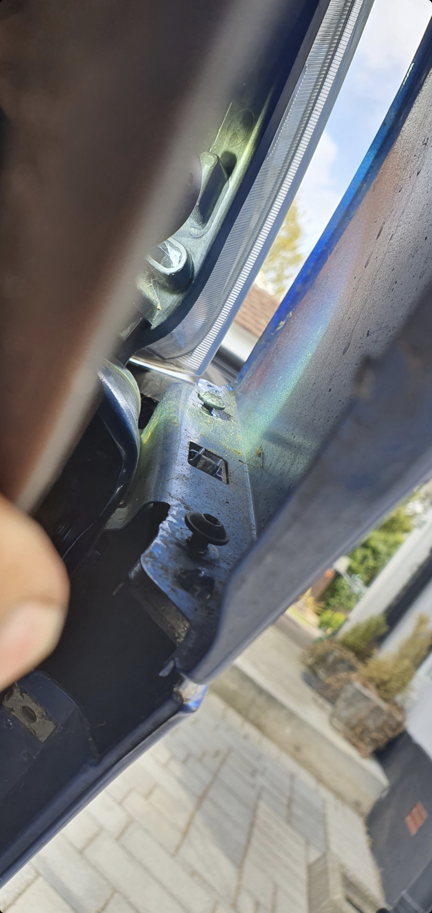

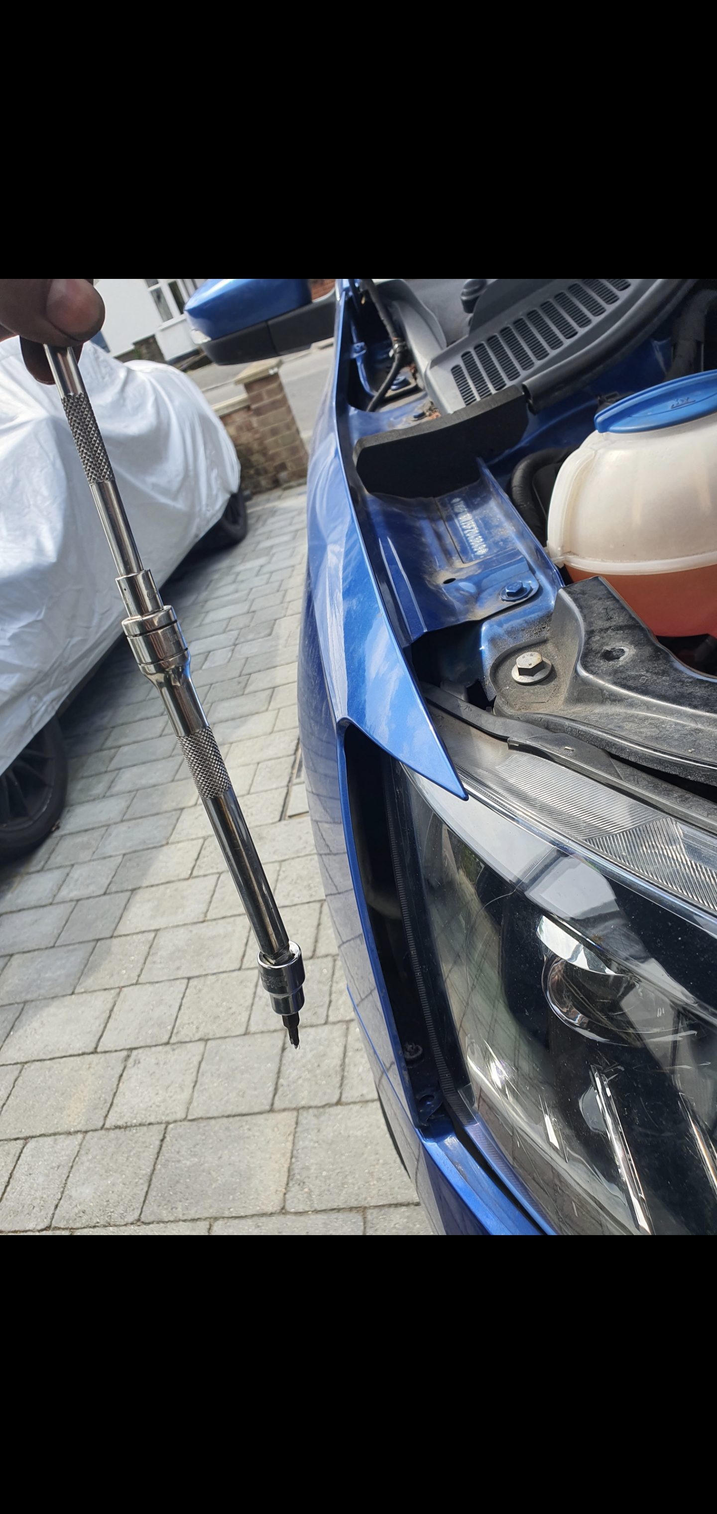

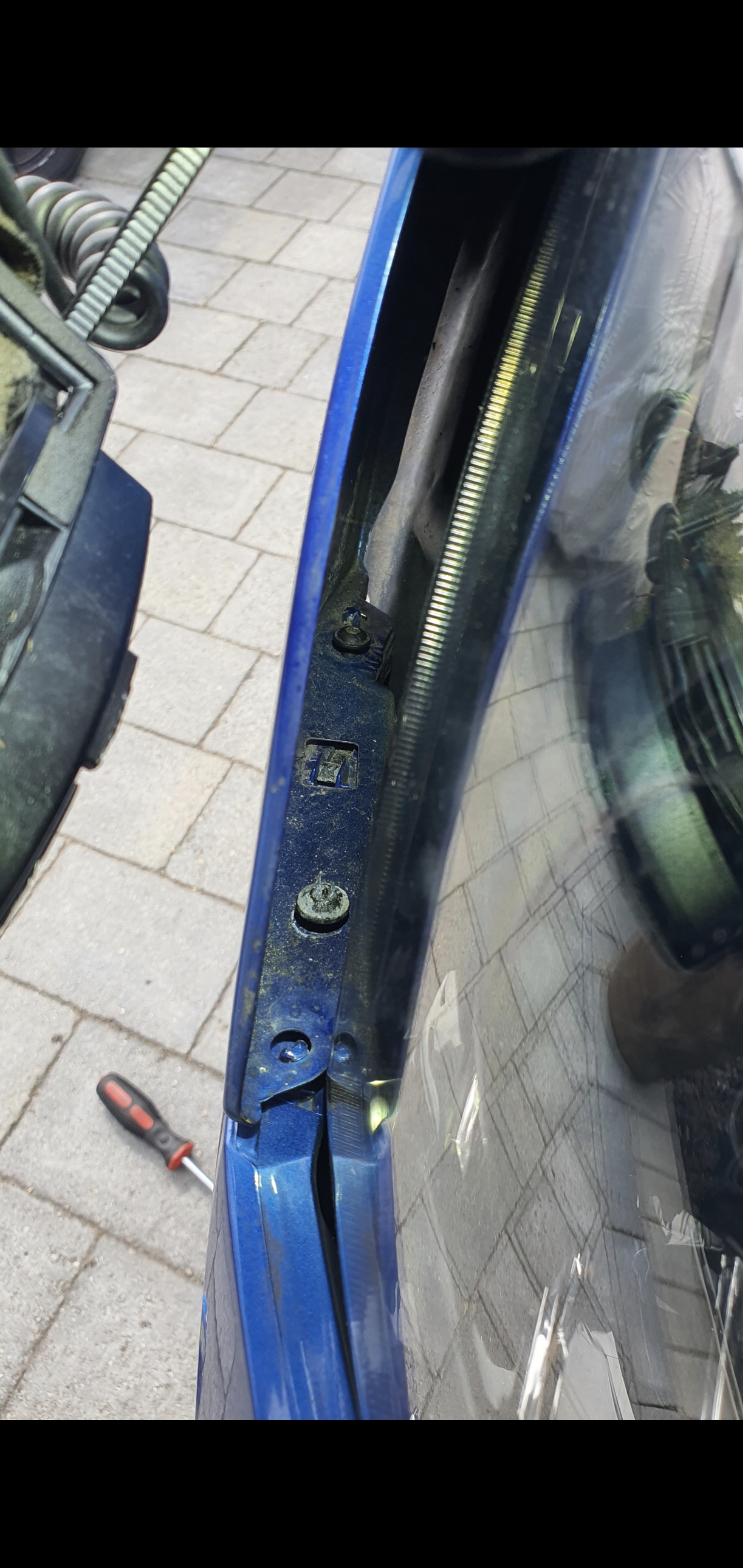

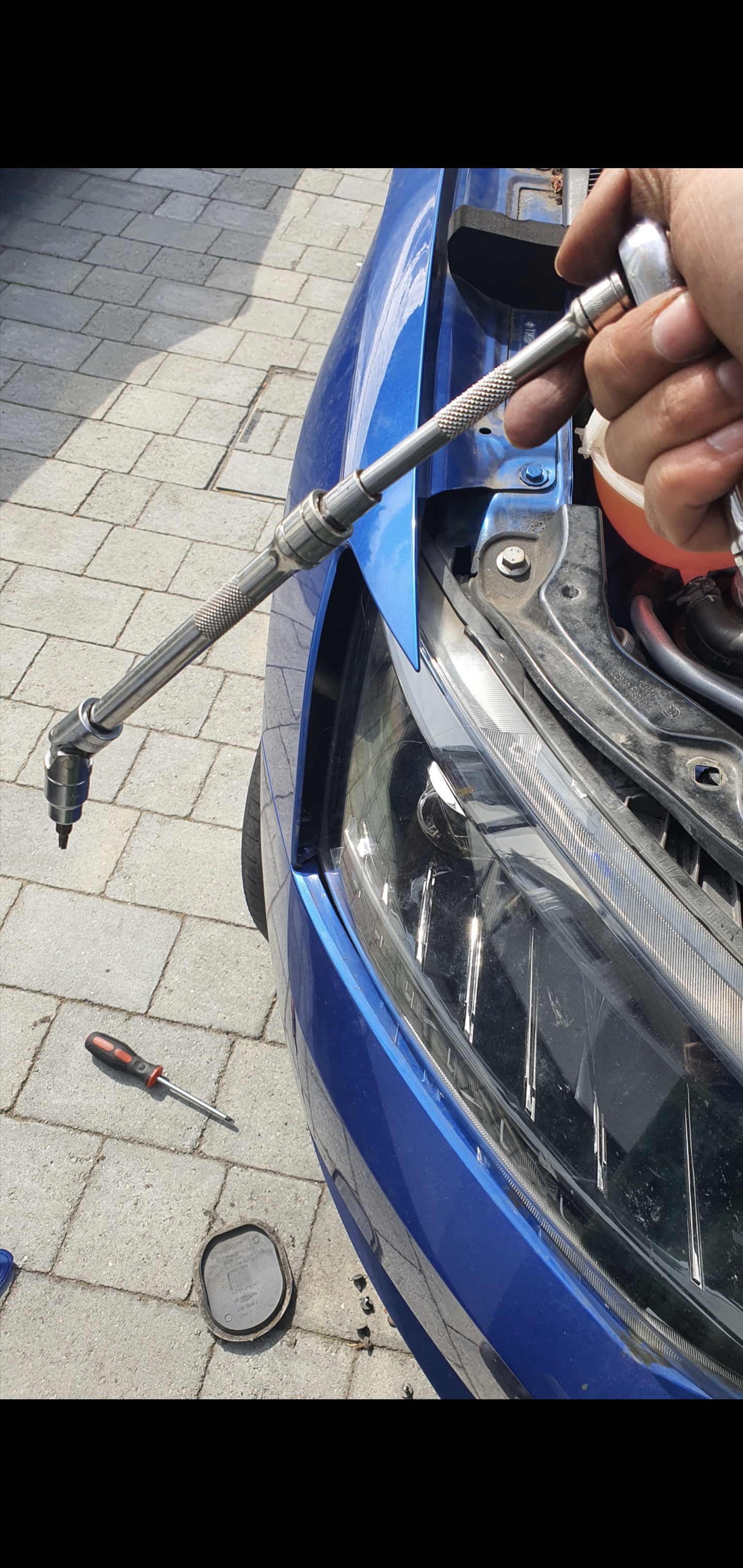

some pics of those 2 screws you mentioned above holding the bump.
I found the best way to access them is to remove the 3 screws holding the headlight in place which will allow you to wiggle the headlight exposing those 2 screws. I found best way to loosen them is via a mix of from behind the wheel arch or from up above wiggling the headlight out the way.
For the passenger side, to use the above method you will need to move the battery AND battery tray, this will allow you to wiggle the headlight out the way to access those 2 screws
