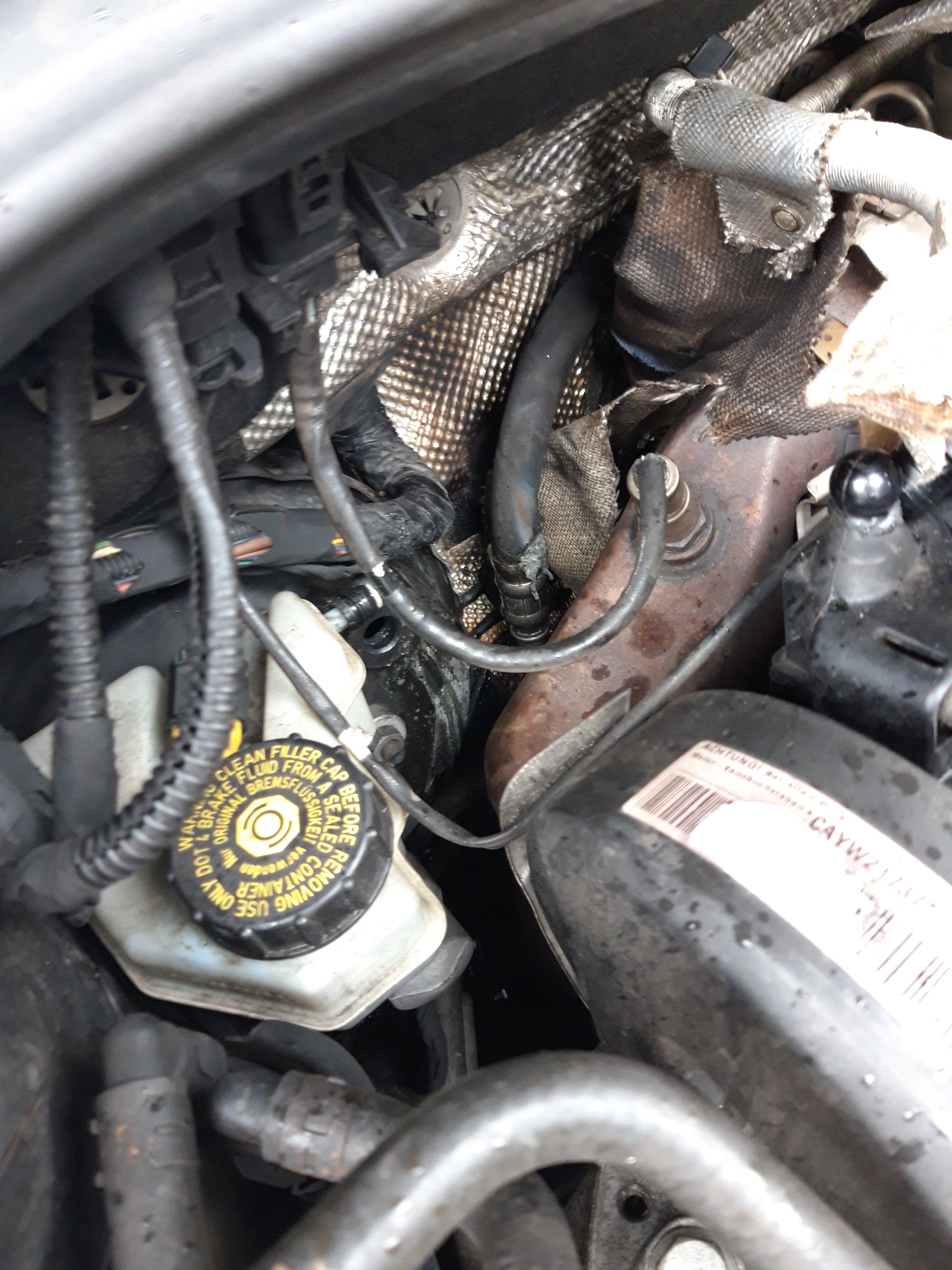

I noticed some white smoke coming from underneath the bonnet after about half an hour of driving, it seemed to be coming from the back of the engine roughly where the clutch slave cylinder is & I also noticed some sort of fluid on the engine tray along with an horrible acrid burning smell, the burning smell & smoke seemed to stop after about ten minutes of the engine been switched off. I noticed the car had been doing a regen & that's when the burning & smoke seemed to start.
Both coolant temp & oil temp were spot on & the coolant level hadn't dropped & the AA guy sent by skoda assist said the brake fluid was slightly under the max marker, it was back at skoda last year after I had the low brake fluid warning light on & I was told a pipe to the clutch slave cylinder had split & had to be replaced but I haven't had any warning lights on so I'm not sure what caused the smoke.
The car has been dumped back at hayseldens yet again to be looked at, starting to get fed up with the damn thing as it seems to spend more time at the main dealers than on my drive way.

On a more serious note, when doing a DPF regen, the exhaust area can get very (incredibly) hot, so literally anything in the nearby vicinity could be boiling/melting/burning off. My car is missing the tray underneath as a pothole managed to somehow rip half the screws out and it started making alot of noise, and occasionally bits of rubbish (plastic bags) from the road like to get stuck in there, and often end up smelling pretty bad as they melt/burn on the exhaust. It's going in for gearbox repairs on friday so it'll be getting that panel re-fitted finally.
Get them to check if there's any pipes/lines that are melted or if anything nearby is melted, a friend had his old cars handbrake cables seize up, a heat-shield had rusted off and the cables had sagged and the plastic outer shell eventually melted under the heat of the exhaust, jamming the metal line inside.
Usually it's as FabiaGonzales says, something gets stuck on the exhaust or in that tray which ends up getting burned.  Let us know what the garage finds out.

Hydraulic pipe to clutch slave cylinder had gone again & was spraying fluid all over the dpf again, this is the second one it's had on.

Mine was smoking due to brake/clutch fluid been sprayed on to the dpf & then it started to do a regen, pipe to the clutch slave cylinder is apparently too close to the dpf & the heat damages the pipe.

this exact thing happened to me yesterday  on my diesel superb,smoke from around back of the engine bay,horrible smell, just had cambelt and water pump replaced 2 days before from dm keith
I've got exact same problem was sitting at mcdonalds drive through when clutch pedal fell to the floor and smoke started comming from rear of engine bay

you will have heat damage see the above , answer from rich_84
Probably only apparent after letting a main dealer or other garage work on the vehicle.
If it really is too close and not a case of them breaking or disturbing a retaining clip I would expect a recall.
