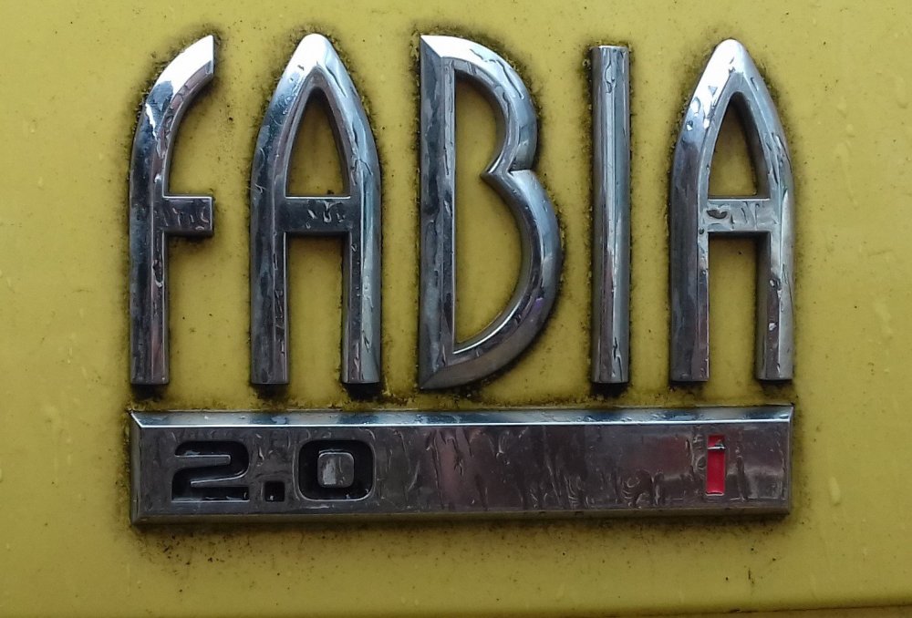

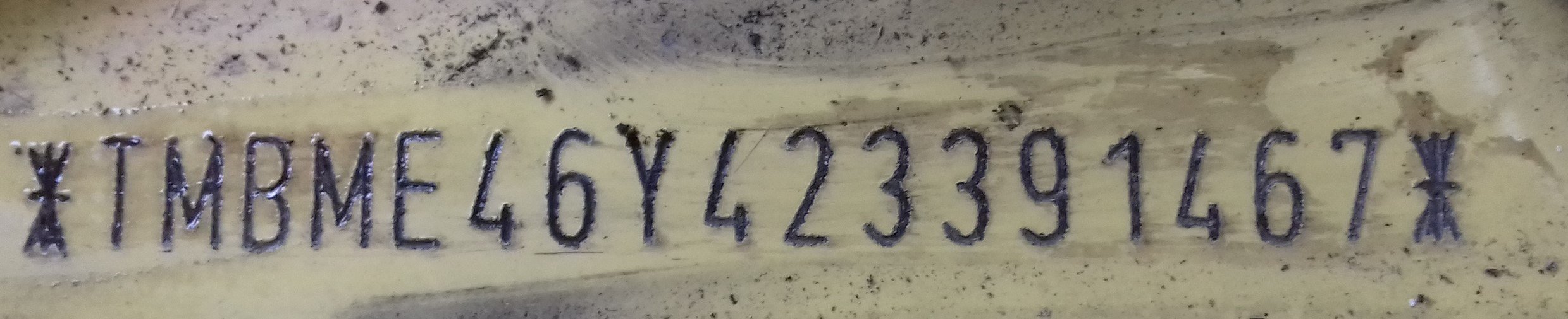

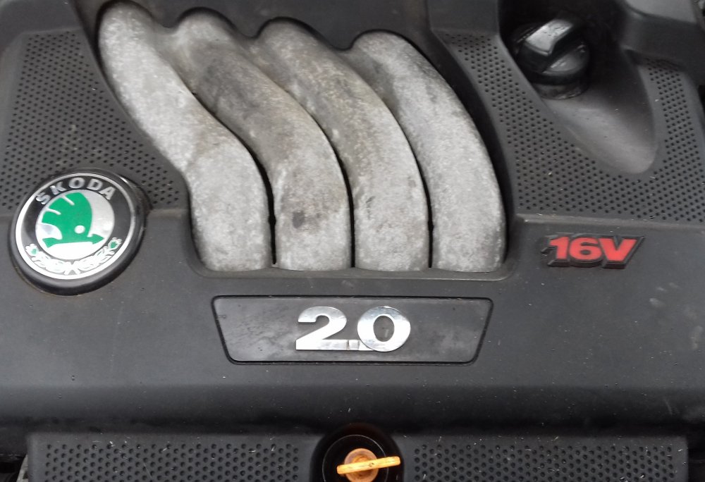

Do these help to shed any light on my mystery ?vin.thumb.jpg.fd08bc69468e93d925da8e2ac7bc16f0.jpg794013669_fabiarearbadge.thumb.jpg.45c3bd08983b5494f4a1bf3b42ce9a63.jpg1842349286_engine1.thumb.jpg.1de94da7f5f79fd40d5c75dd45fc59c6.jpg

That's odd. I wonder if someone has stuck that 16v badge on the engine cover.
  • Sponsor
Possibly an engine transplant, or a non-original engine cover. or 16V label, or I'm about to learn something....
The VIN should've helped, except the fifth character doesn't match any of the ones in my decode list for engine types:
A 1.0 l / 37 kW petrol engine
B 1.4 l / 50 kW petrol engine
C 1.4 l / 55 kW gasoline engine
D 1.4 l / 74 kW petrol engine
S 2.0 l / 85 kW petrol engine
F 1.9 l SDI / 47 kW diesel engine
H 1.4 l / 44 kW petrol engine
S 1.9 l PD TDI / 74 kW diesel engine
U 1.9 l PD TDI / 96 kW diesel engine
W 1.2 l / 40 kW petrol engine
Y 1.2 l / 47 kW petrol engine
Z 1.4 l TDI PD / 55 kW diesel engine

I'd look at the steering column angle sensor....usually fail & throw up lights & very intermittent power steering....& I recon you have 2lt 8v......The Fabia MK1 was made in Elegance spec with the old VW 2lt 8v engine….heavy lump...but the car got side skirts & front & rear bumper add-ons etc...
It's a tool-eater 8V AZL, it's a TRW PAS pump so that's really all you need, however it may be the angle sensor rather than the pump so getting the codes read would be ideal.
I have one and it has no cosmetic stuff on it at all, just heated seats and hateful ASR over the comfort spec.
