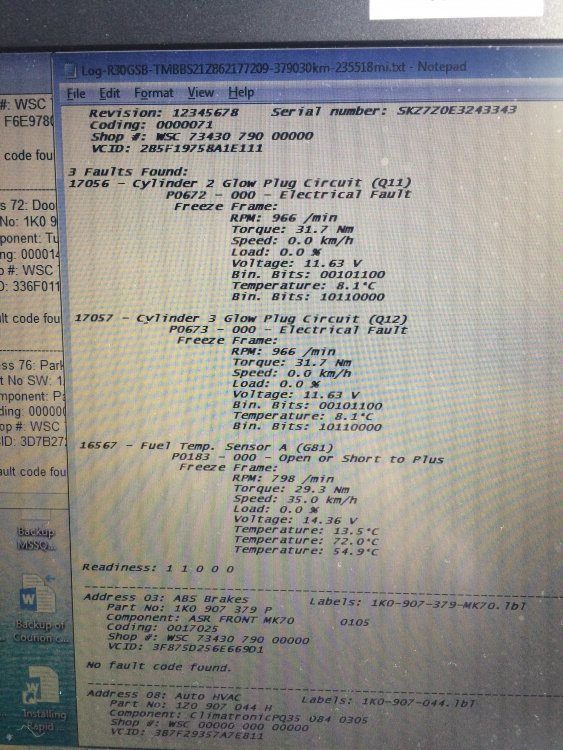

VCDS scan shown. Cleared faults and not returned on a local trip.
A google shows Fuel temp sensor near the engine block close to the dip stick close to the oil filter housing. I wonder if the dealer disturbed something there?

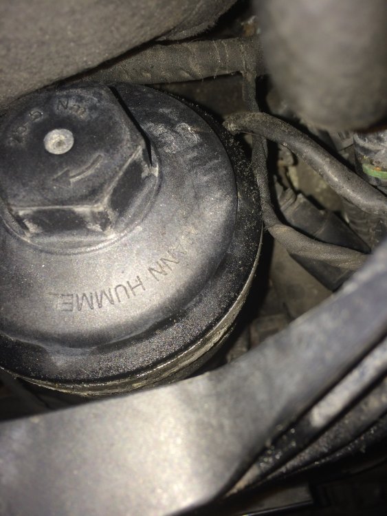

Opened the bonnet and found this (as picture)
I believe the sensor cable has been trapped in the filter housing during the service on Friday. I was going to leave it for tomorrow then bro turned up again to borrow it. I went to find the earlier cleared EML had come back too. Got the filter wrench out and tried to loosen it not realised the wire/loom was being dragged around. Held the cable and loosened more and wire is now free. Tightened the housing again and cleared the error with VCDS. Car gone for the night. Let’s see if there is any permanent damage. Maybe require a loom replacement if it persists.
The loom could be repaired very easily, if it’s damaged I would just solder in a  New piece and heatshrink up.

Car collected loom assumed to be repaired and yellow tape over the loom cover too. Invoice provided with zero charge. I was told loom repaired and the sensor was fully operational.
