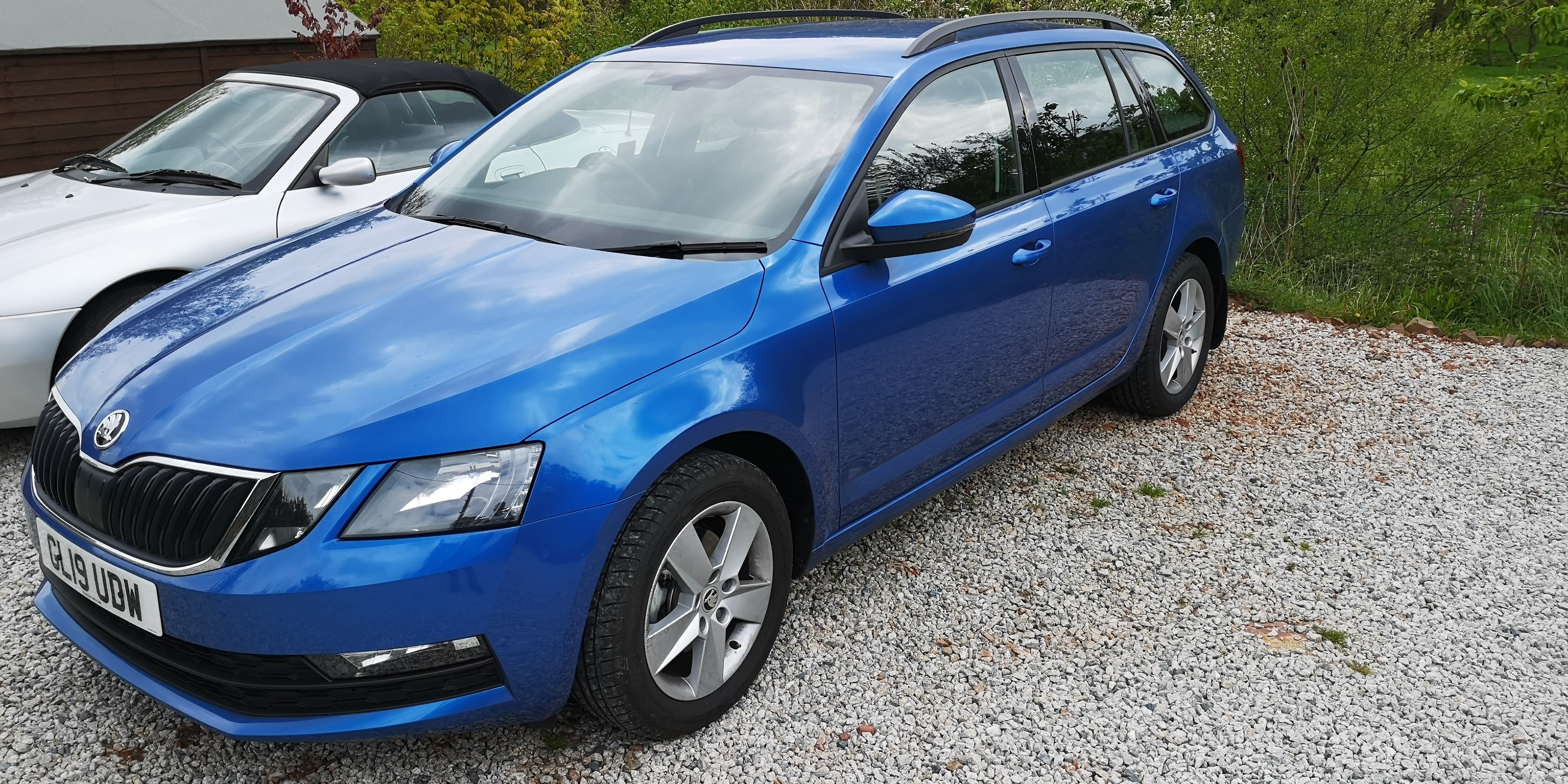

I've got a basic Occy estate so it's not too bad. It's a DSG so that's a bonus.

Can't you use the MG TF next to it instead!?
Ha, that's the weekend car! It's in need of a new exhaust before it goes out too far from the house.
