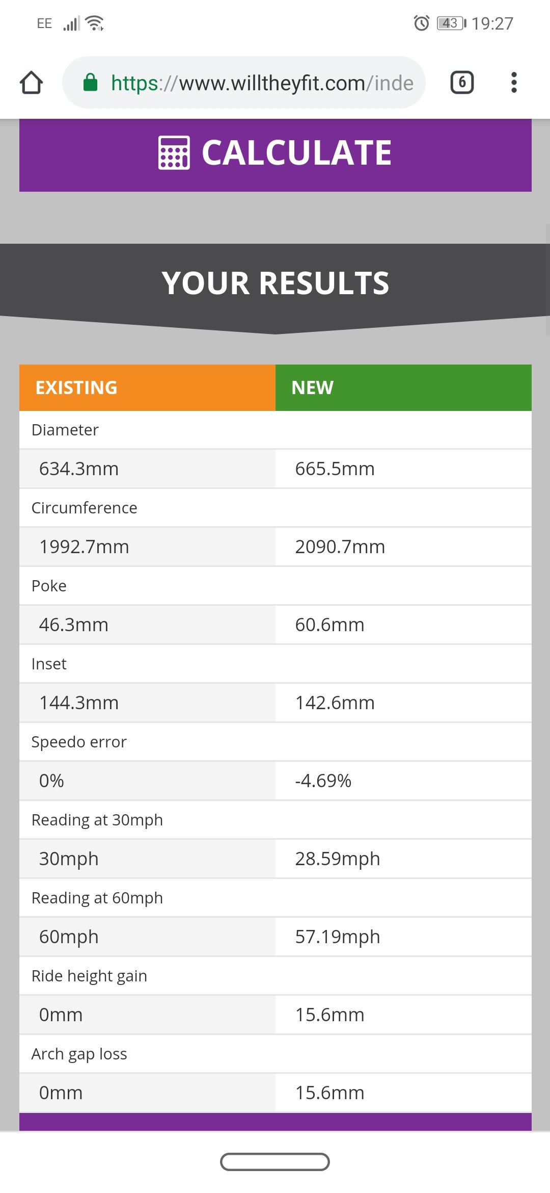

This was what it said on willtheyfit.com
So the speed reading is low, so for a given reading you will be going faster than before?  But 1.4 MPH at 30 and 2.8 at 60 will probably mean your speedo is closer yo correct.
I read it as the Speedo is showing 30mph but the car is actually doing 28.59mph which means it's going slower right ?
It is saying that when you are doing an actual 30 mph, your speedo will only displaying 28.59 mph with the new tyres. That is why the chart says the new tyres will result in a -4.69% lower speedo reading.
That's why @Gdcobra was warning you about the speed cameras. You'll think you are safe doing 30 mph on your speedo, but you will be over that.

Actually that’s not quite how I read it,
To me it is saying “When you are moving at a speed that the standard tyres are indicating as 30, with the larger tyres the indication will be 28 (in round figures).
this is not actually as bad as it seems as when you have an indicated speed of 30 on the standard tyres your true speed will probably only be 28 or so.
VAG seem to use a speedometer offset of 5 % i.e. the speedometer shows a reading that is 5 % higher than your actual speed. So at an actual speed of 30 mph, the speedometer will show 31.5 mph (30 x 1.05). This offset is not applied to the odometer however, so that will read true if the tyre size is correct.
The OP's example now applies an additional offset of -4.69 % to the 31.5 mph which results in a readout of  30.02 mph (31.5 x 0.9531) at an actual 30 mph. BUT, now the odometer is under-reading by 4.69 % so after an actual 10000 miles, the odometer will have clocked up 9531 miles using this tyre.
There's a complicating factor that willtheyfit don't account for either in that the rolling radius of the tyre as it sits under the car is smaller than its inflated radius when unloaded. This page has a tyre size calculator that accounts for this: https://www.carbibles.com/calculators/
The instrument cluster computes the speed by counting the number of wheel revolutions per minute and multiplying that by the circumference to get the speed (there's a calibration programmed into the instrument cluster for this). This is why a change in the tyre circumference will cause calibration issues: the actual circumference is different to the built-in calibration. On older models, it used to be possible to fine-tune the calibration in the cluster but that's not possible on the Superb 2. There are two built-in calibrations, one for the standard sizes, and a second that from what I've been able to tell matches to 235/45/R18: this is a coding option in the instrument cluster that can be changed using VCDS. If you're struggling with tyre profile issues on the new wheels, this might be an option.
Using the CarBibles calculator to compare 235/45/R18 to 235/35/R20 gives an error of -0.57 % which is close enough for the real world.

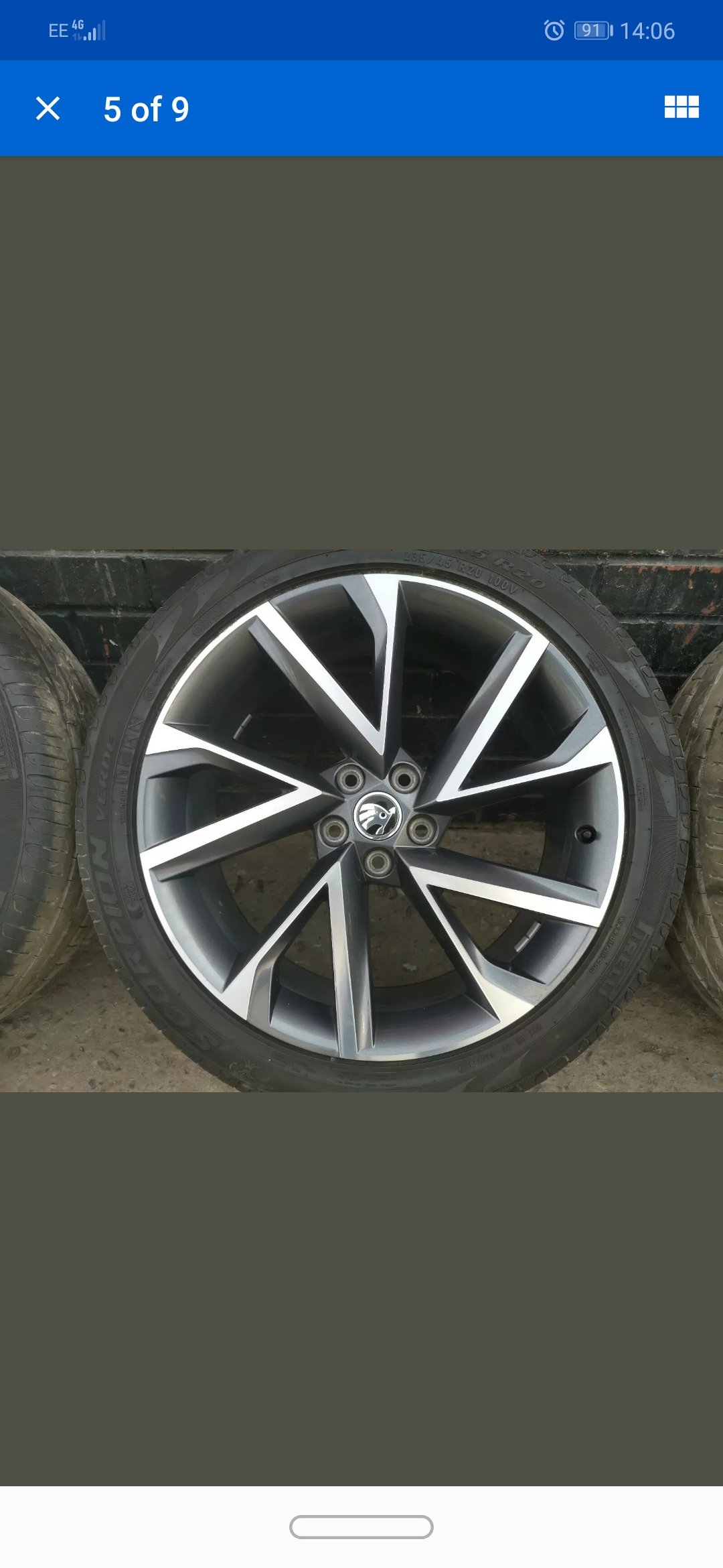

Do you have any pictures of the wheels as I'd be intrested to see them. I tried 20's on mine with no tyres and I think the max size you could go would be 235/30/20. Mine is a pre FL but I don't think that would make any difference?
Edited by Big Lee
32 minutes ago, Big Lee said:
Do you have any pictures of the wheels as I'd be intrested to see them. I tried 20's qon mine with no tyres and I think the max size you could go would be 235/30/20. Mine is a pre FL but I don't think that would make any difference?

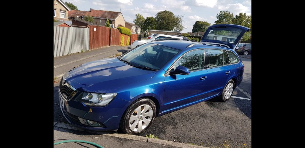

They are these wheels I have 19" on it at the moment and there's still quite a bit of space as you can see
I'm guessing you are on standard ride height? I'm on Bilstein coilovers and dropped by about 50mm. I forgot and that's why i said the tyre size I did 🤦‍♂️
I am at the moment but I have got 30mm ebach springs to go on depending on what tyres I can get away with
