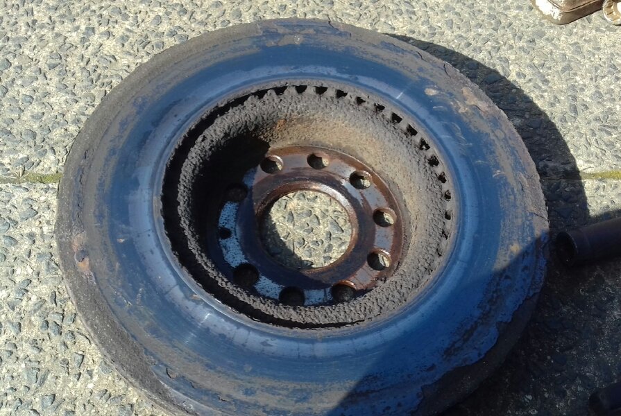

So, i had a bit of brake wobble
Took the wheel off and found...
It was a fairly new disc, the front side looked perfect.
Edited by Stigggeh
Eehhhh how long had it been wobbling? That looks horrendous!
Jesus, how long was that on the car ? I take it the pad is all kinds of ****ed up too
The wobble came on quite quickly over a few weeks.  😑
Tbh I thought it was a warped disc.  I had jacked the car up previously and checked for anything loose such as bushes/bearing.   It was difficult to see  the back of the discs because of the dust cover.   I'm assuming i inspected the other (passenger) side more because i totally missed this.
Thinking it was a warped disc I thought i'd change them look when I got chance,  so it was on about a month with the wobble (woops).
It must have been a manufacturing fault because the passenger side disc was in decent condition as was the wheel side on that one.    Surprisingly the pads were in good shape too.
It's braking nice again, got new bosch discs and pads.   I was impressed with the difference in quality over cheaper versions i've fitted to other cars previously.    They appear to have a nice anti corrosion coating too which i've not seen before.
