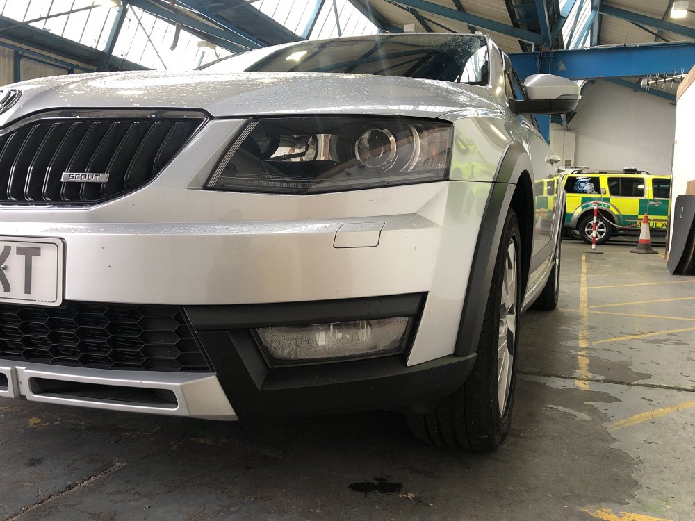

Has anyone removed front fog lights from a 65 plate Octavia Scout?  Do you have to remove the whole bumper or is there an easy way ???

The top piece of black horizontal plastic trim pulls out (with a bit of force) and reveals a couple of screws which then allows the whole lamp to be removed.  As easy as that.
