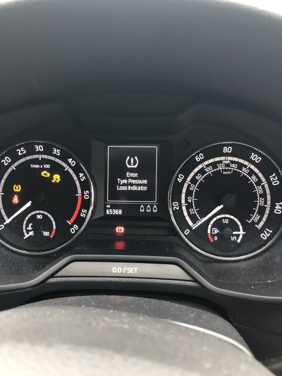

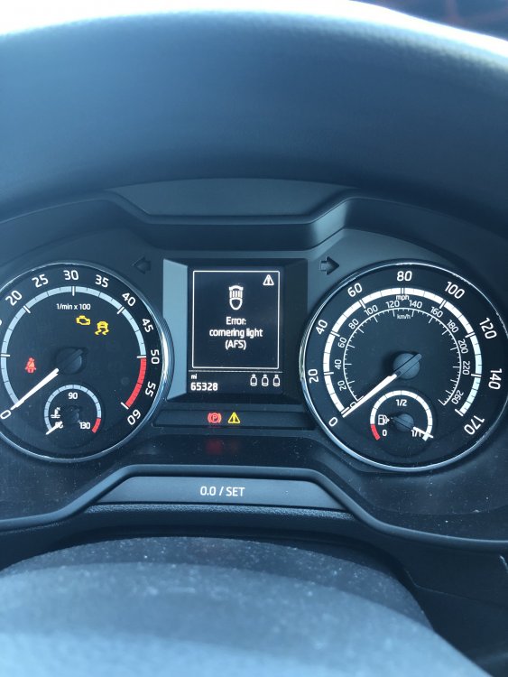

Started having errros coming up in my dashboard when I turn ignition on and the engine won’t start ( see pics)
takes several attempts to get it running and once is on, no problems. It is very random, sometimes several times a day, sometimes several days without doing it.  Took it to skoda twice, once they said software update and should be Ok, once they said they reset the central unit and should be ok. Still have a problem and don’t know where to go next. Don’t fancy replacing central unit as can go into thousands... Skoda at this point have no idea what is going on and where the fault is.
Any recommendations on what to do next, would be much appreciated. Or other garages to go to...

Exactly the same warning lights and it's the ABS sensor in the wheel hub. I have traction/ABS/bendy lights/parking control  tyre pressure system and stop start faults.
Mine is at Skoda being done under warranty but without a warranty the part is only about £40 and easy to do. I removed both rear sensors and gave them a clean just in case that would solve it but it didn't.
the part for mine is WHT 003 864 A (with self park) https://www.onlinecarparts.co.uk/ate-7618461.html
however mine does start and drive ok
