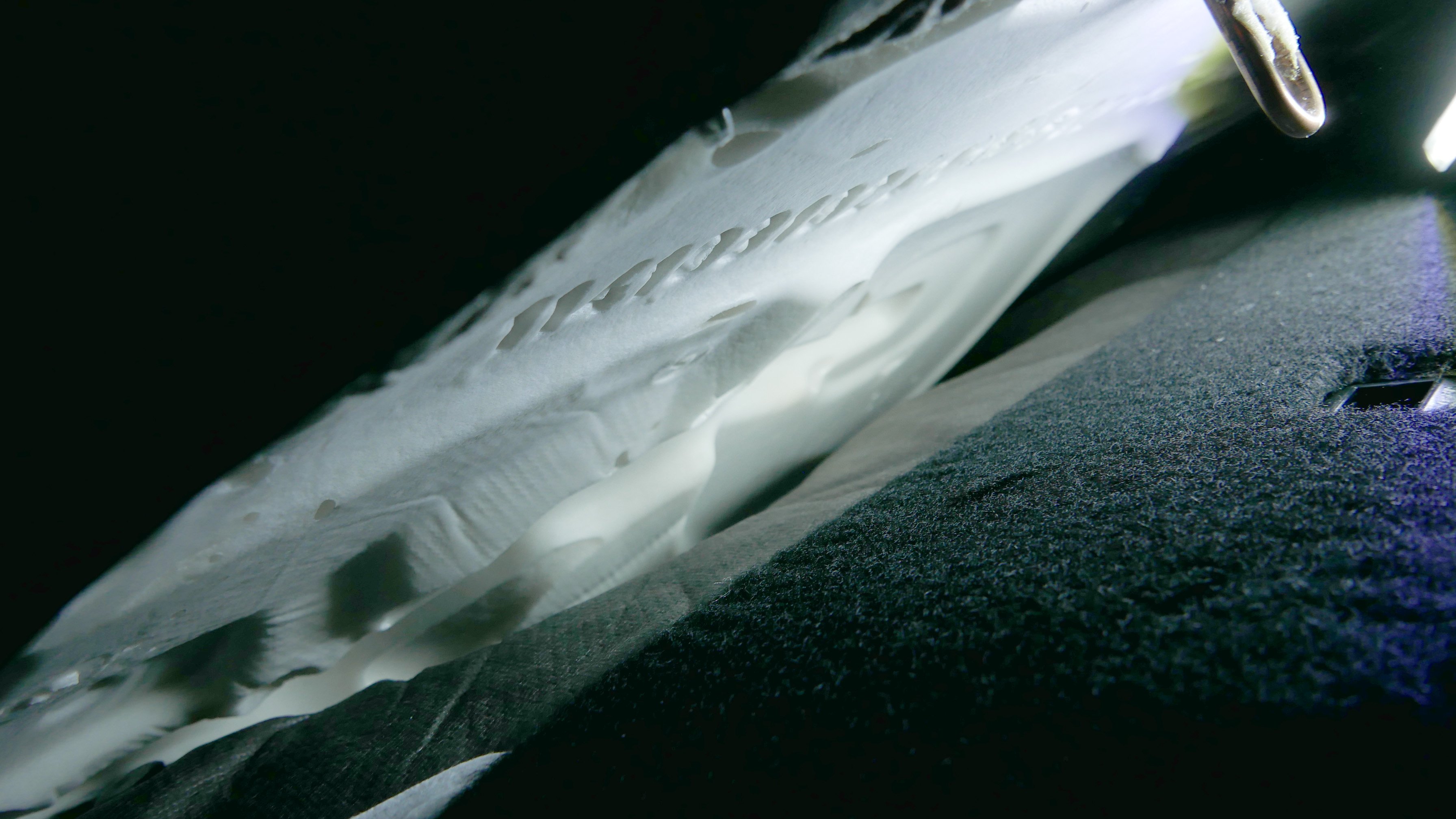

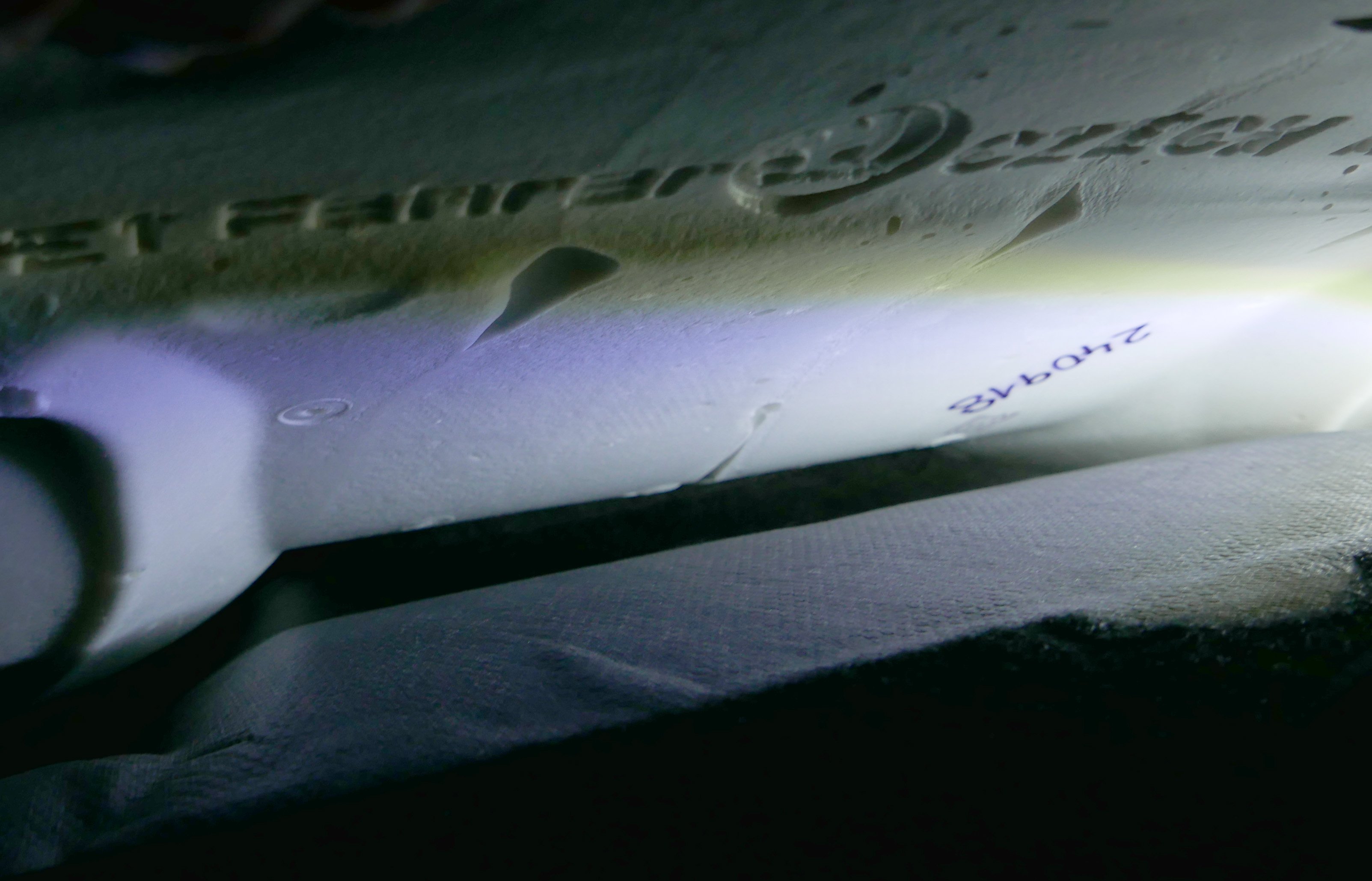

I just popped my rear bench front and had a look underneath. There seems to be some sort of material padding already covering the metal, was that the case with you?
Edited by digifish
No, mine was bare metal. Do you have a photo?
Fantastic post 🙂 When you available to do mine ? 😉
Little difficult to photograph ... in this pic I raised the front of the seat and photographed in the gap. The meterial is about 5 mm thick. The top is a smooth perforated material, underneath is 2-3 mm of flocking/foam
Edited by digifish
Interesting, mine (Dec 2015) didn't have that. What year is yours? Wonder if they added more soundproofing elsewhere too.

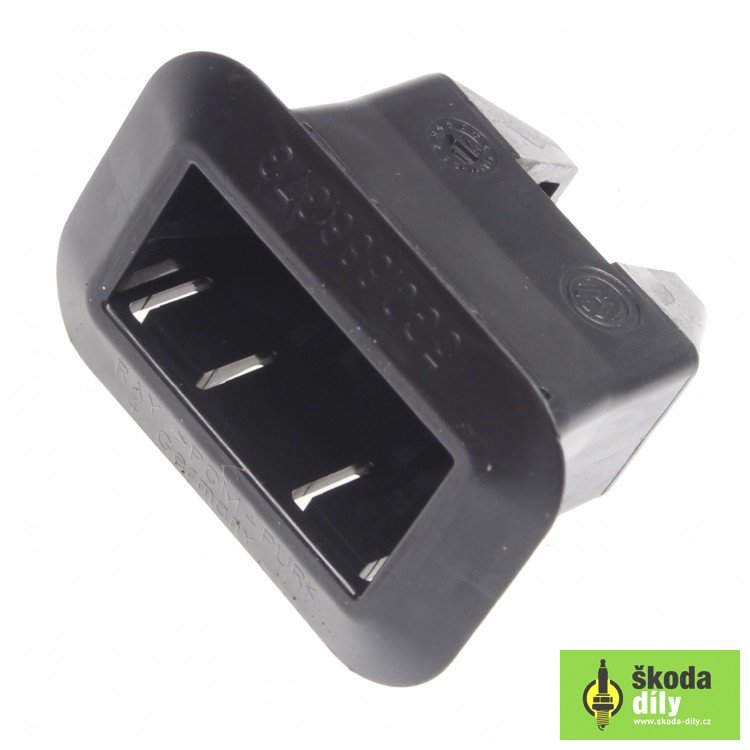

November 2018 build. BTW I bought a set of new seat grommets. since removing my rear bench left it a little loose, still locked but now would pull up a few mm.  About $10 USD for 2. Part# 5G0 886 373
I will completely remove the rear seat when I get them and see what's what ;)
Edited by digifish
As promised, here is all you ever wanted to know about VAG - Seat grommets and why you (may) need to replace them. Part Number: 5G0886373
These cost about $5 USD each. After seeing the genuine item, if you can find a cheaper replacement from eBay/AliExpress etc, you should be fine. There are no real risks apart from the clip breaking which will only mean the front of the seat squab would move up and down a little. If you live close to an Audi, VW or Skoda dealer it will be similar cost to pick up some genuine clips compared to 3rd party alternatives (delivered).
