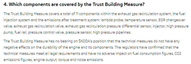

Skoda's Trust Building Measure includes 11 emissions related components, but excludes the DPF...
https://www.skoda.co.uk/owners/ea198-trust-building-measure
22 minutes ago, silver1011 said:
Failing sensors should result in a fault code and /or EML light which then prevents the DPF from regenerating.

My EGV regulator became clogged which brought the engine management light on. This was just a few days over the two year "warranty". Due to illness I could not get it looked at for another six months but had told my dealer. Skoda rejected the dealers claim but Skoda accepted my claim as a good will offer. Skoda therefore paid to have it cleaned out including the stub connection.
Strange that Skoda rejected the dealers claim but accepted mine with support from the dealer!:D
Saved me just short of £280.

Do they warranty the cleaned egr then?
Skoda will just replace it - less labour ti put in a new part and there's less uncertainty about it down the road.
