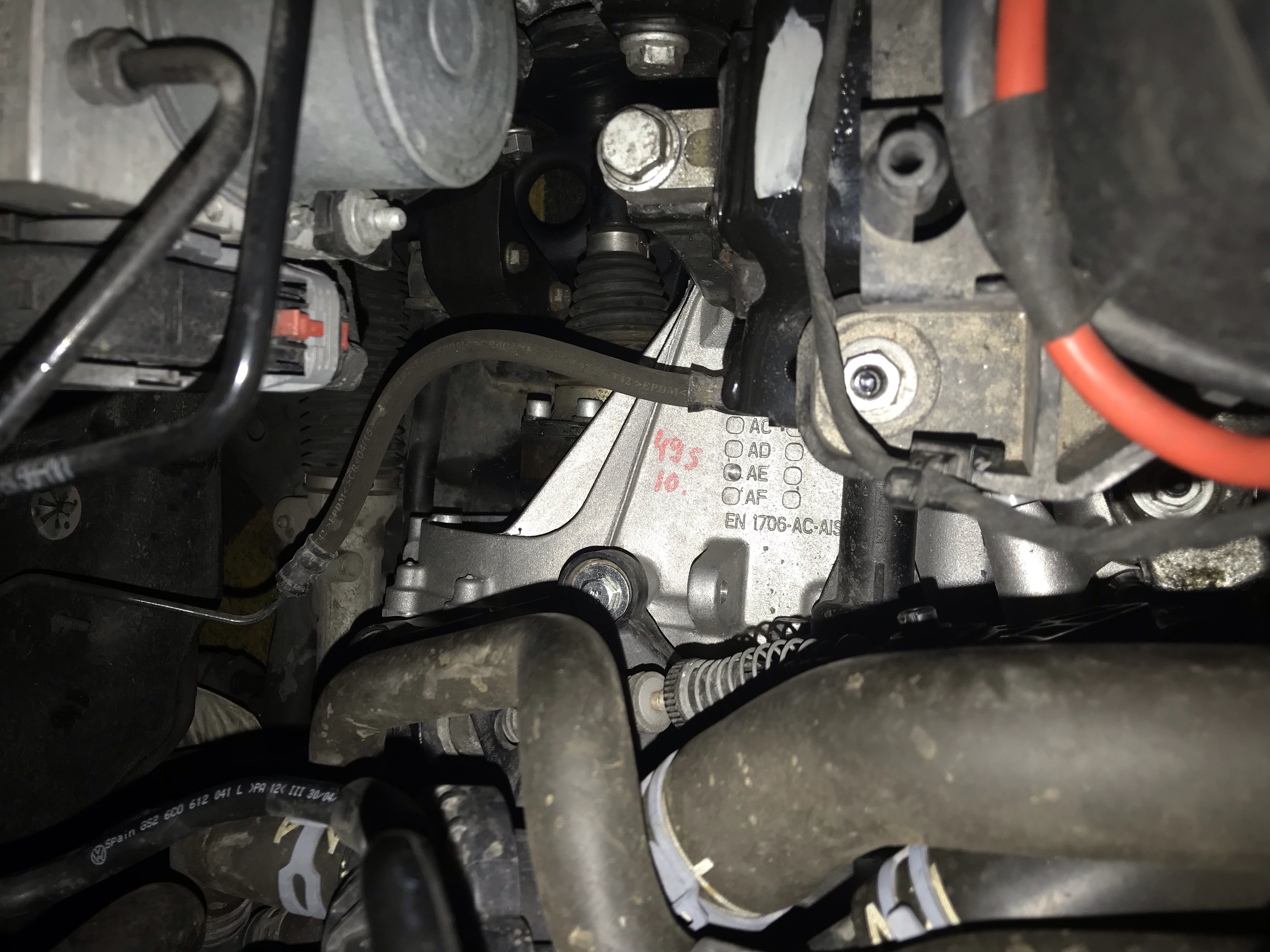

Quick update on my cars gearbox/clutch problem.
The clutch was almost fully worn out. I suspect that's probably just the drawback of living in sheffield where theres like nowhere that isn't a hill!
The synchro mesh had a manufacturing fault on 5th gear, slowly leaving the oil with more and more tiny bits of metal which eventually destroyed bearings, causing excessive play and vibrations in 3rd but mostly 5th gear.
They replaced both the clutch and put an entire brand new gearbox in! The gear shifts are much more refined and the gearstick feels better too. Looks like the gearbox is of slightly different design, as it's noticably larger than the old one.
Here it is in it's shiny glory;
