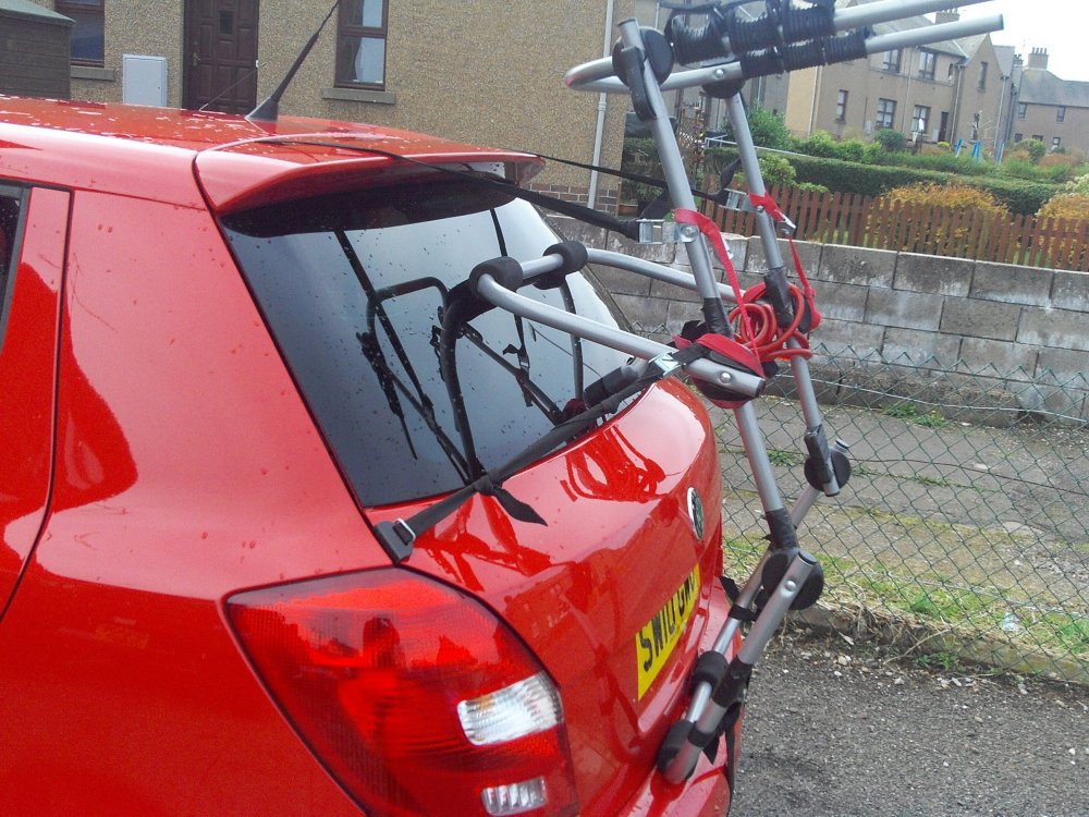

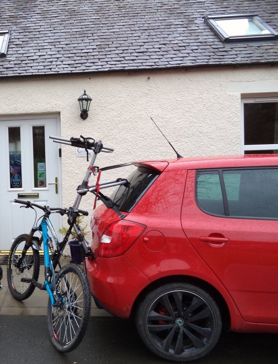

I have used a cheap universal rack to carry bikes with the wheels off & no Light Board used, or kids bikes / BMX size.
Not pretty and bikes need well tied / fastened on up high.
Bottom of rack set to not be pressing too hard on the bumper , rear glass and not pulling too hard on the spoiler.
(rear wiper still needed removing.  or tape the switch so you do not put it on, but then some cars wipe the rear as you reverse with front wiper on..)
