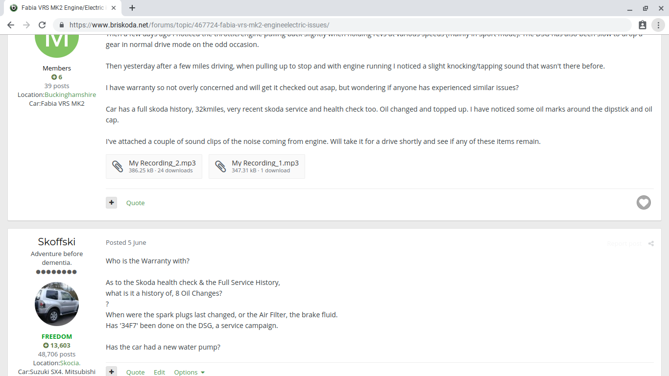

So likely the Water Pump / Supercharger Magnetic Clutch if never replaced.
Something for some reason Main Dealer Techs seem unaware cause the issues you have.
Do you need the threads bumped or can you find them, part numbers etc?
I did ask in my first post.
Reason being it is usually the issue, especially if a Dealership do a health check.
Then they want an hour or 2 to diagnose the issue, even if you tell them what is wrong...
