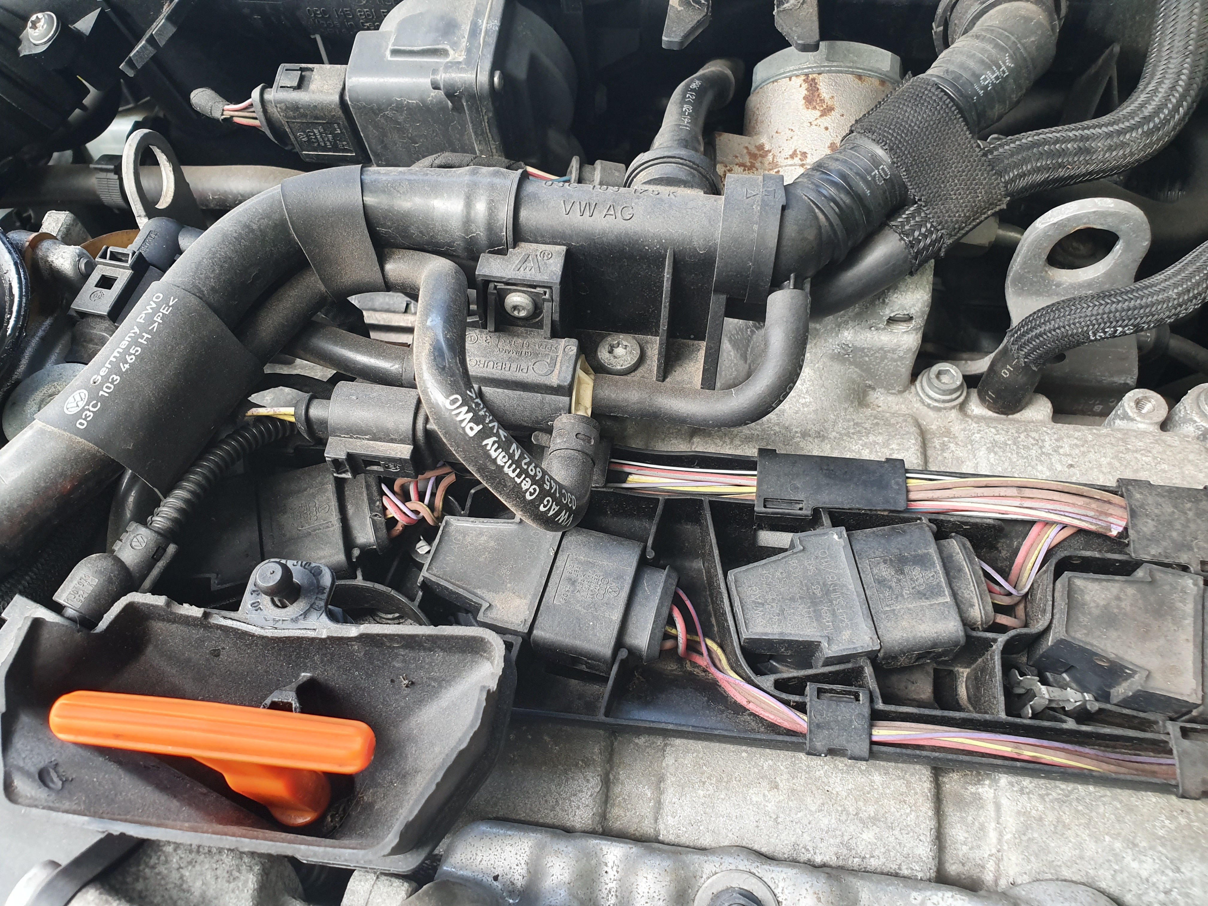

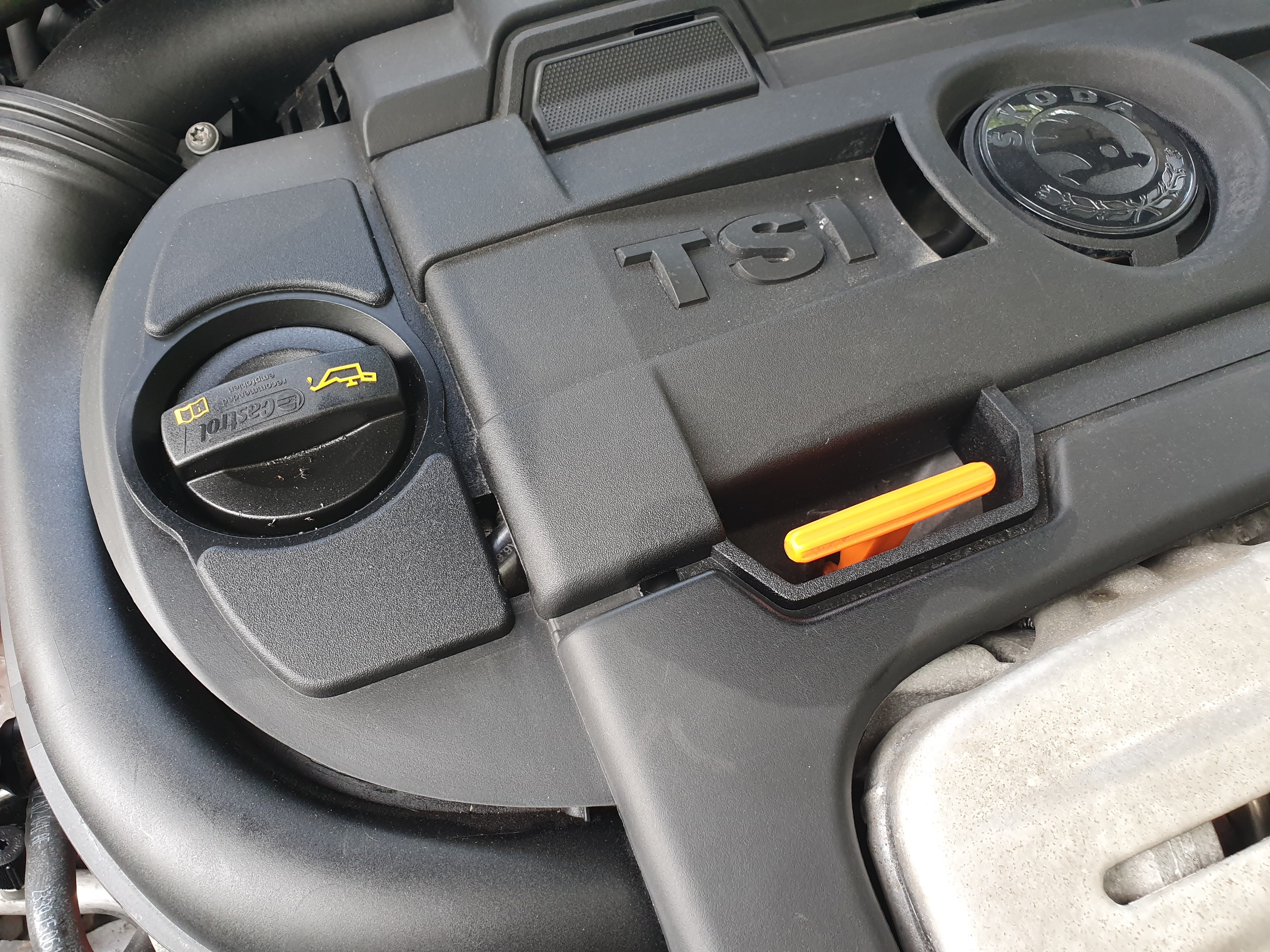

Are these oil marks normal? I'll check levels, oil was fine and clear/clean after recent service at main dealer.
Engines not sounding great, but videos tend to do that.  Yours still sounds a bit sick though.

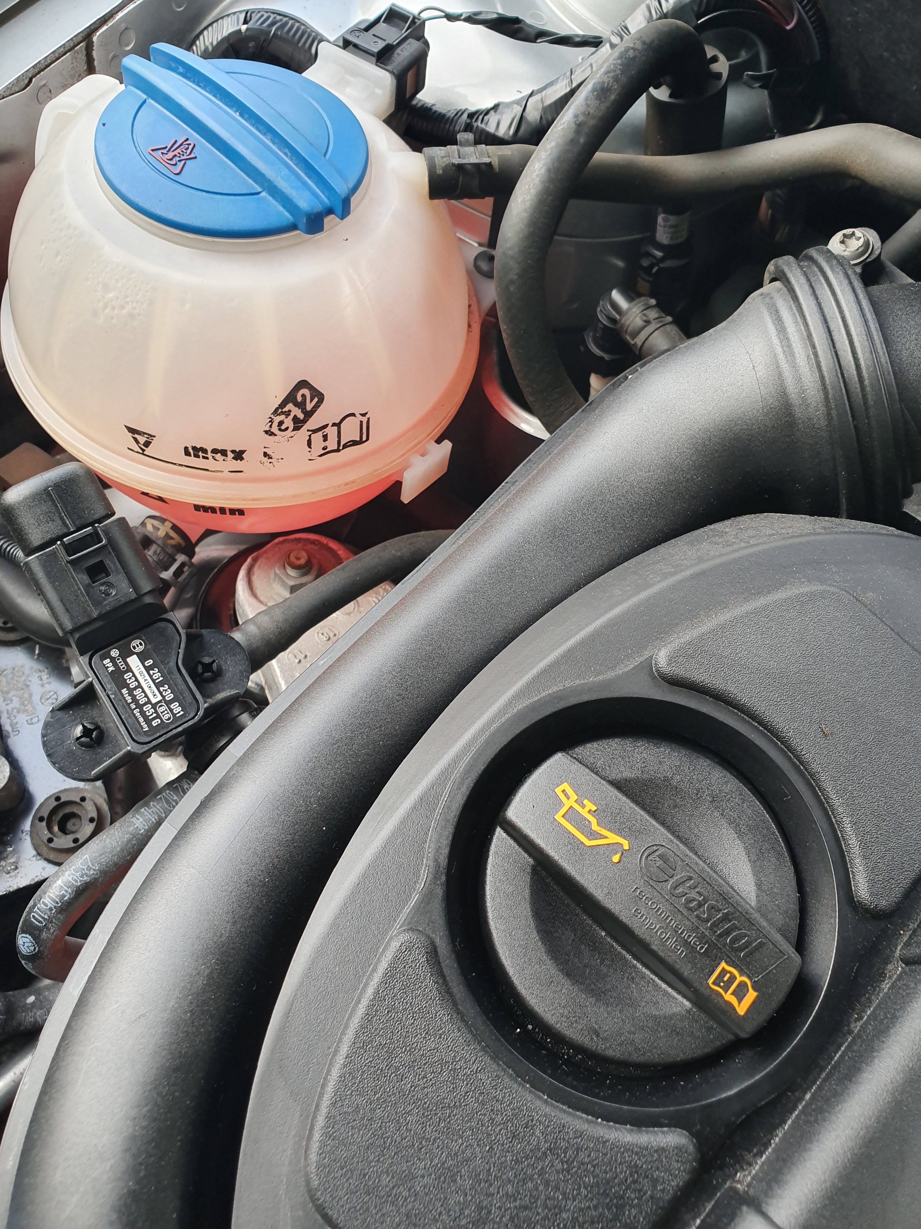

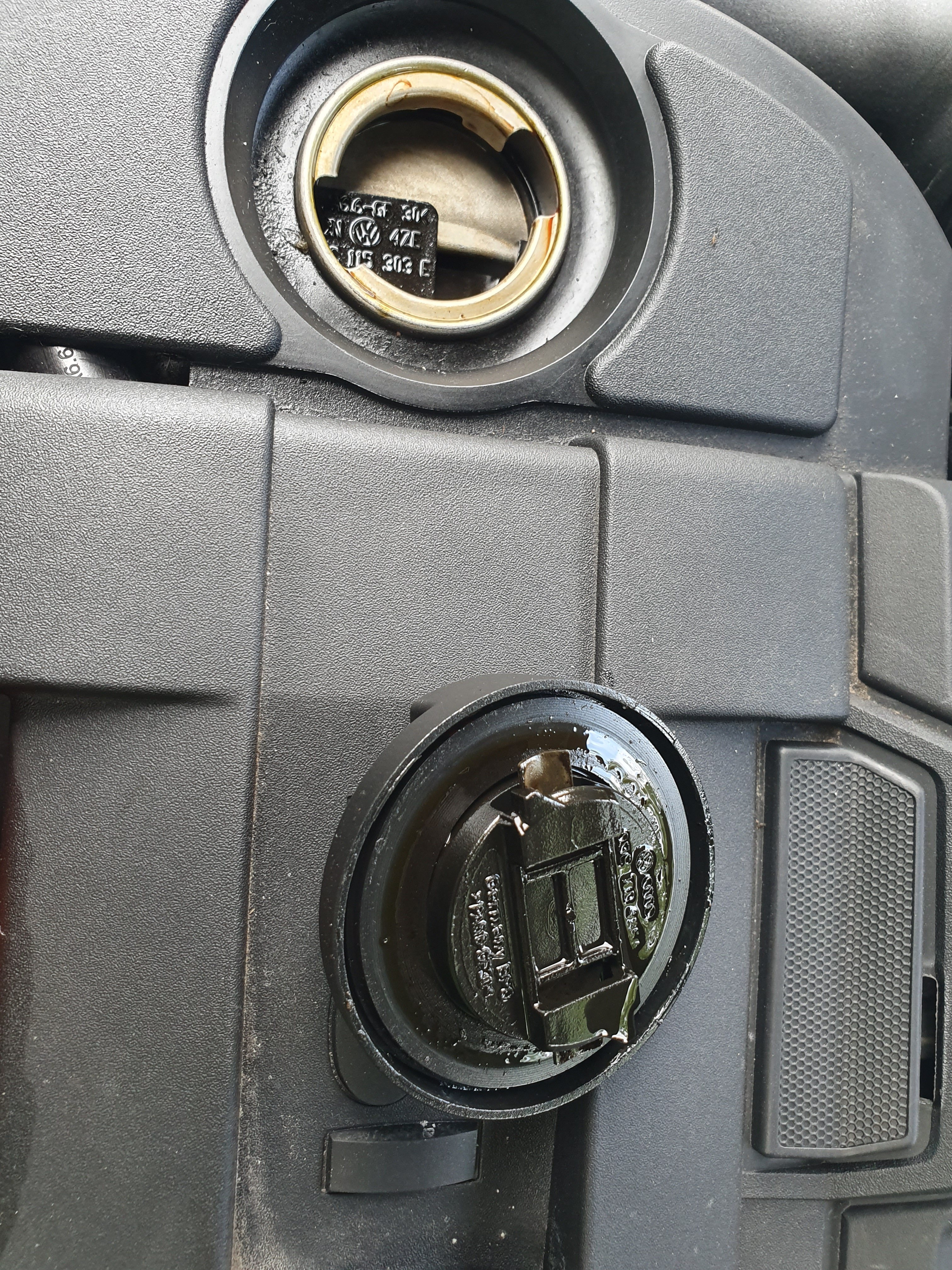

Someone has been careless topping up the oil.
Maybe never put the cap on properly, not unusual as Tom Jones had a hit with.
Take the cap off and see if the rubber around the filler has oil in it.
Put the cap on the other way so the oil can faces you.   It makes me nervous seeing one that way.....
I would take the top cover off and see if the rubber bung is missing the holds it down.
Cover pulls up and slips off.

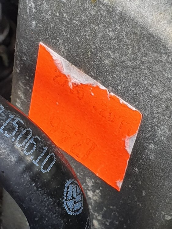

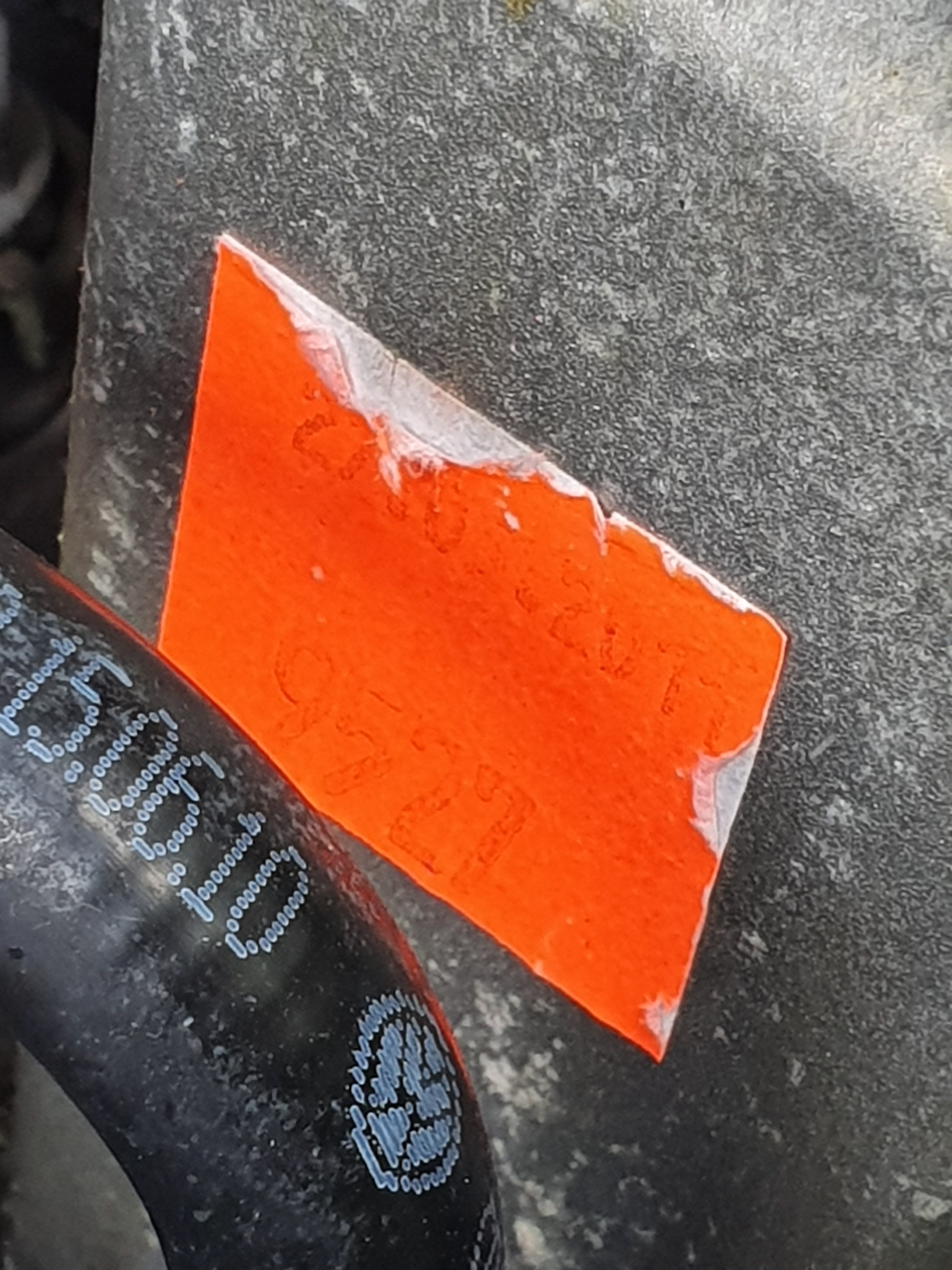

What date is on that little orange sticker?
*****Watch the coolant does not drop any, possible sign it is new water pump time.******

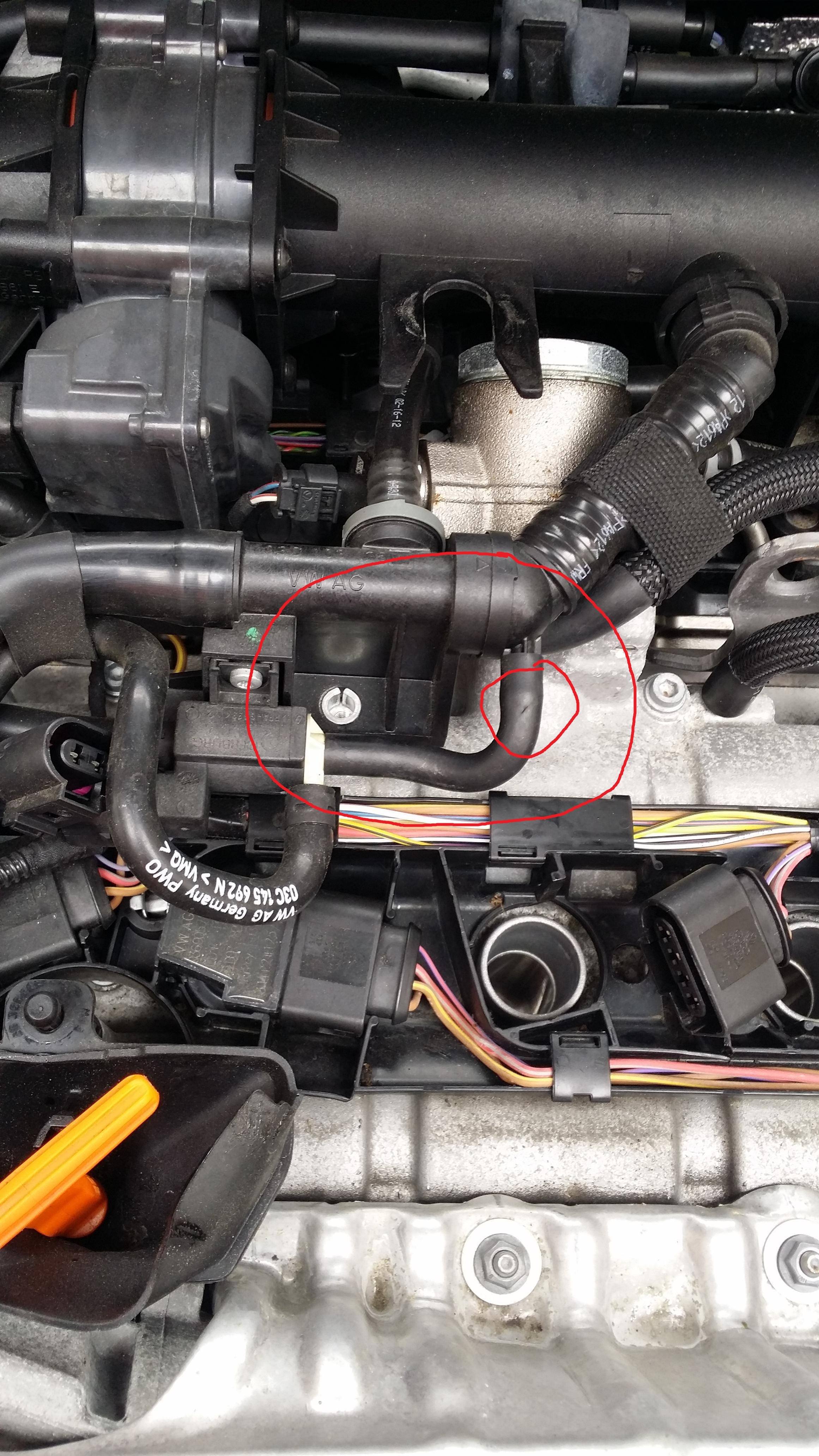

See the rubber  at the dip stick.  there is similar below the oil filler that catches oil when people spill filling up.
& top where the cover slips into and the rubber gets lost or that bit gets broken.
Edited by Skoffski

Changed the cap round for you 😁
Date on orange sticker is 27,0X,2011

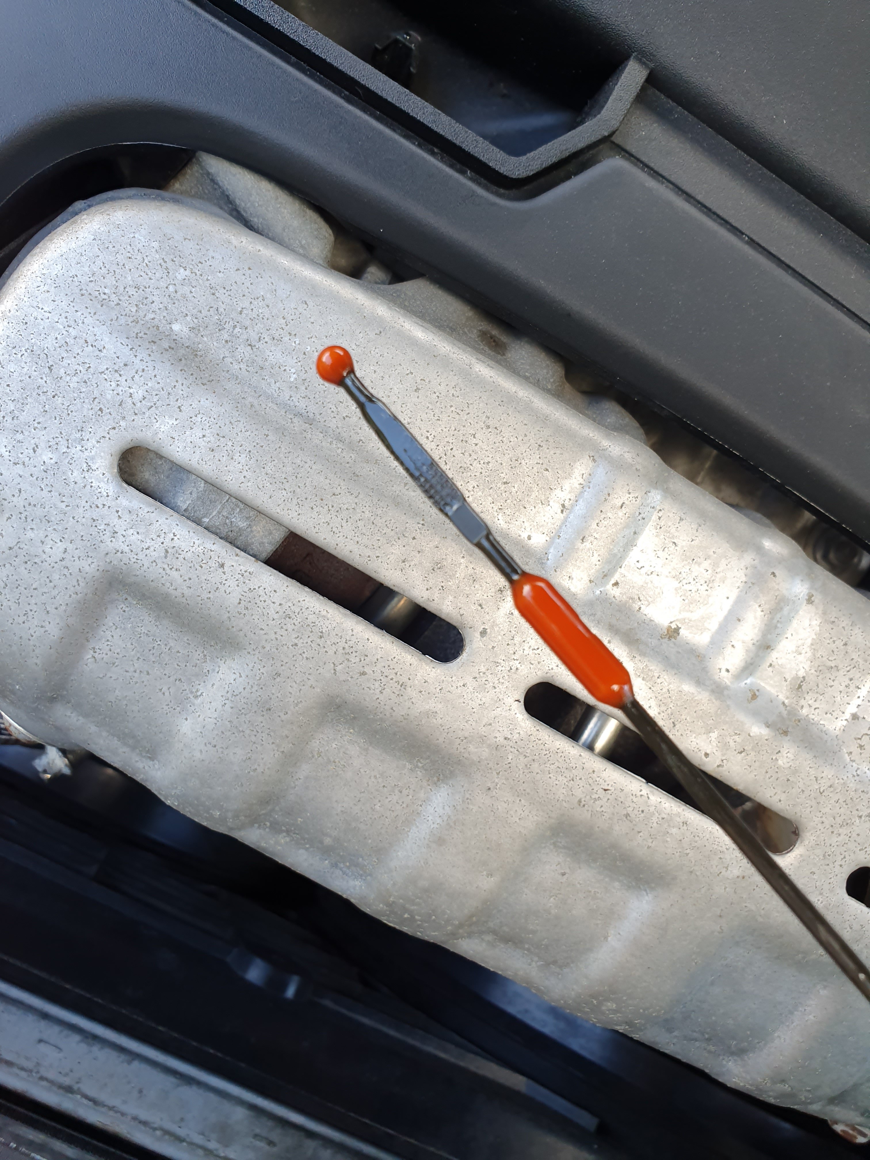

Oil level was fine on dipstick when checked now. Car is warm and be stopped for around 30 mins. Oil was serviced and changed 22nd May at main dealer.

I would not check your oil warm and after 30 minutes, even if doing the same each time.
Check tomorrow when stone cold.
Then at some point do as the owners manual would say if translated properly.
Check at normal operating temperature.
So that will be when the oil has got above 80*oC towards 90*oC,  then stopped for a 'few minutes' so that is 3, 4 or 4 minutes.
Then you know the oil level before the engine has been driven and when you get someplace, like stopped at a filling station.
Interesting, went for a drive and just got back. Oil temp around 80-90 degrees. This is the level...I will wait a few more minutes for oil to drain back to the sump and test again.
I've done around 5-600 miles in the car since I bought it and it's had "two" oil services in that time.
Edited by MRA13
IMO & IME a good quantity of oil will have the level showing on the flat above the cross hatch with a stone cold engine,
and at operating temp at the top of the cross hatch.
So is you engine drinking oil?
I want the oil to be here after an oil change and taking it for at least a 5 mile drive and checking, if below i would be topping it up to here.
Cold after a good few hours and it should be on the flat above.
Edited by Skoffski
I checked just now and the level is creeping up on the dipstick. Yesterday you could see it was positioned at "full" after driving.
