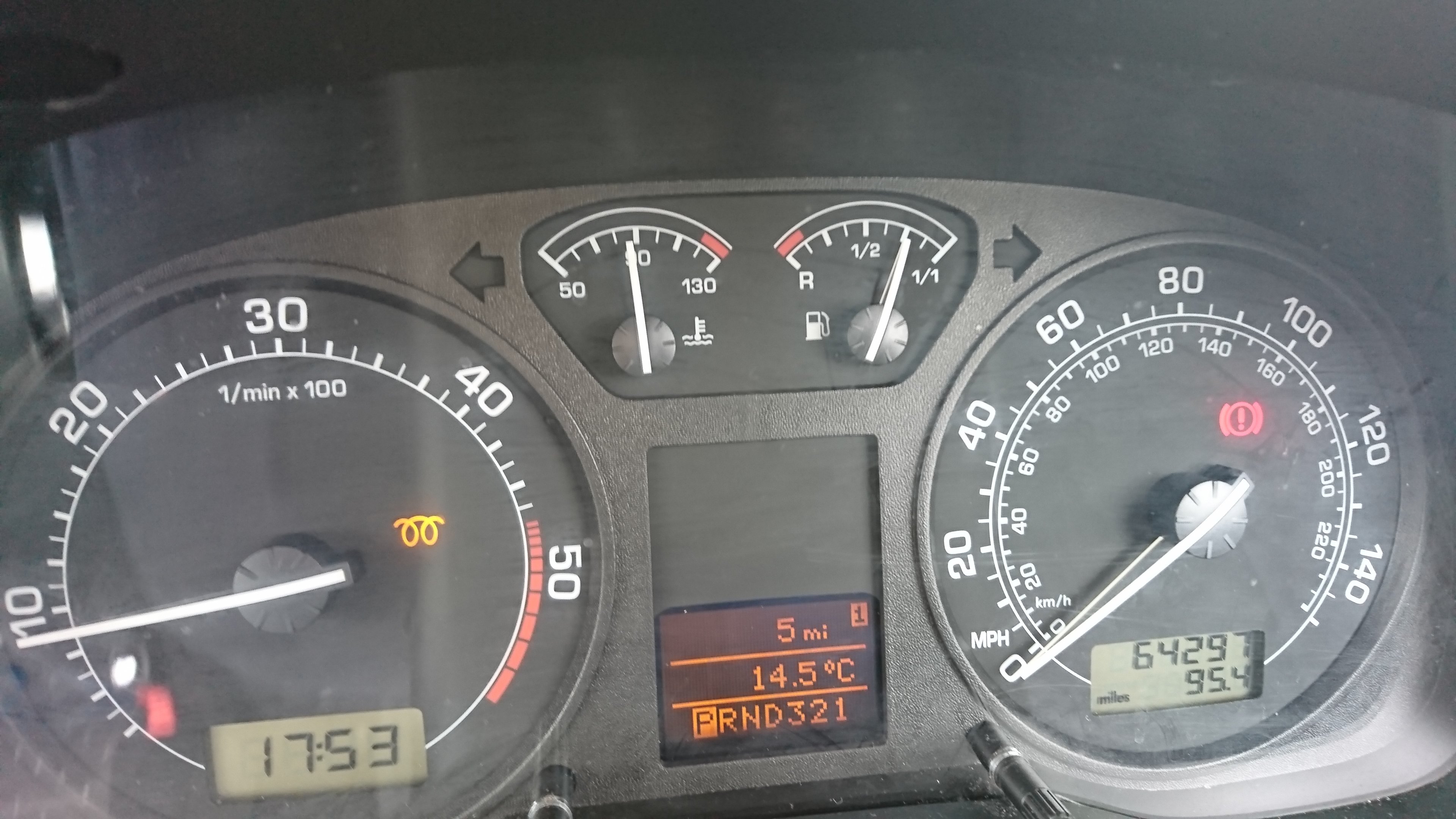

I have bought a used skoda octavia diesel 2004 with 64000k milage, it was absolutely fine for two weeks then had problem with gear box lock. The breaks did not seem to unlock gear box so I could move it at all unless car was turned off. This problem fixed itself the next day.
Today a few days after the over heat alarm is off although the temp gauge is steady at 90 (when car is cold it starts at 50 and sticks to 90 through out the trip). The gear problem happened again at the same time as the overheat sign. The car runs fine but not sure where the fault is.

If you mean by overheat sign the diesel glow plug symbol shown in your photo, this is also used to indicate a fault, not just glow plugs on.
Use an ODB2 reader in the diagnostics port to read the fault list and report the codes here and I am sure we can help.

Thank you pikpilot, I did a quick Google and didn't realize it also can be glow plug or other different faults. I have tested the water pump which was working fine (I unplugged the return hose from the reservoir and the flow was good).
Now I have an obd reader already which I did use when I was car hunting and also used now but it never picked up any codes.
The car in it self is performing fine, there are no misfires or new sounds. The only thing different is the gearbox shift lock not releasing when I press on the breaks. I have tried disco necting and reconnecting the battery..didnt work.
Hoping it's not serious, do I need to buy a better obd?
