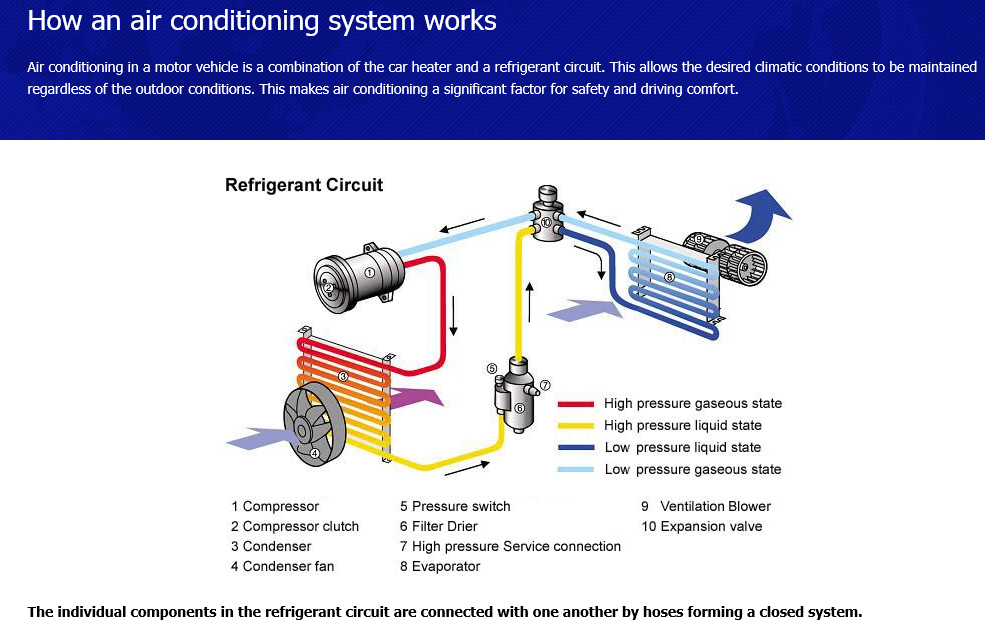

Does this help at all?
http://www.air-4.com/knowladge1.html
Pulling a vacuum downstream of the expansion valve (10) would pull a vacuum upstream of it too, I'd expect.

Thanks Wino, item 7 the high pressure service valve is shown in the low pressure circuit!
I see it in the 'high pressure liquid state' part of the circuit. Are you looking via a phone? The diagram is in black & white when viewed on my phone, but colour and much easier to understand on PC/laptop/tablet.
My eyes would not be able to make out any of it on a phone!!!!
I can see my problem, the diagram uses the same grey colour for the high pressure liquid state as the low pressure gaseous state.

You mean the yellow and the light blue?  Wish I'd just screenshotted it in the first place. :D
Bizaare, they are both grey when I view the link.
