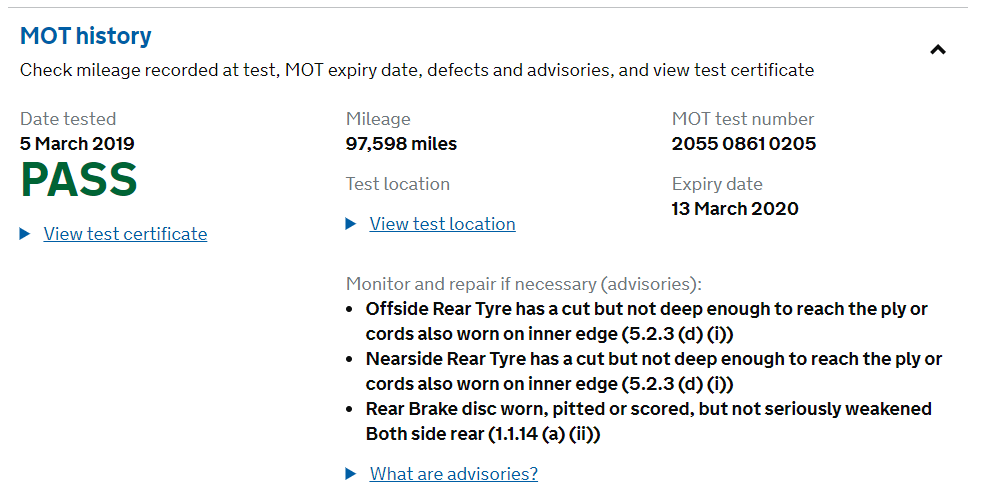

Send us a link to the advert, it'll then be easier for us to give you specific advice on that particular car.

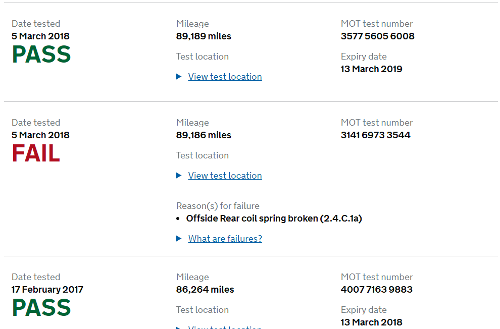

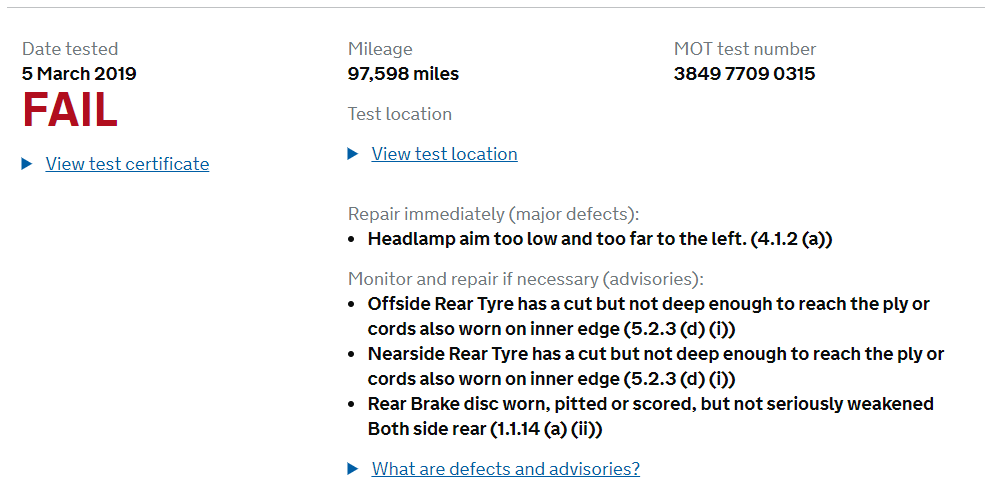

Do you have the registration number and therefore checked out its MOT history?
Nothing overly concerning, it averaged 30,000 miles a year in it's first three years, then only 7,000 miles since...
The "part service history" is a little concerning. I'd want to see evidence of the service history.

You might want to get the rear wheel alignment checked and adjusted due to the tyre notification.
No dealer history of being serviced so could have been sold to a fleet firm and serviced outside the network.
