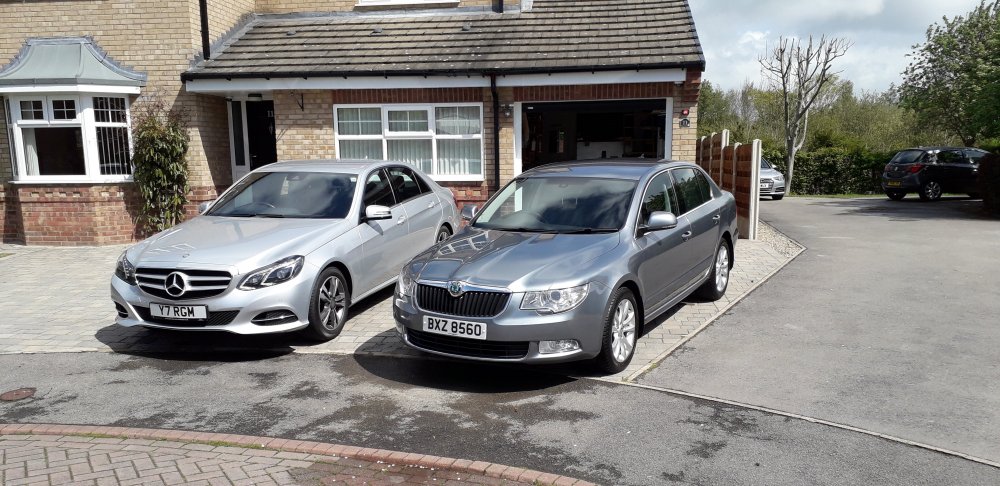

My car is in with a local detailer as I type, for a full correction.
They've had it all day today and it'll be ready end of day tomorrow. That's with two people working on it.
It's a Mercedes-Benz E-Class, but is a similar size to my old Superb Twindoor...

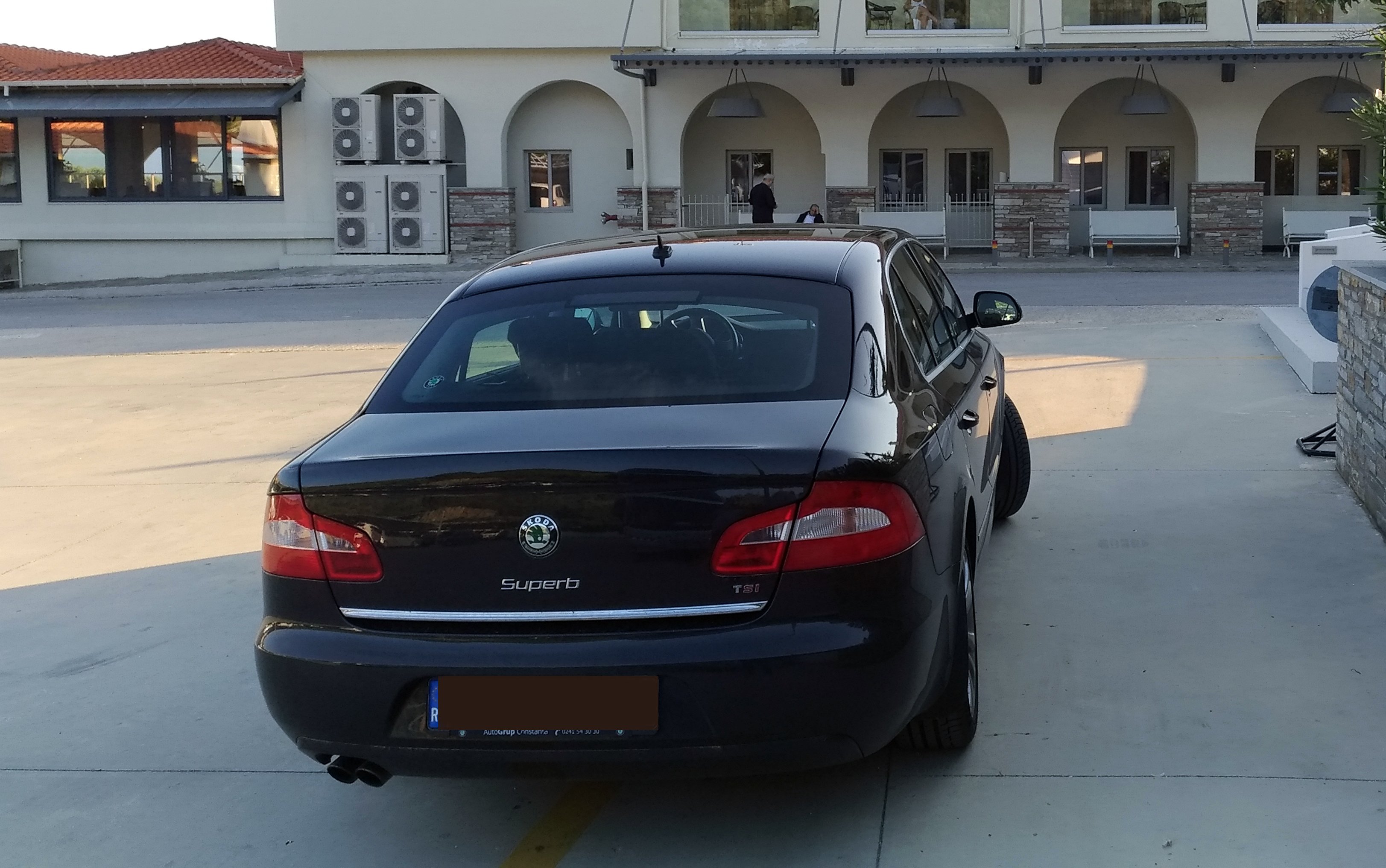

After 9 yrs I polished my Superb for fine scratches and because a very fine gradient of polishing liquid was used whole treatment took 6 hours just to do it right and with great care to details. This fine level of polishing allow to repeat the process for several times without whipping out the paint and protective lacquer coat.
