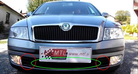

On my 2005 O2  I think it can be done from the inside. Remove both plastic covers in the bumper (which holds the screws for the fog lights). Once removed, you can remove the black plastic part between the fog lights, causing a gap to the condensor. From there, there is pretty much space directly to the latch. With some luck you might be able to release the bonnet.
See picture. First remove both red pieces (snapped on) and then remove the green part exposing the ac condensor and a huge empty space.
don't know tho if thats any different from a 2005 regular O2 to a 2010 VRS.
Also, maybe just removing the plastic grill part? (don't know if you can source that seperately).
Compete bonnet replacement sounds like a PITA, since you have to match paint color as well (and since its 9 years old, I won't be surprised if the colors are slightly off due to sunlight and stuff, even while the color/specs are identical while new)
Good morning. Thank you for taking the time to reply really appreciate it. Both myself, my local mechanic and Skoda main dealer have tried exactly as you suggest. It would seem however that the cable is not the issue but in fact the latch has completely failed. This is of course very strange as I have had no issues with it before and no signs of failure. The good news is that I have finally managed to source a matching bonnet and fingers crossed the colour will not be too far out at least until I have chance to get it sprayed in.

Might be an option as well. Also, if you have another car in to have a peek, makes it a lot easier to compare and see.
Another option: On my O2 I can remove the cover behind the wheel. From there I think its possible to remove the window washer fluid box, giving a lot more space to enter the latch from the side
(On my car this is can be done from the passenger side, but my car is a LHD). Remove the wheel, remove the screws holding the cover, and gain access from there to the engine compartment
Just opened my bonnet to have a schuffti in case it ever happens to me, you can definitely access and remove the 2 bolts on the latch from the opening at the bottom of the bumper after the louvres are removed.
Whether it releases the bonnet lock hoop is another matter, if it doesnt the next thing to do is sacrifice the plastic grille at the front of the bonnet and then remove the chrome surround and Skoda badge, the lock hoop is right behind there, use of a prybar might release it, worse case you would have to cut through it with a hacksaw blade in a padsaw handle but the bonnet would not be damaged.
