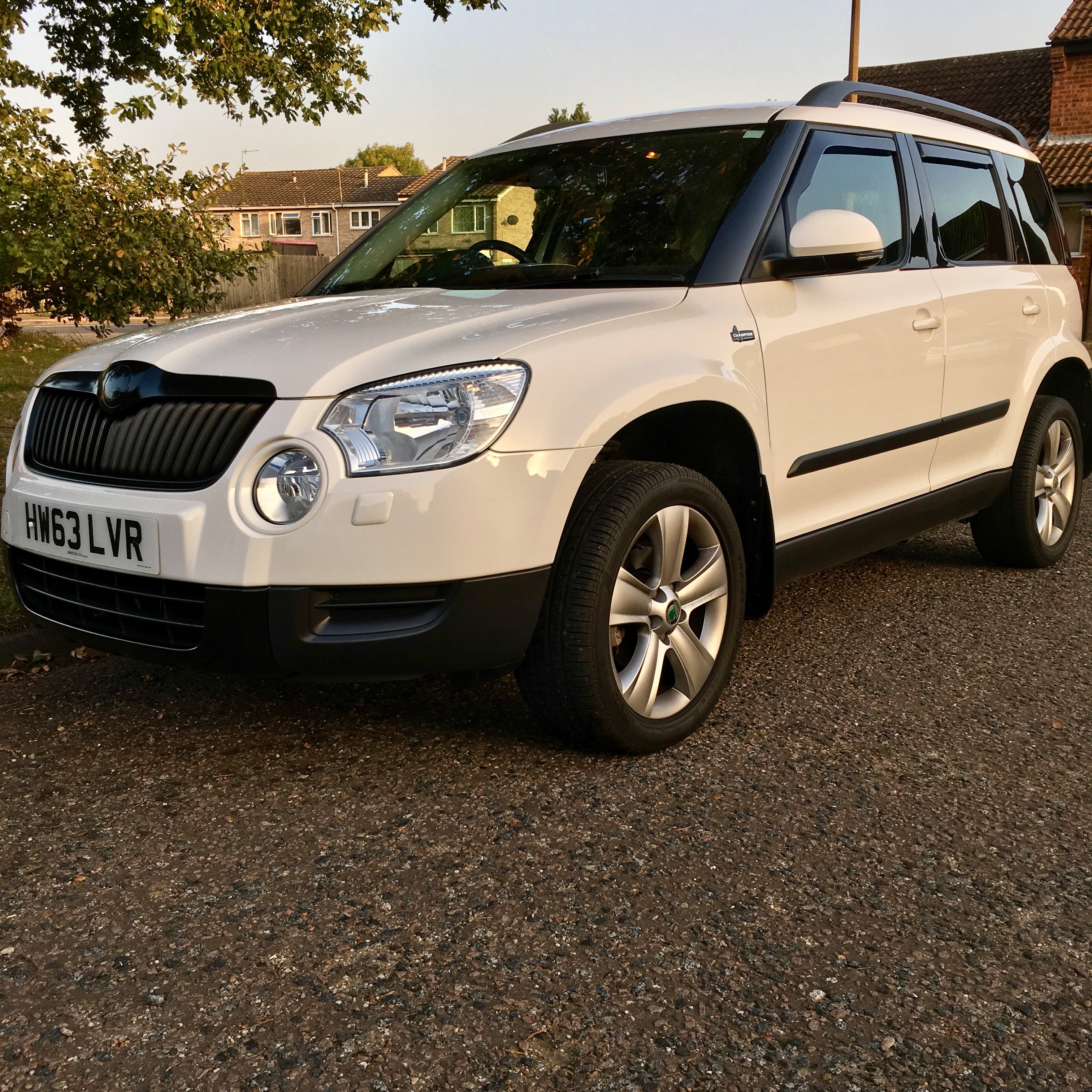

I just masked mine and sprayed the front and the rear ones. Very happy with the results 😊
That is what i am looking to get. Very nice. I will post some pics after its done. Thanks
