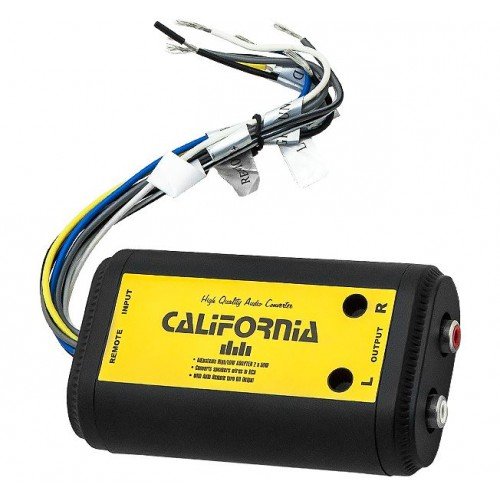

then how do i wire the LOC to the harness? it doesnt give signal to amp. loc have 2 ground, thats bolted to the housing of the HU. has a +12v. thats tapped into multiconnector 2, pin 15. and has a blue, remote out wire. thats supposed to go to the amp?

wwell i got it working by the auto sense on the loc. but it wont turn off, even after half hour. for now i solved it with a switch, but dont feel that comfortable enough. i got a cheaper loc, called California. can that be the problem, that i took +12v for the loc from

or should i try reconnect it to the cdchanger pin 10, as you suggested? sadly i cant try with multimeter, as it wont fit to the pins, because it has thick needles. maybe can you suggest which pin is the one that cuts power when the key is removed?

I can't see much about that loc online, are there any adjustments for the auto switch on?
One page mentioned a couple of potentiometers that can be adjusted but it's not clear what they do. Did it come with any instructions 😕

well it only has a +12v cable, 2 ground, and the remote out. plus the speaker wires. they did not come with any instructions though.- the poti on them is to set gain for left, right. the annoying thing is, that my cig lighter is also powered when the key is out.
