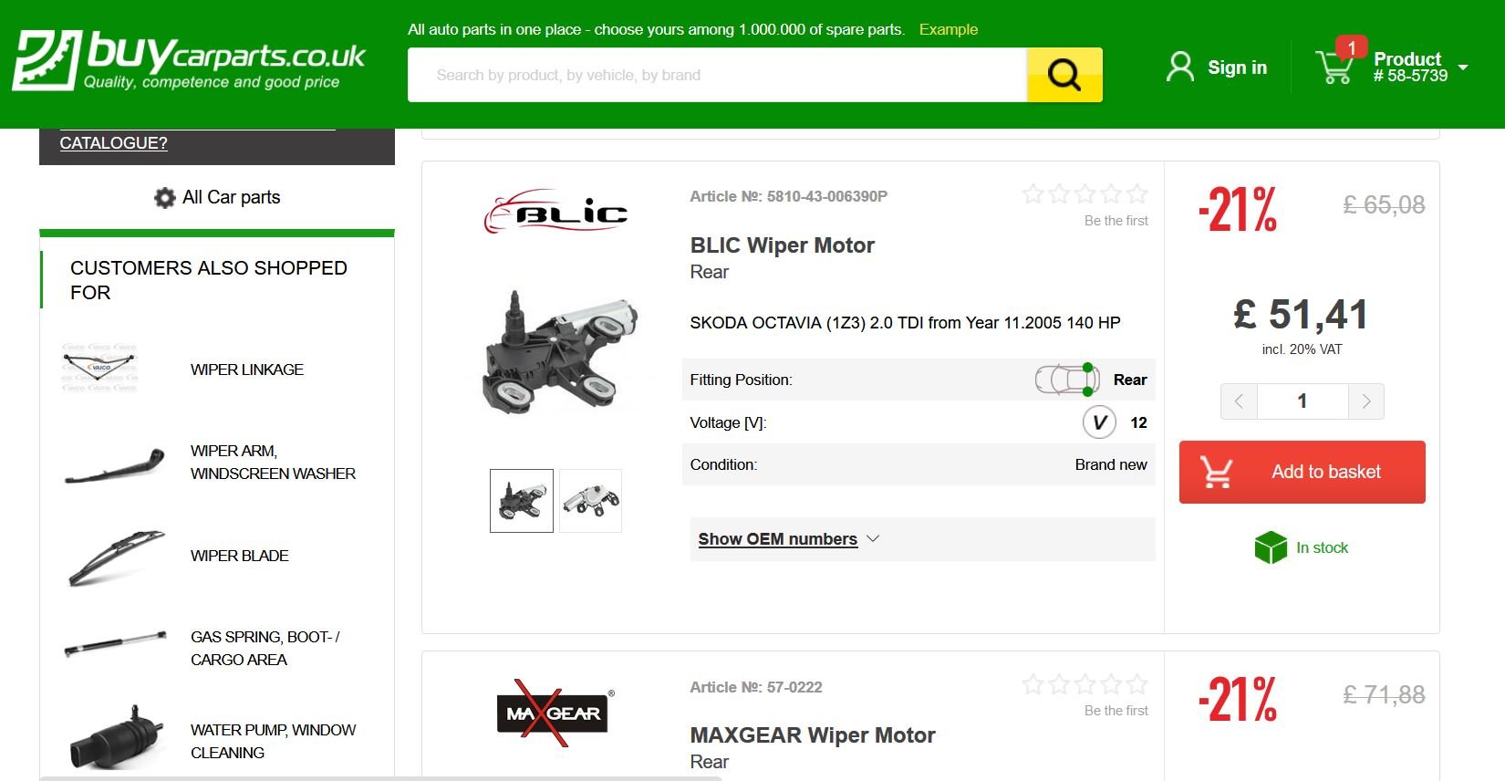

Many thanks for all of your inputs.  The final solution was as follows:  The fault was that the through-flow of water was blocked in the rear w/s wiper motor unit through channel.  This unit was very badly corroded and rust had taken its toll.  I bought a replacement unit ( see attachment invoice) and now fitted, full w/s washers are restored.
