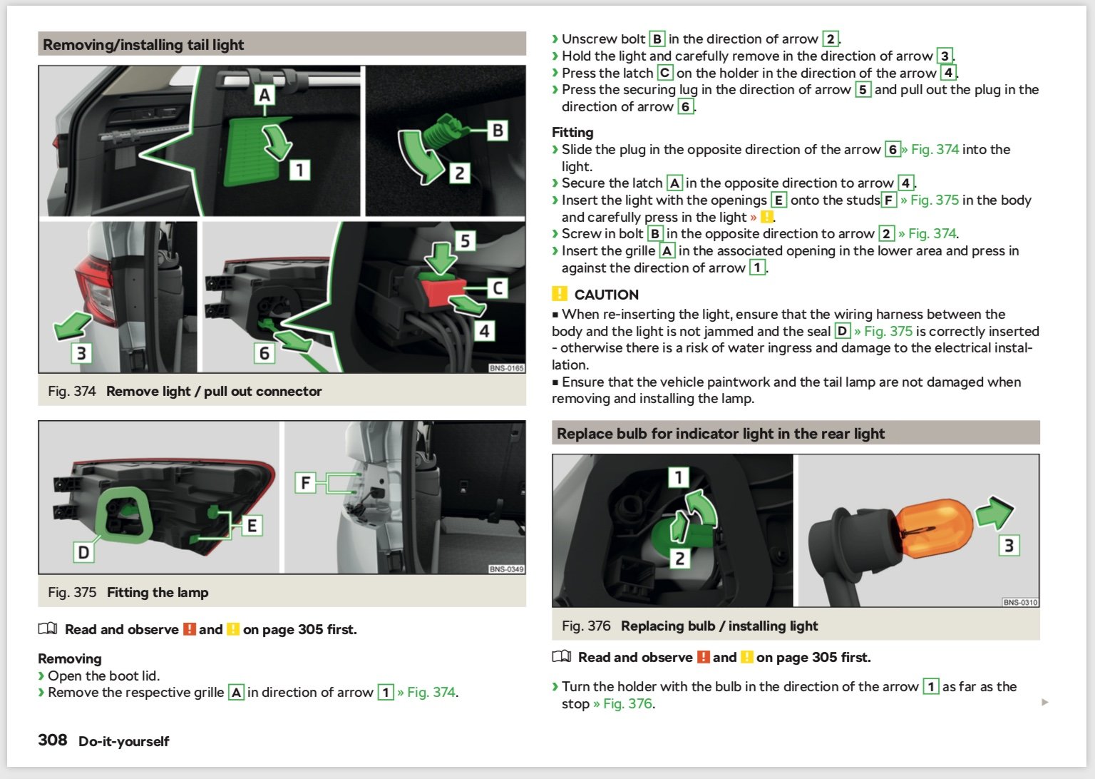

Hi - can anyone tell me how to remove the rear offside light cluster (the one on the wing) on my Skoda Kodiaq?
It’s covered in the owners manual...
Depending which model you have they might all be LED’s
