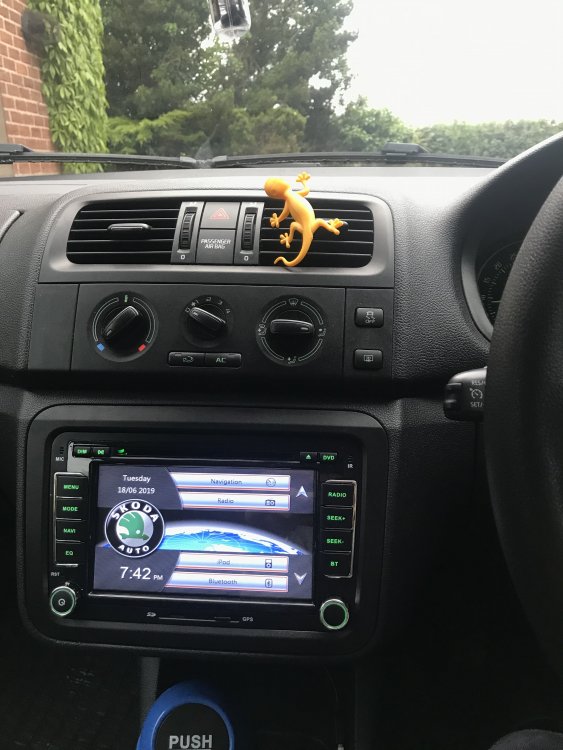

I ended up going down the cheaper amazon unit route, and chose the £150 RNS510 (Columbus) style Aumume headunit from Amazon. It isn’t an android unit, but it is based on wince, so it is very easy to use and offers the functionality you ask for. Time will tell about the build quality though.

I ended up going down the cheaper amazon units, and chose the £150 RNS510 (Columbus) style Aumume headunit from Amazon. It isn’t an android unit, but it is based on wince, so it is very easy to use and offers the functionality you ask for. Time will tell about the build quality though.
UPDATE- The head unit is being sent back because it keeps crashing. Don’t bother with it.

Arrived and installed - followed the guide on here to make sure I had one with a MAC address written on the side for built-in bluetooth. Working like a charm at a fraction of the price of a Columbus.
Used a generic sat nav aerial and genuine VW/Skoda microphone to get it all working.
Thanks for the advice!

I bought a used one on eBay. Had to check the pics to see that it had a non-zero MAC address on the label (as that indicates it has built-in bluetooth), and you need to check that they come with the security code too - quite a few don't.
