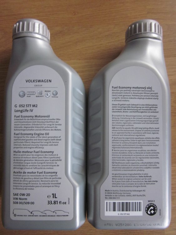

My MY18 Kodiaq was built with VW508 (0W20), which I suspect is all about ensuring the vehicle meets the stricter WLTP emissions standards, but at its first service was filled with VW507.

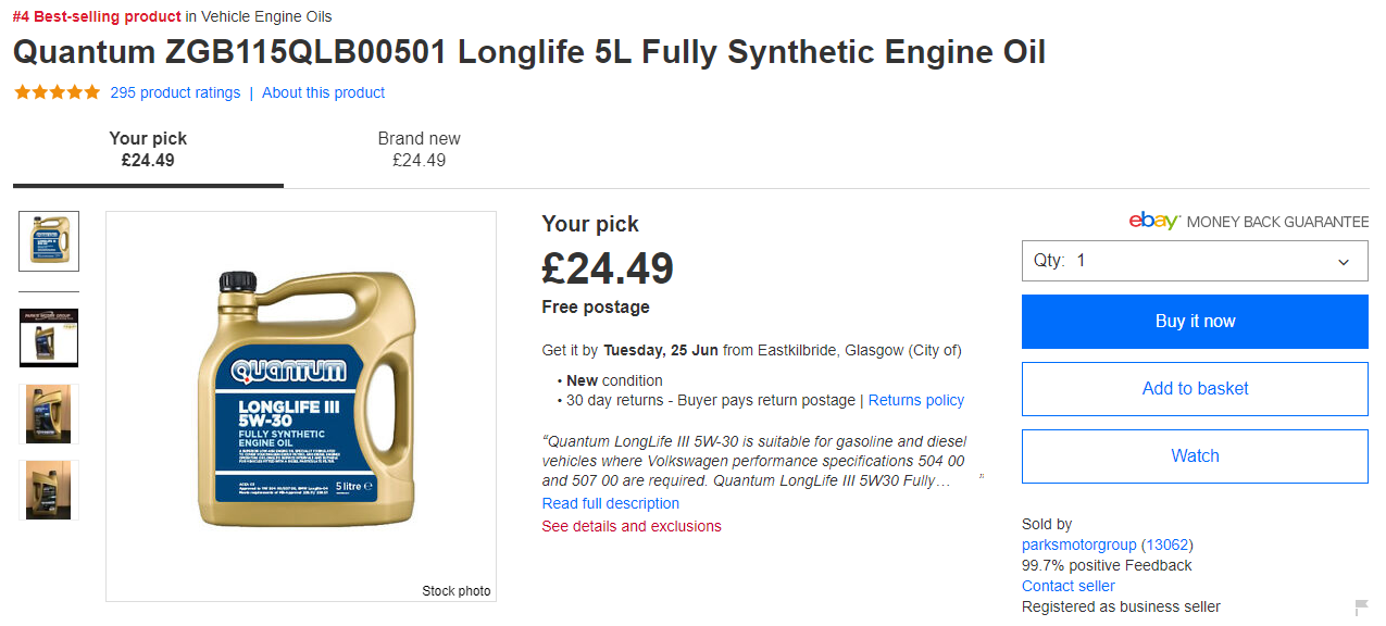

Luckily it's readily available from a few Skoda dealers via eBay for a good price, £25 for 5 litres delivered to your door...

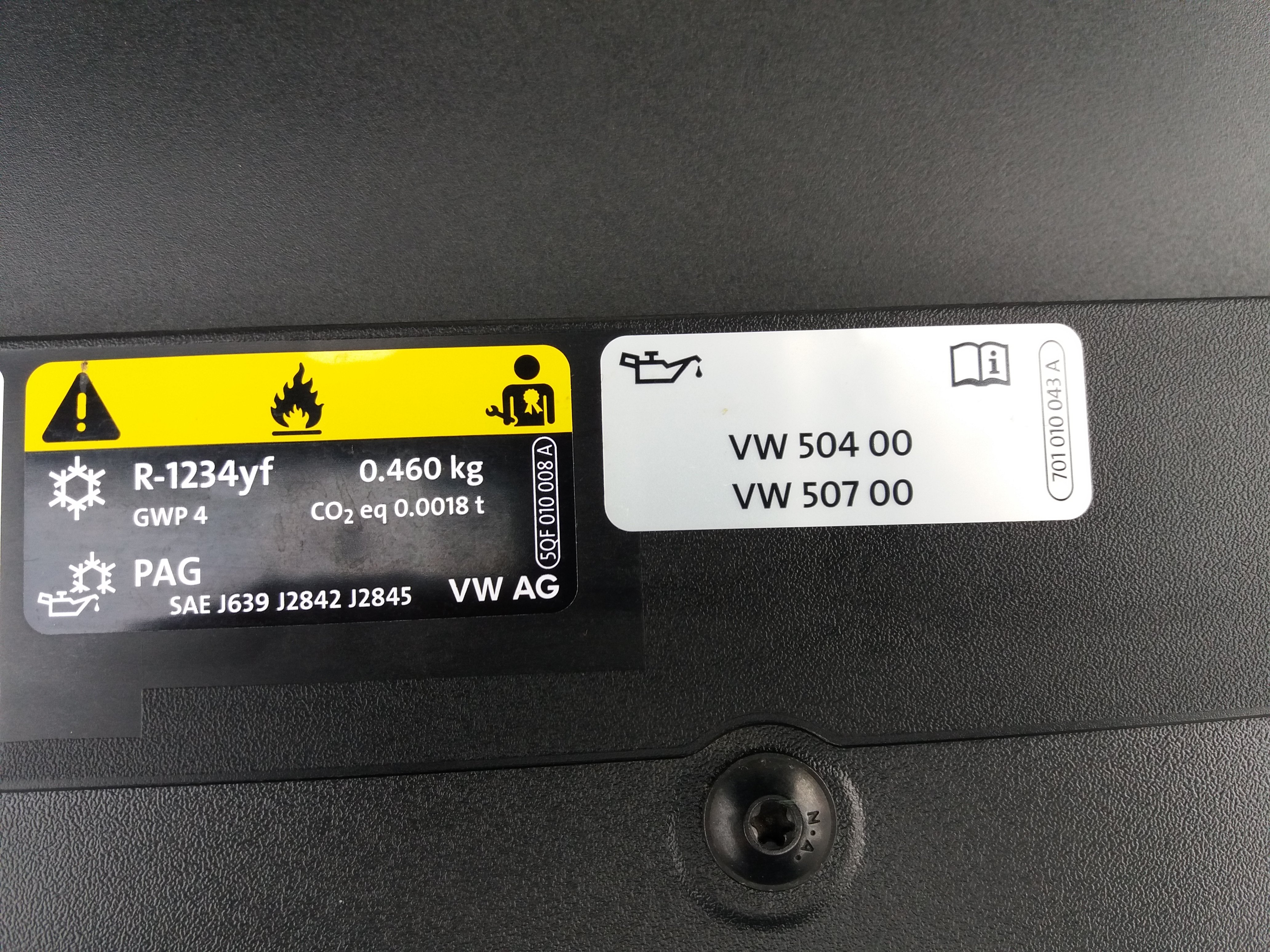

@silver1011 Just wondering, how can you tell that? Was there a sticker or something under the bonnet?
I had a bit of a strop with Skoda UK customer services when they couldn't tell me which oil was in my car. The sticker on the slam panel and the recommendation they were making contradicted each other.
In the end they had to consult their technical department who confirmed that the car was filled with VW508.00 (0W20) from the factory, but that their recommendation for topping up was VW507.00 (5W30).
I went against their advice and bought a 1 litre container of VW508.00 to top up. Now it's had its first service and is now running VW507.00 it's easier and cheaper for oil, as VW508.00 is actually quite hard to find.
