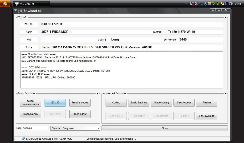

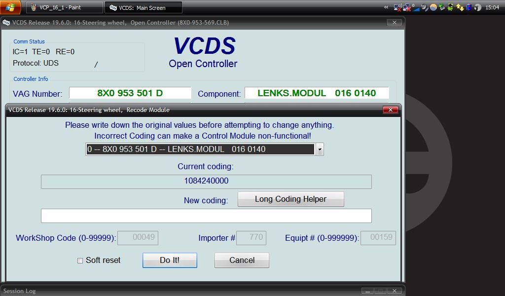

Today I connected the cable and tried to program/recode the module. I openend VCP, selected Module 16 and connected to it after selecting SK35X Skoda Octavia II/YETI ASAM.
Sadly enough the module did not except the following longcode: 1084240000. It did however accept 108024000, the coding without the MFSW activated. (Code was copied from VCDS)
Will let you know what happens next.
