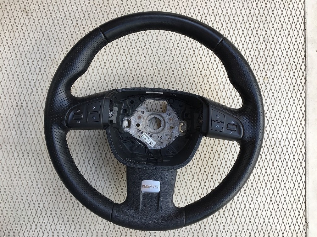

Hello,
After visiting several forums I decided to install a MFSW in my Octavia Combi 2011 FL, so I bought a Fabia vRS 3 spoke steering wheel and installed the Superb controls. Because the steering wheel had paddles I created two covers (3d models), these still need to be printed.
My car has:
1. Multi function display
2. Cruise control
Next steps:
1. Replacing steering wheel module
2. Replacing wiring/ harness  (3T0-971-584)?
3. Programming with VCDS
Yesterday I connected my car to VCDS for the first time. My list showed that I have a 5K0-953-569-C (mid-line) steering wheel module. If I'm correct then I will be needing a high-line like the 5K0-953-569-H or 5K0-953-569-AL?
Am I missing something? And is the mentioned harness the correct one?
Thanks a lot!
Or maybe the 5K0-953-569-AB / AP / BA because my car is a manual and not an automatic?

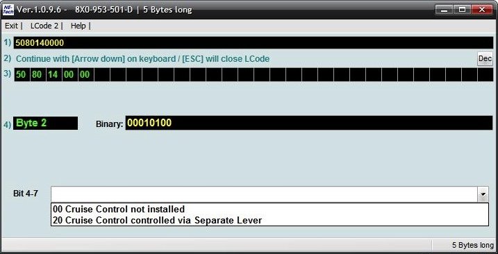

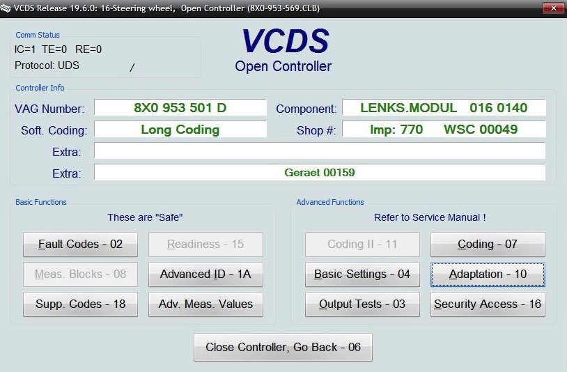

I just installed the 5K0-953-569-AL in my Skoda Octavia MK2 FL but I don't see all the cruise control options... I only see 00 and 20 but I already had 10 installed... Did I buy onze with the wrong software...?
Address 16: Steering wheel (J527)
Labels:| 8X0-953-569.clb
Part No SW: 8X0 953 501 D HW: 5K0 953 569 AL
Component: Revision: FF010018
Serial number: 20131115100775
Coding: 1984204000
Shop #: WSC 00049 770 00159
ASAM Dataset: EV_VW360SteerWheelUDS A03004
ROD: EV_VW360SteerWheelUDS.rod
VCID: 3B7581ECB265A89784-806E
SW: 8X0 953 501 D suggests it came from an Audi A1 or similar which could be causing your problems.
You can try manually editing the lcode but the module might reject it, are you using the latest VCDS version?

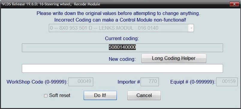

Hmm bummer these things are hard to find...
I tried setting it to 10 but it does not work...
Yes I am using v19.6
Edited by Danton

Try a reset on the module by coding it to zeros, then entering the coding you want
Just tried that but did not work at all 😞. When I did this I got an error from te stalks but didn't show me anything about the cruise control.
Address 16: Steering wheel (J527)       Labels:| 8X0-953-569.clb
   Component: LENKS.MODUL   016 0140
   Revision: FF010018    Serial number: 20131115100775
   Coding: 5080140000
   ASAM Dataset: EV_SMLSNGVOLWS A01004
   ROD: EV_SMLSNGVOLWS.rod
No fault code found.

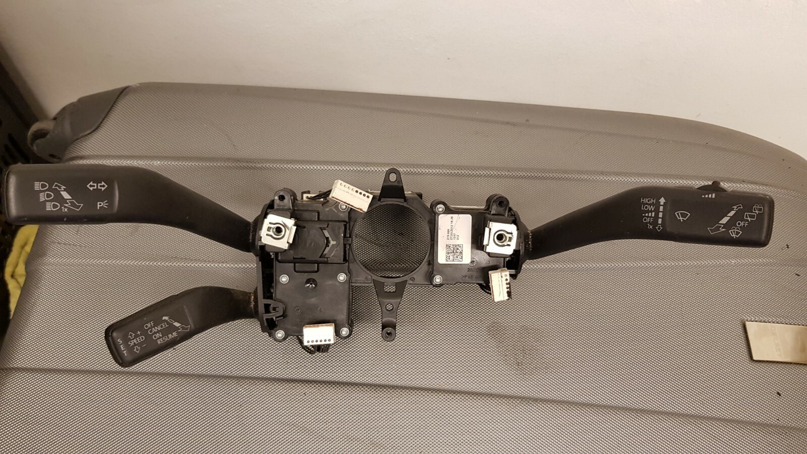

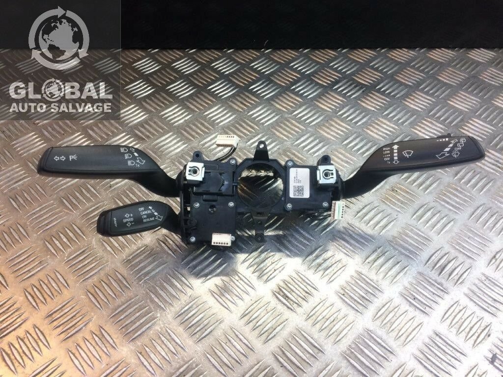

Audi uses a stalk with lever under the indicator stalk
VW also have a stalk like that, I fitted one to a Tiguan when I fitted Lane Assist to it
Could this stalk work? EBAY
But I think the steering wheel module won't fit...
Or an Audi stalk, but it does not have the Trip/ Maxidot buttons.
Edited by Danton
@Eddie-NL you are so helpful!
Oh I'm still a newbie I see... when it comes to bike parts I usually find everything 😬.
So the 5K0953502D does not have the TRIP buttons for the Maxidot, can I control the Maxidot via the MFSW?
Or do I need/ can I use something like the 3C9953502C, but this is from a Passat, that can be a problem?
Do you actually want to fit the three stalk version? You'd need to change the cover around the steering wheel for one with an extra hole.
With a MFSW and maxidot, the trip buttons on the right hand stalk aren't fitted. You can only code the car to use either the trip buttons or MFSW to control the maxidot, not both.
The stalks Ed posted look to be for a car with adaptive cruise control which might cause you issues.
I fitted the same style of stalks to a tiguan, although the stalks i fitted had the driver assistance button on the end. But the car didn't have adaptive cruise
It is also possible to cut the lower trim for the extra stalk
There might be several versions of stalk that will fit
I guess the question is which can you find for the least money.  stalks or a new module
does your car have a Maxidot?
My Octavia 1Z FL 2011 has a Maxidot, Cruise Control, Automatic wipers (rain sensor) and hopefully soon a working MFSW.

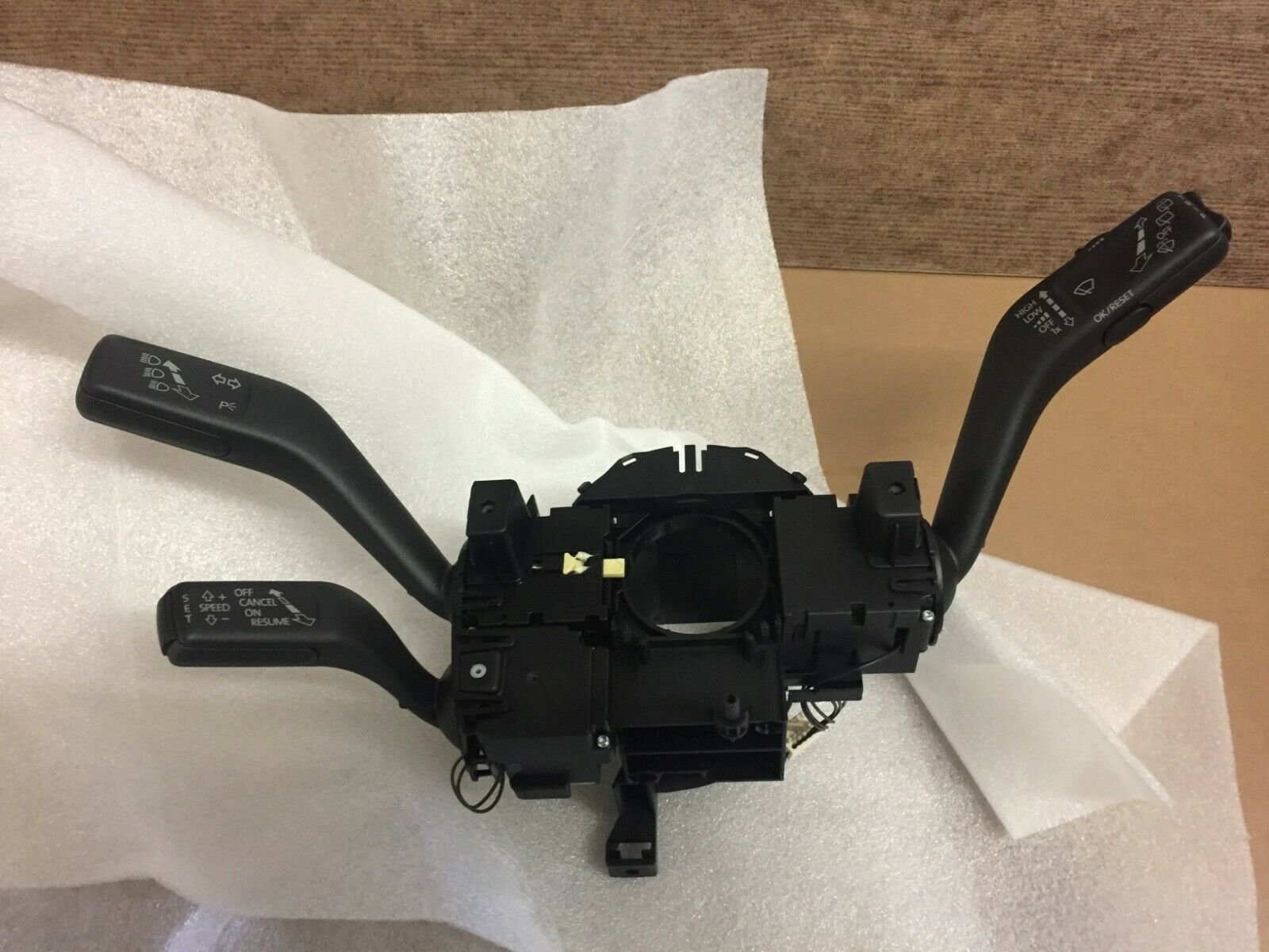

Well I could make a hole for the extra cruise control stalk, maybe a separate stalk adds extra comfort/ ease of use?
Oh maybe this one! 5K0953521BD
Edited by Danton
Yes, you need to disable the board computer via wiper stalk
once done, lock the car and wait till the maxidot powers down
Should work then
It is not so much an extra hole, but extending the current one, before you start make a template of the original shape
Okay! Just bought the 5K0953521BD stalk on ebay, €40,- is doable :).
   Coding: 1084044000
   Multifunction steering wheel control module:
   Subsystem 1 - Part No SW: 3T0 959 537     HW: 3T0 959 537   Labels: 3C8-959-537.CLB
   Component: E221__MFL-URO  H07 0012
   Coding: 800000

With the 5K0-953-569-AL steering wheel module the button still don't work... Installed the new stalks and cable but no response from the buttons whatsoever. Could my aftermarket cable cause any problems? Cornering lights, assisted driving lights, needle sweep are all working.
Could it be that my Octavia is missing a wire to the BCM?
