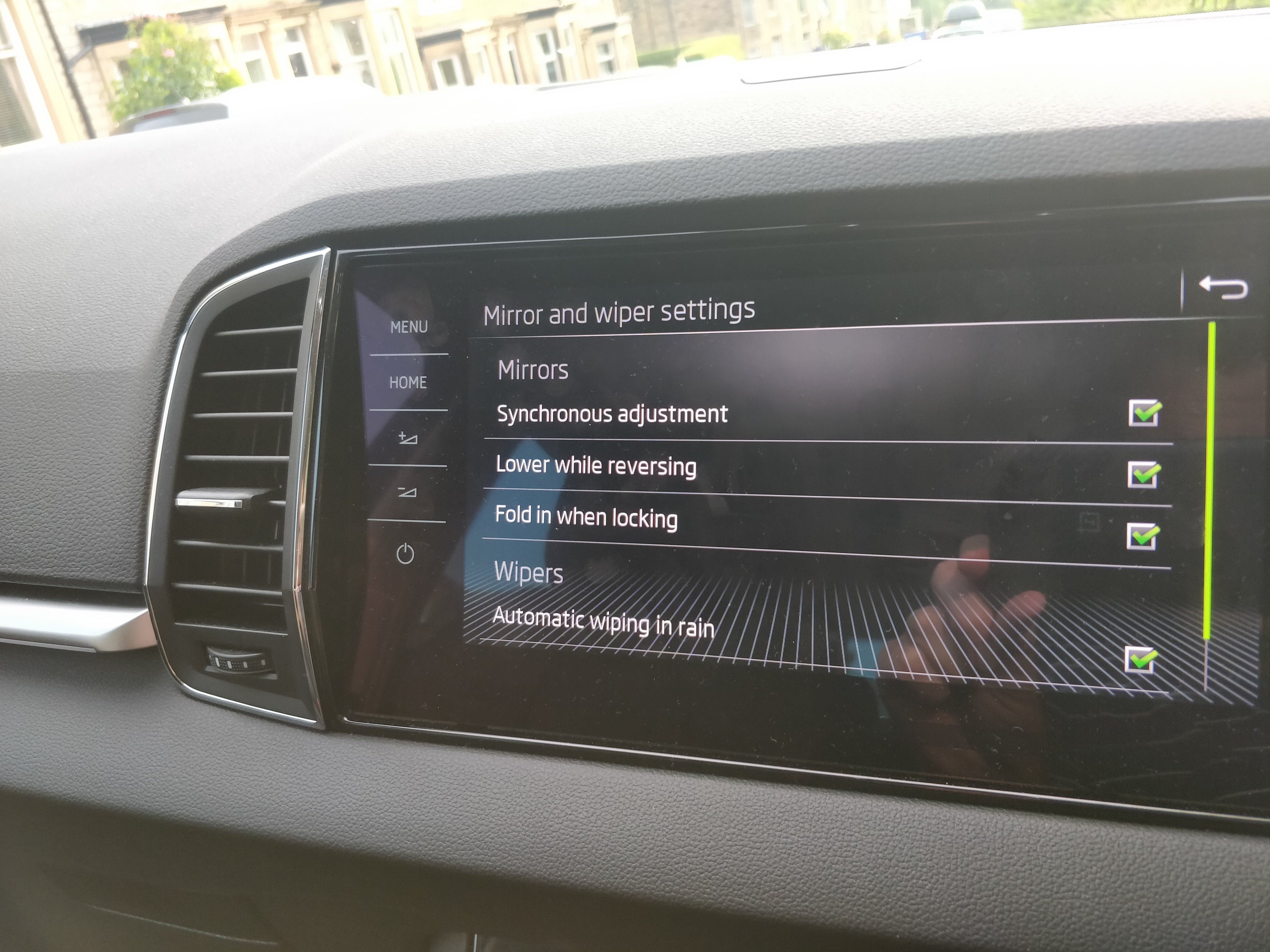

Is the option enabled in settings? Vehicle>Settings>Mirror and wiper settings - see attached photo.
Are the reverse and normal positions in the exact same position? Put car in reverse and start to reverse, stop, adjust mirror to desired dipped reverse position, then put car in first gear and drive off - mirror should return to normal position if it's all working correctly...

I'm missing that option from my menu 😞 I have Synchronous adjustment an then Fold in when locking only. Looks like I need to alter it via VCDS. No idea why that option is not enabled on my SE L with automatic wingmirrors!

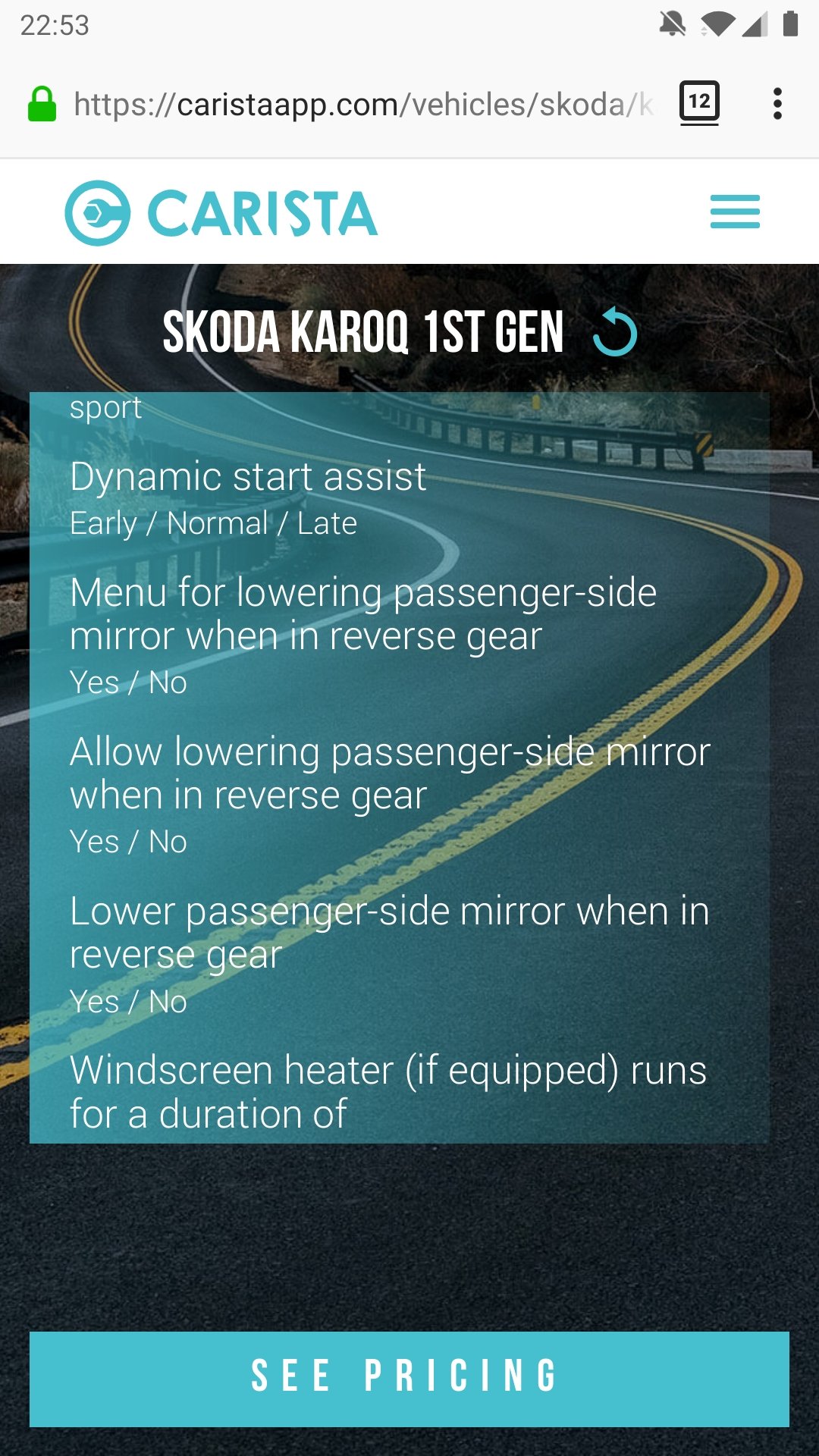

According to Carista website, it allows the menu options regarding reverse mirror to be changed.

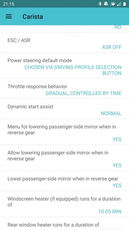

I will load mine up tomorrow and reply with the related settings, I would imagine all are Yes but shall confirm.

All three options enabled in my Carista as per attached screenshot.
Unless you know someone with OBD11 it might be cheaper getting yourself a Carista at £16 than getting a dealer to do it. It's certainly very easy.
