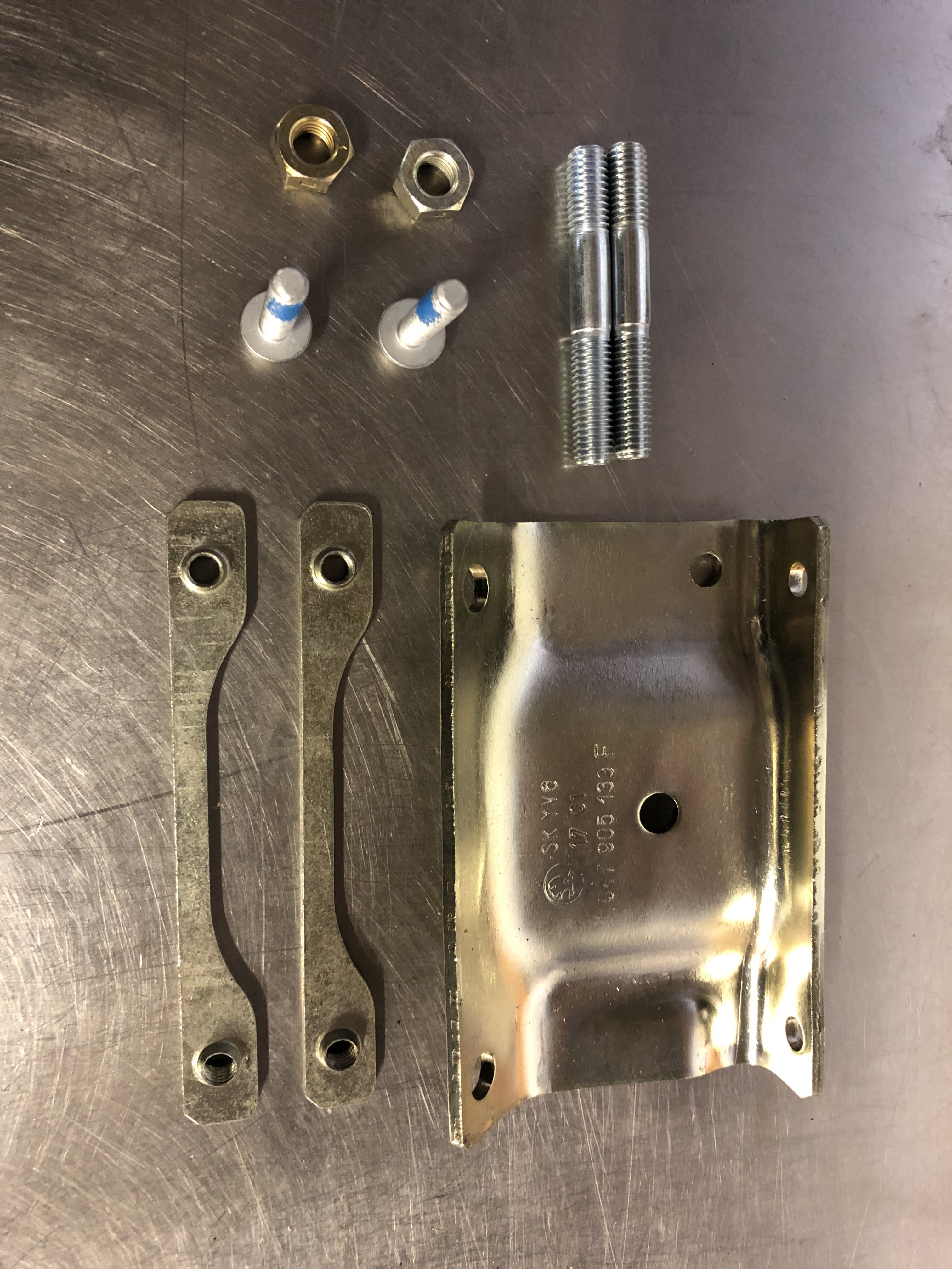

There was a modified mounting bracket for the coil pack that held it down better onto the plugs.
Any idea when that was introduced Ross?
I guess not then.
3 hours ago, TMB said:
I guess not then.
Sorry missed that one. God knows, talking nearly 20 years ago now. Not even sure if it was a production change or just a mod for problem cars.
Knew if I dug deep enough in my tool box....
Yes, a long time ago. No probs :)
