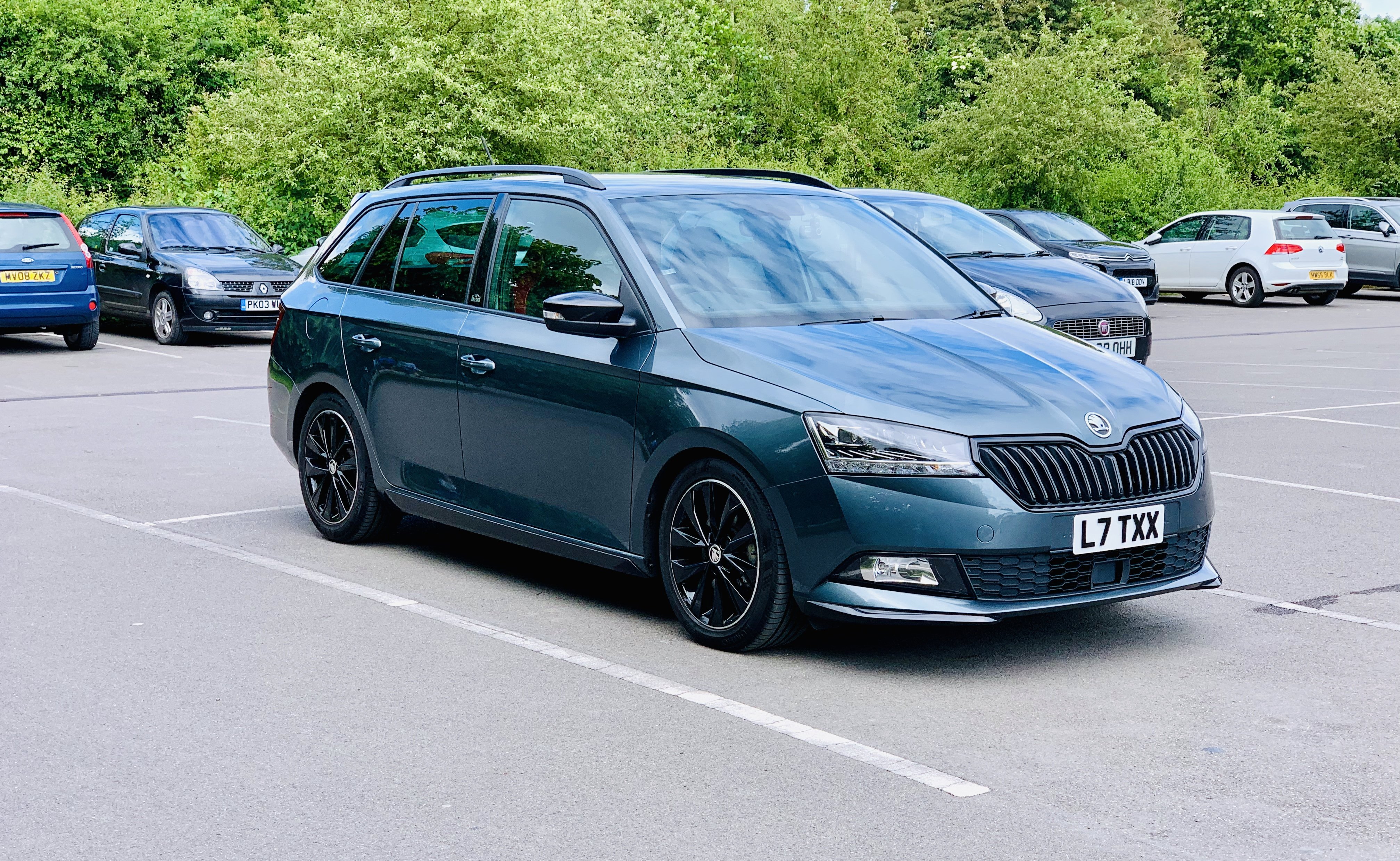

Thats odd they have gone for a 35 tyre actually smaller that my standard wheels!
I guess that was the only option without going wider...
What are your standard tyres?

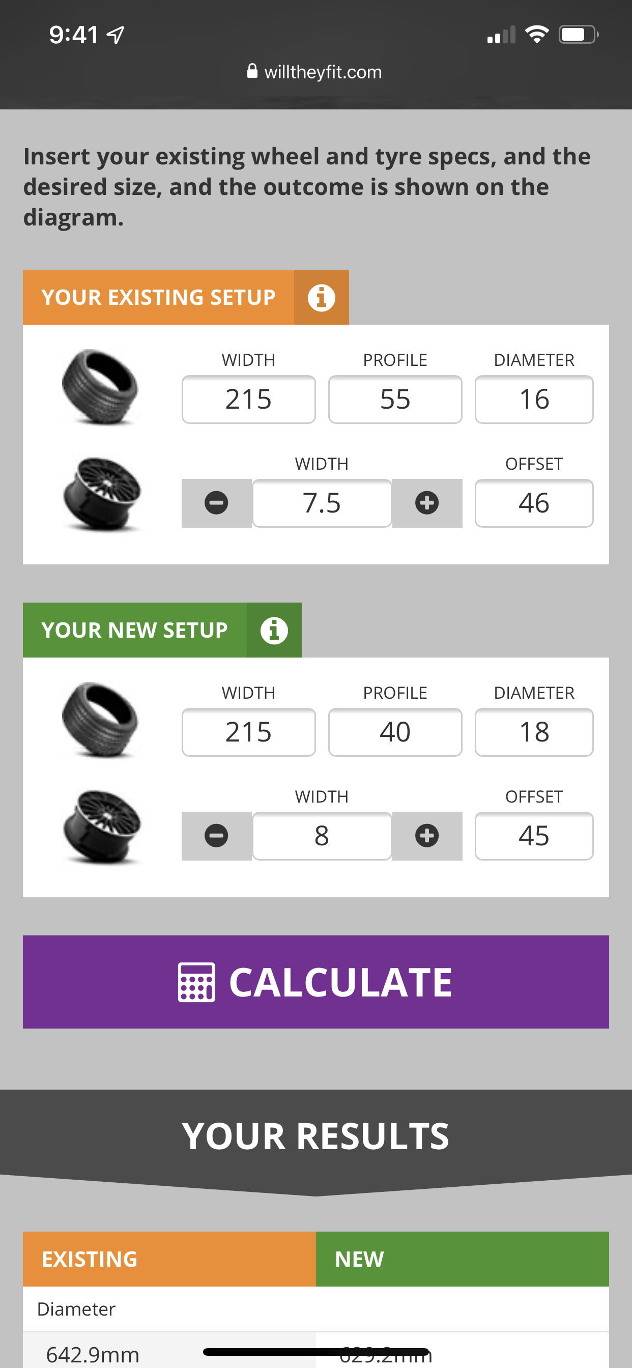

Top is standard. Same size overall is bottom. Recommend 40

How come you're running 215/55R16?

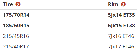

The standard spec is 215/45R16.
As follows;
   215/35R18                                                    7.5Jx18 ET46

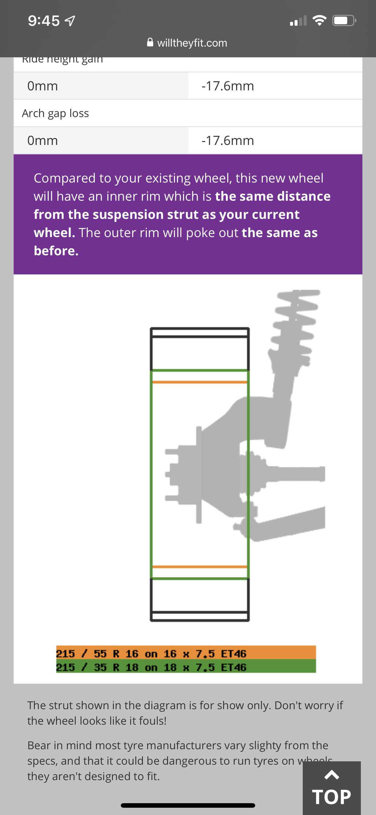

Note, if you are actually running 215/55R16 tyres, they're about 7.5% larger than OEM and from what i've noticed, the speedo seems to over-report by roughly 5%. So you'd actually be going ~2.5% faster than your speedo says.

Bottom line

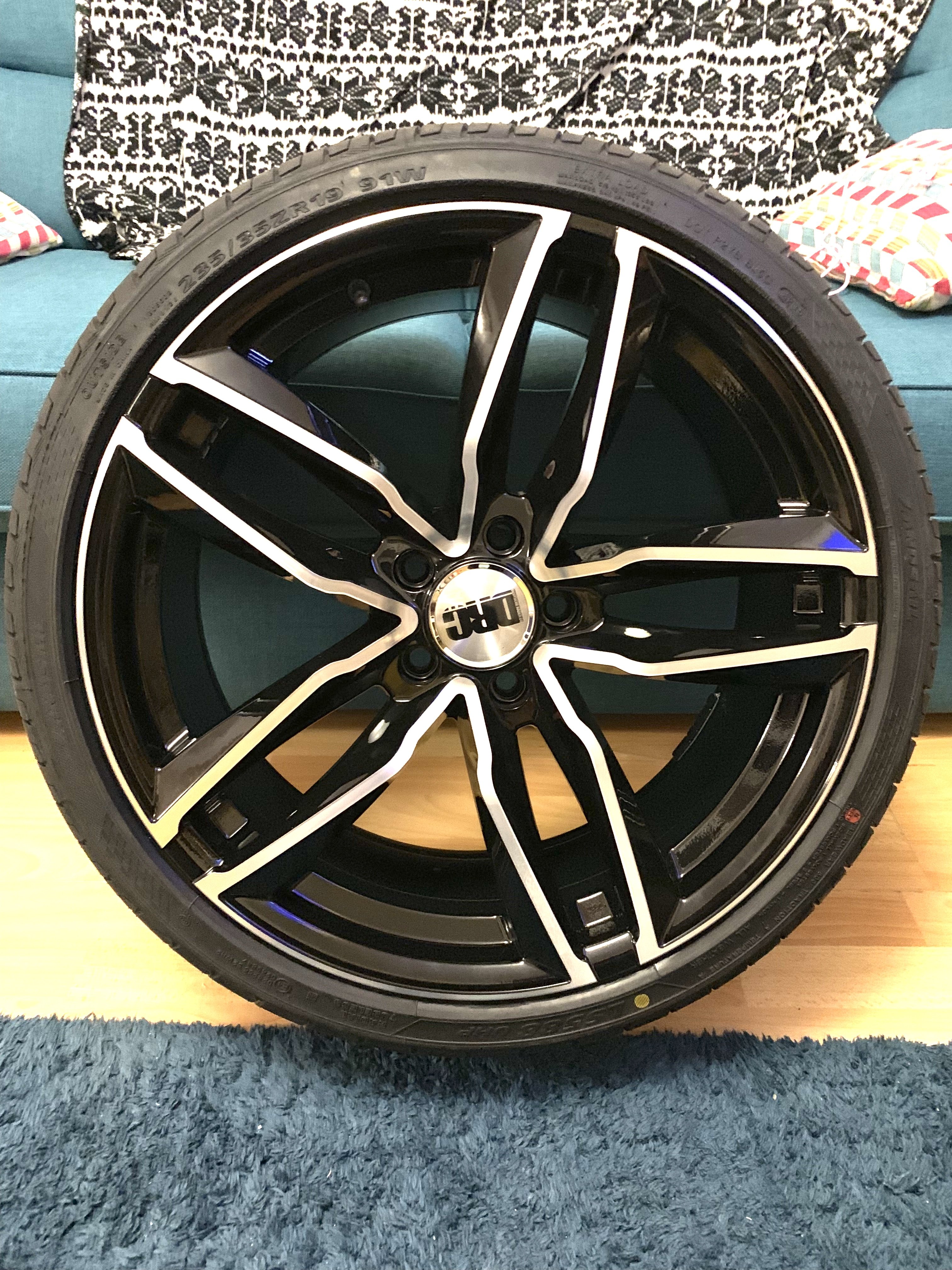

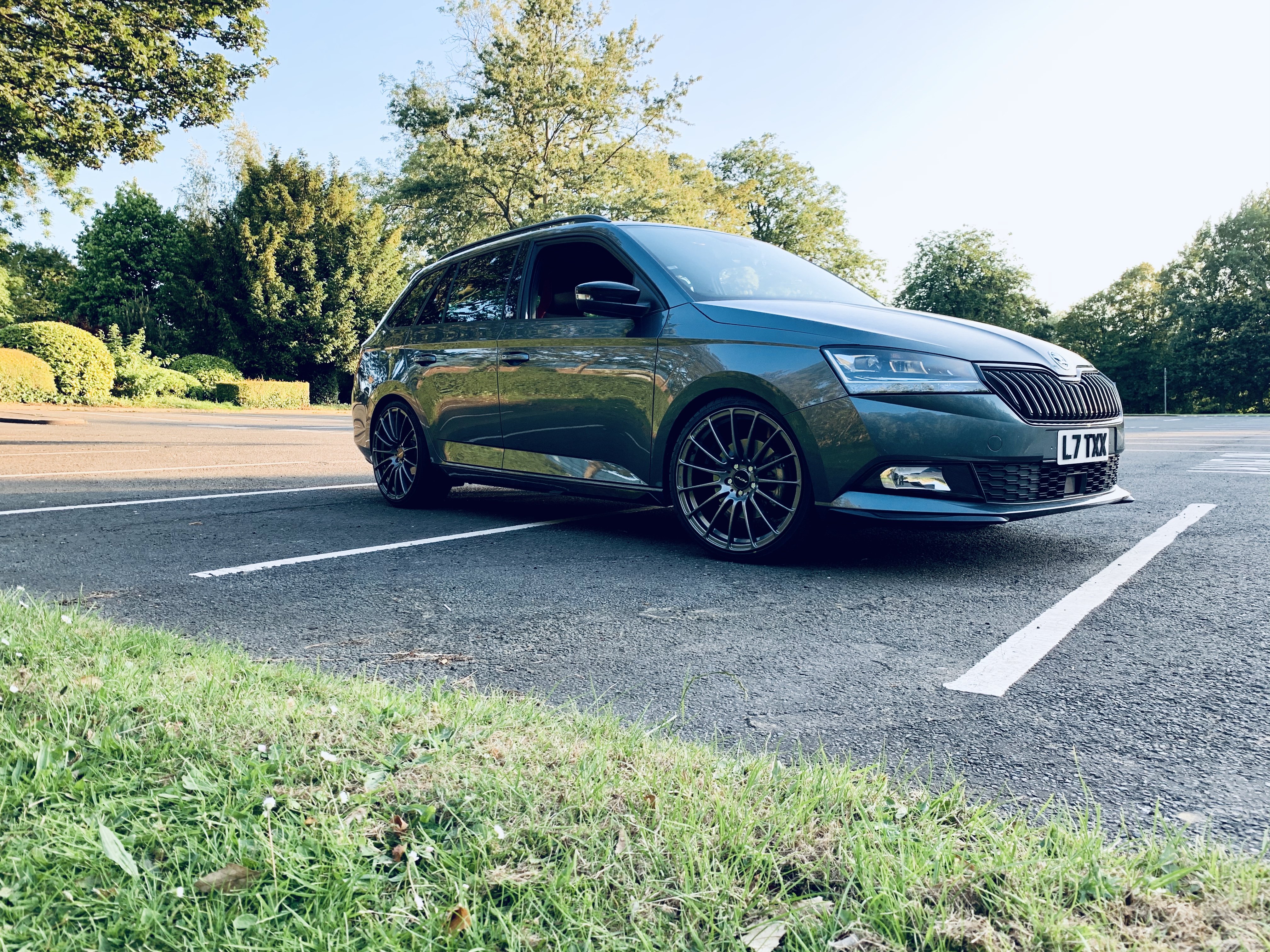

Gone for 215-35-8j ET 42 Hopefully that will fit! I’ve only got 10mm spare between the suspension and wheel ET42 brings it in another 3mm.

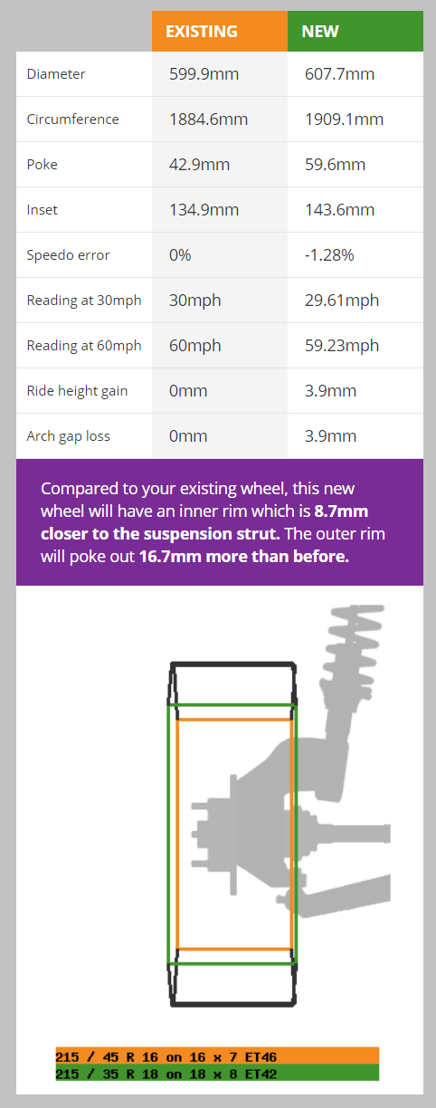

What's your current? 215/45R16?
If you have 10mm space on a 7J ET46
The 8J is 25.4mm wider overall, call that 13mm each side.
You now have -3mm gap to the suspension...
You may need more than ET42 to clear the suspension.
Also 215 on an 8J is stretching it a bit.

With corrected OEM size, and your target rim/tyres added;

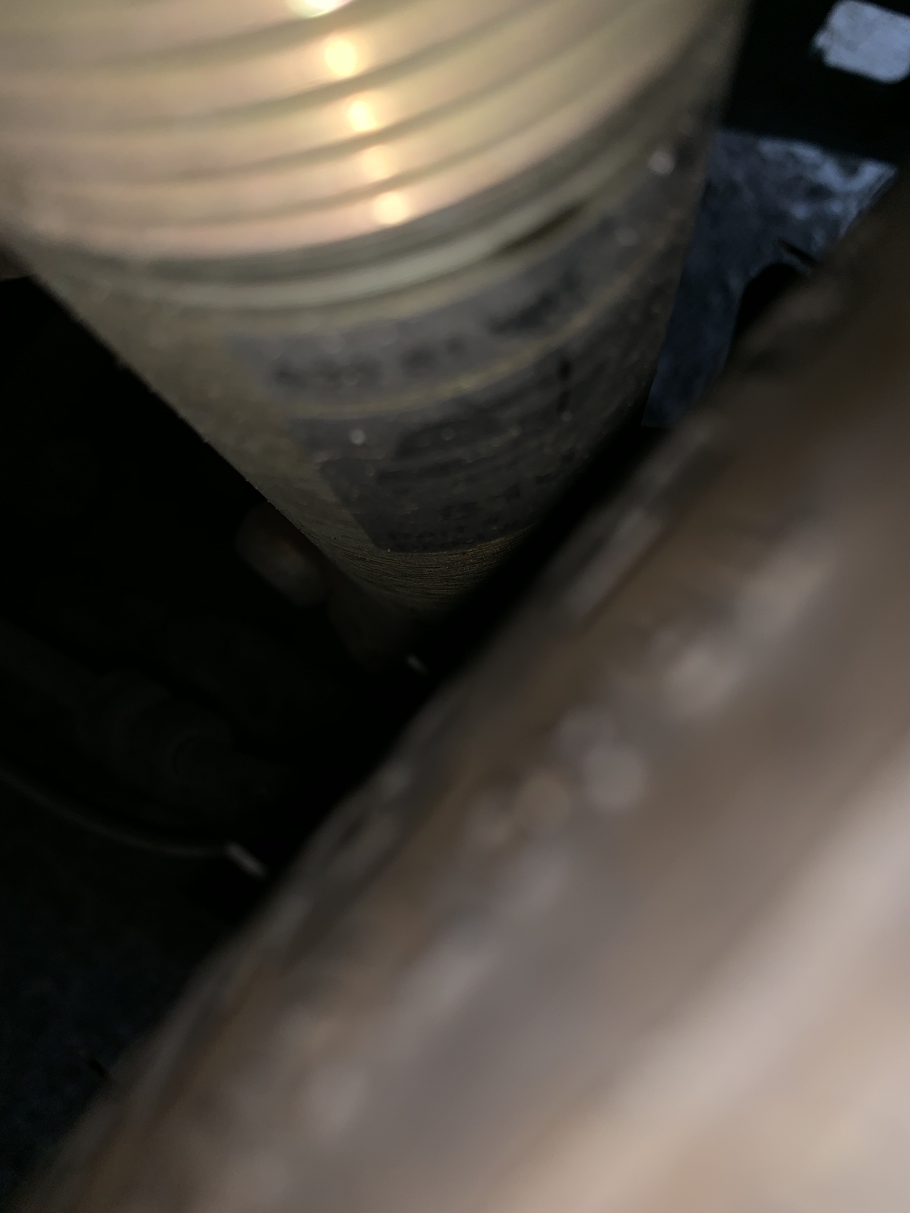

Well had another remeasure and I figure there is 11mm between my wheel and suspension so it’s going to be close but should be ok. Now the tyre is closer but on an 8j tyre will be thinner than the wheel. Should be fine on the outer think it will still tuck in just. May need to raise the front slightly from 55mm lowered. I’m alright with that.
Hight I’m on now is below.
Had these 19s on my Audi A3 35s although a bit wider the ride quality was fine probably more down to the suspension. I keep my tyres aired up for fuel economy so can’t imagine there will be a massive change. Fingers crossed!

Just make sure nothing rubs when on the ground, when its up in the air all the geometries go way off so yeah. Looks like you should be about ok. How are those ST X by KW coilovers treating you?

I will be double checking everything! The coilovers are great! Nice and comfortable no complaints not crashy and drives well on the motorway. I do find with them and the remap it does tend to spin a bit more instead of hopping so that’s an improvement. Just ready to get some better tyres on it.

Finally on fit perfect! About 3mm left between the suspension and set in enough I didn’t have to raise it at all!
