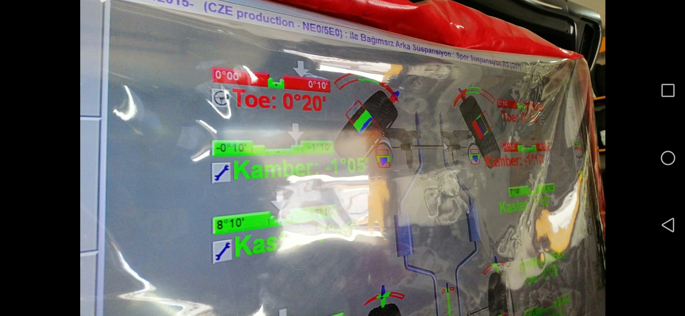

Had exact same problem this summer.
I have Rs 220.Did do a wheelalignment the day before vacation. (Who did a very bad job)
After that the steering got very very light, even if I had Sport mode on. Not comfortable on highway speeds.
When reached my destination I did alignment again (in turkey)
It got back to as it was again. The wheelalignment was totally of and that was what causing the light wheel.
Check your alignment on any shop that got new digital equipment. Think thats your issue.
Thanks for that info. My alignment was checked and should have been set the third time i complained of this at the service/dealer.  At least they said they ve've set it (but maybe it was not done ok).
It was still the same. Felt a bit better but still not ok.
Now when i changed the shocks, the same service did the alignment again after replacing and this might have been done better as the feel is much better if this could actually influence. Its still light for me but seems very close to normal i would say..
Roottootemoot, Tosun: thanks, i needo to find someone to do this also if it can be done (it was stated to me clearly that it cant at the dealers).
Edited by Accim85
You replaced shocks, did alignment and it felt better.Then I bet it could get better.Find a place nesr you that are specialized on tires/wheel alignment.
Many places does this but not many do it right 👍
