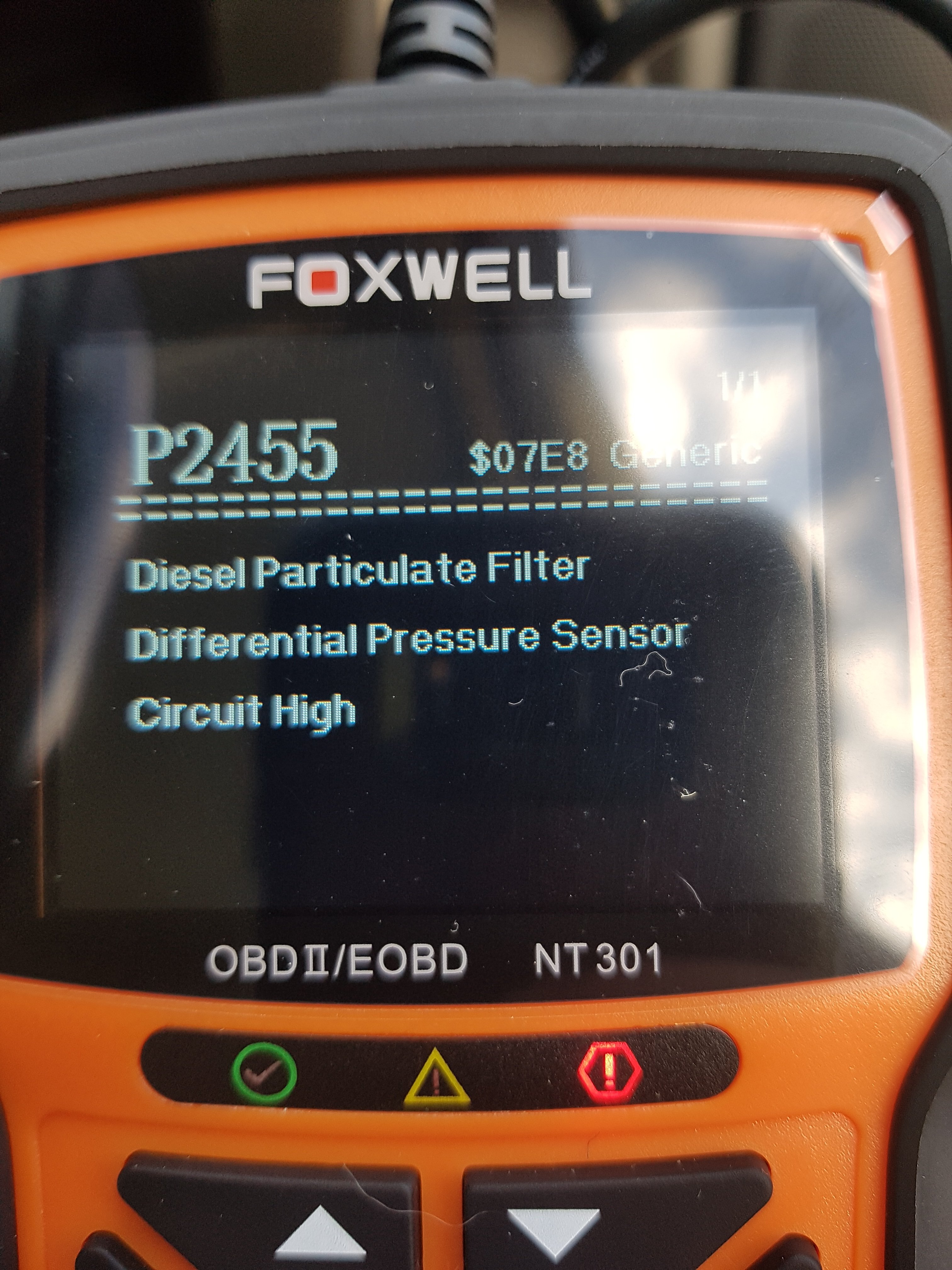

Update: In the last week the fault has been getting more persistent and frequent, sometimes the car would be fine and then it would show the "Engine Fault - Workshop!" message and start flashing the glowplug light, but as i said before, no loss in performance, the car drives the same, more recently however, is that the MIL has been coming on and staying on, sometimes with the coil light, sometimes on its own, or vice versa.
I also got my OBD II Scan tool today so here's the code it pulled
P2455	$07E8 Generic
Diesel Particulate Filter
Differential Pressure Sensor
Circuit High
Is this a bad fault? does anyone here know what this means or have info on the fault? i googled it and it said its urgent and i should go to the garage? the scan tool also said its a serious fault, but there's no DPF light on the dash?
I will appreciate any helpful discussion on the fault
New pressure sensor required and calibrate I’d expect.

Thank you! How much do you think this would cost? definitely going to my local garage tomorrow

Was taking a bit of a risk driving the car a few days ago, it was all fine, no faults, was on the motorway when i heard the ding and saw the "Diesel Particulate Filter - Owners Manual" message on the screen, the DPF light turned on, no adverse effects appeared to have happened, the light cleared about an hour later during idling, the scan tool now says its all fine? i will appreciate any helpful discussion on this, was this possibly a "DPF Regeneration"?
Quite possible........if it starts and does not finish, ie you stop driving, then it will continue next time and often takes longer.
My company Astra says "Don't stop keep driving " well thats great when I have just picked up fish and chips!!....hence went home and it finished the next day.
If something is wrong or a regen fails you get the DPF light. Drive the car to get the regen to complete. Regen will try 5 times, it it fails it will then illuminate the coil light too. If you continue to drive then the EML will also illuminate. Once you have a hat trick the system has to have a forced regen / diagnostics, it will not clear itself.
