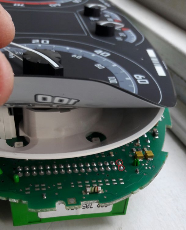

Check that the wire to the pressure switch is undamaged.
The cluster electronics doesn't look at the state of the pressure switch below 1500rpm, so that may explain why you get the warning only at rpm above that.
What year is the car, and how many miles done?
It could be a dry joint at the green connector on the cluster PCB. Common on early cars.

The instrument cluster, speedo/rpm gauge etc.

You can get enough access to get a reasonably good look at the solder joints without completely disassembling all the needles off the gauges etc.
I have a photo somewhere of one being examined. Will add it tomorrow.
I've got it handy...

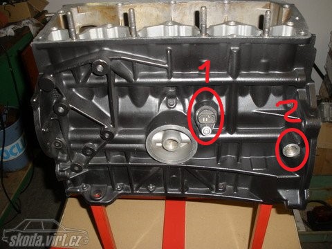

I have got the panel out and will have a play at work tomorrow. Out of interest what is the sensor on the front of the block next to the oil filter. Is it an oil level sensor?
Pete
Oil pressure, no level sensors on UK Fabias.

Number 1 = camshaft sensor
Number 2 = oil pressure switch.....
