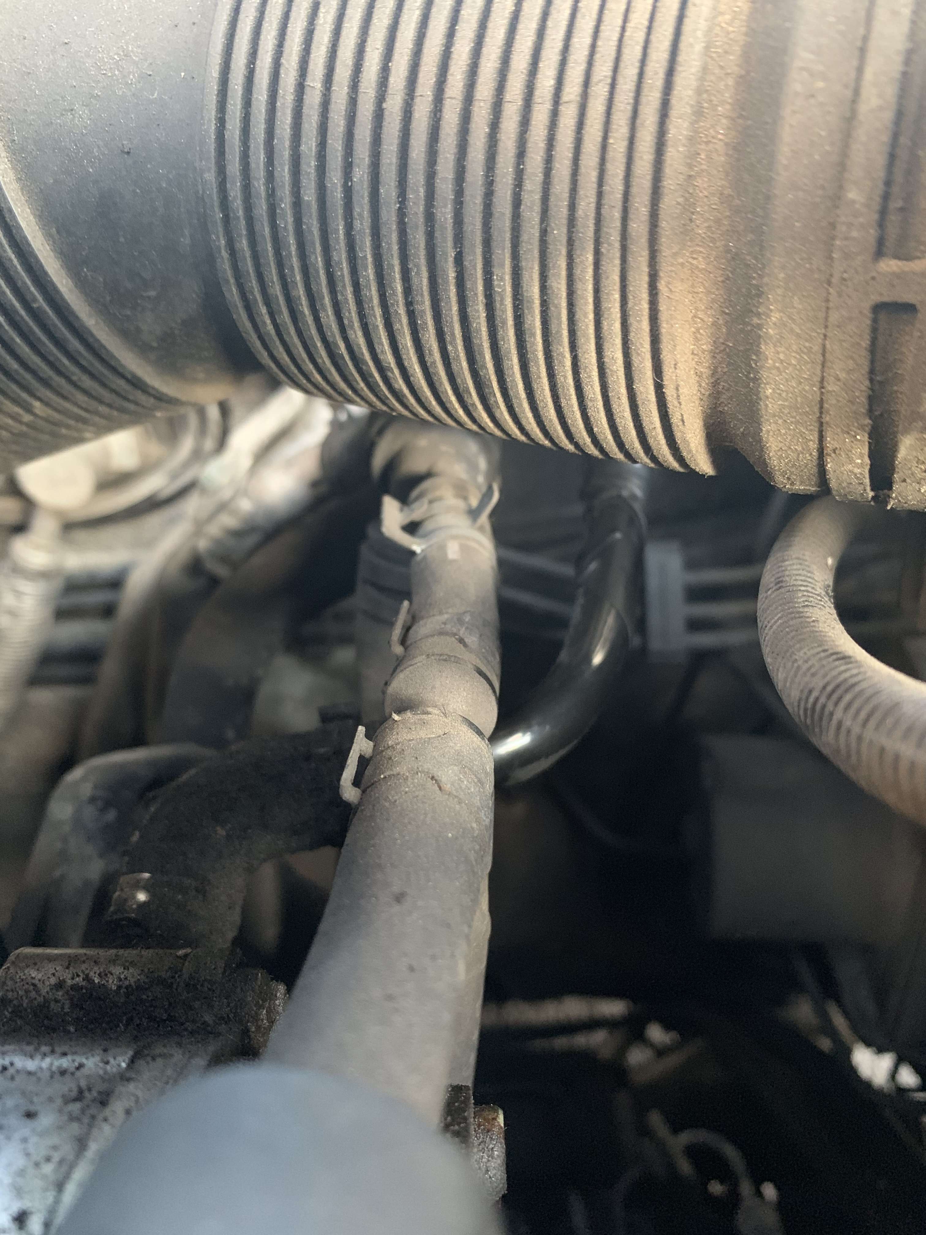

28 minutes ago, Oli3000 said:
servo vacuum pipe - can't obviously see any issues here
Have you looked from all angles, and felt as well? They can be sneaky, and only split on the downward-facing side.
Phone cameras are handy for looking at the otherwise unviewable angles. Feeling with fingertips will also reveal splits and cracks that might not be visible from above.
The last couple of badly split ones I've come across both looked fine at first glance.
Do you think that fits the symptoms then? Do I check with engine running?
  • Sponsor
Not sure, but it's very common for these hoses to split, so worth checking carefully anyway.

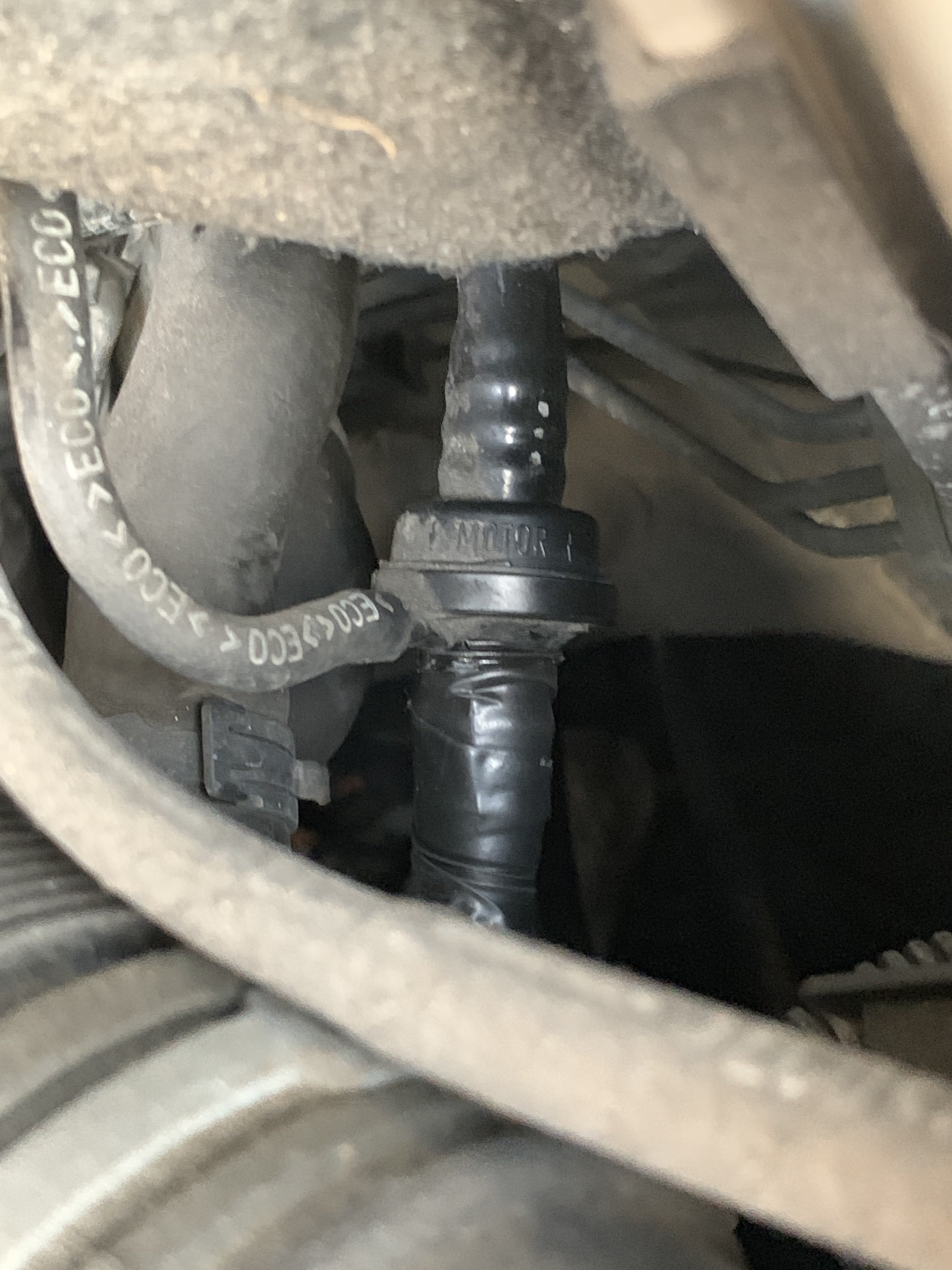

You are completely right - it is split exactly where that picture shows, just on one side of that black block that is closest to the engine end.
It looks dead easy to change engine end - just a small jubilee clip. The master cylinder end looks tricky to get to. Any tips or advice on how to do it?

  • Sponsor
Try taping up the splits with plenty of gaffer tape wrapped around and around and see if the symptoms improve, as a first step.
Have taped it with electrical tape (all I had to hand).
Braking improved ✅
ABS now kicks in again ✅
Shudder when turning the engine off has gone ✅

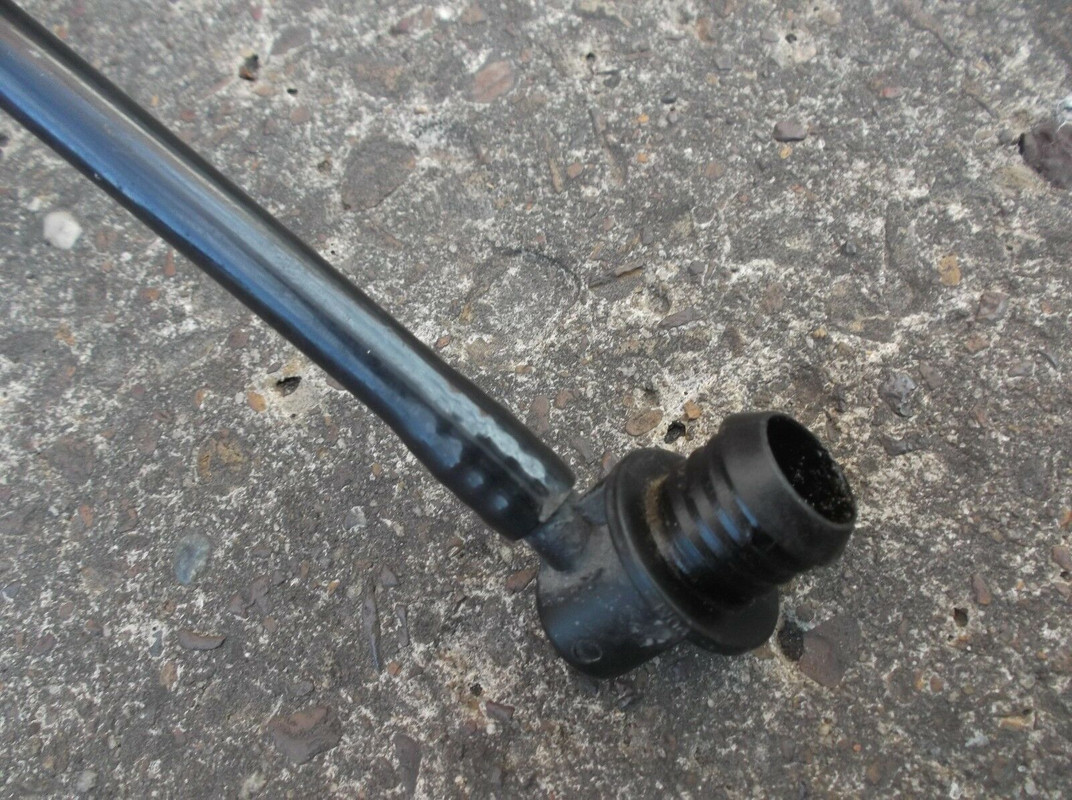

The servo end usually just has barbs that push into a rubber grommet.
  • Sponsor

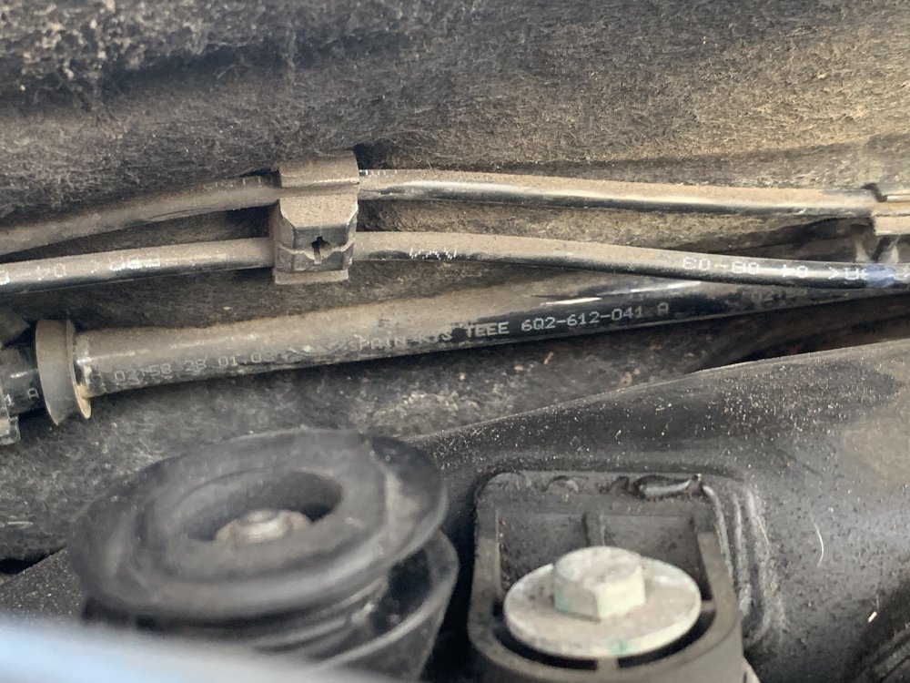

There should be a part number on the existing one.
Like this....
Looks like it's 6Q2612041A from googling. Maybe my TPS will have one if I ring them in the morning.
Fab thanks - so a good yank should remove the old one and then the new one will just press in?
There is a feeder pipe that goes to the ABS from near the engine end - presumably that just pulls off and pushes back on?
Yeah I did mine a few years ago and it easily pulled out and the new one was a doddle to push in.

If that part number is right, it's been superseded a few times and currently 6Q2612041CD as far as I can see.

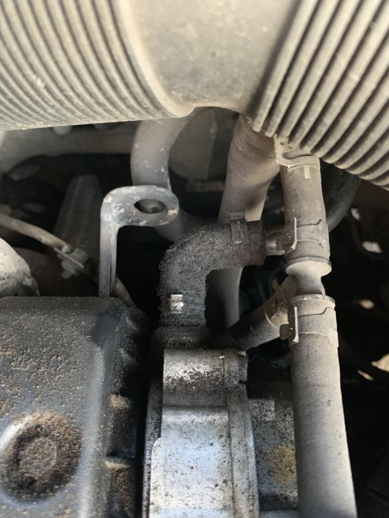

I'm not sure which pipe that is. Don't think mine has anything like that.
Can see the section I have taped there, and at that junction is a pipe going to the ABS - beautifully highlighted!
It's a 1.9tdi 2003
^ Oh yeah, just pulls off :)
By the way, that's the EGR valve block not the ABS.

4 minutes ago, Oli3000 said:
At which end?
Opposite of the servo end. It looks like you have a crimped clip on it. I think mine did too.
