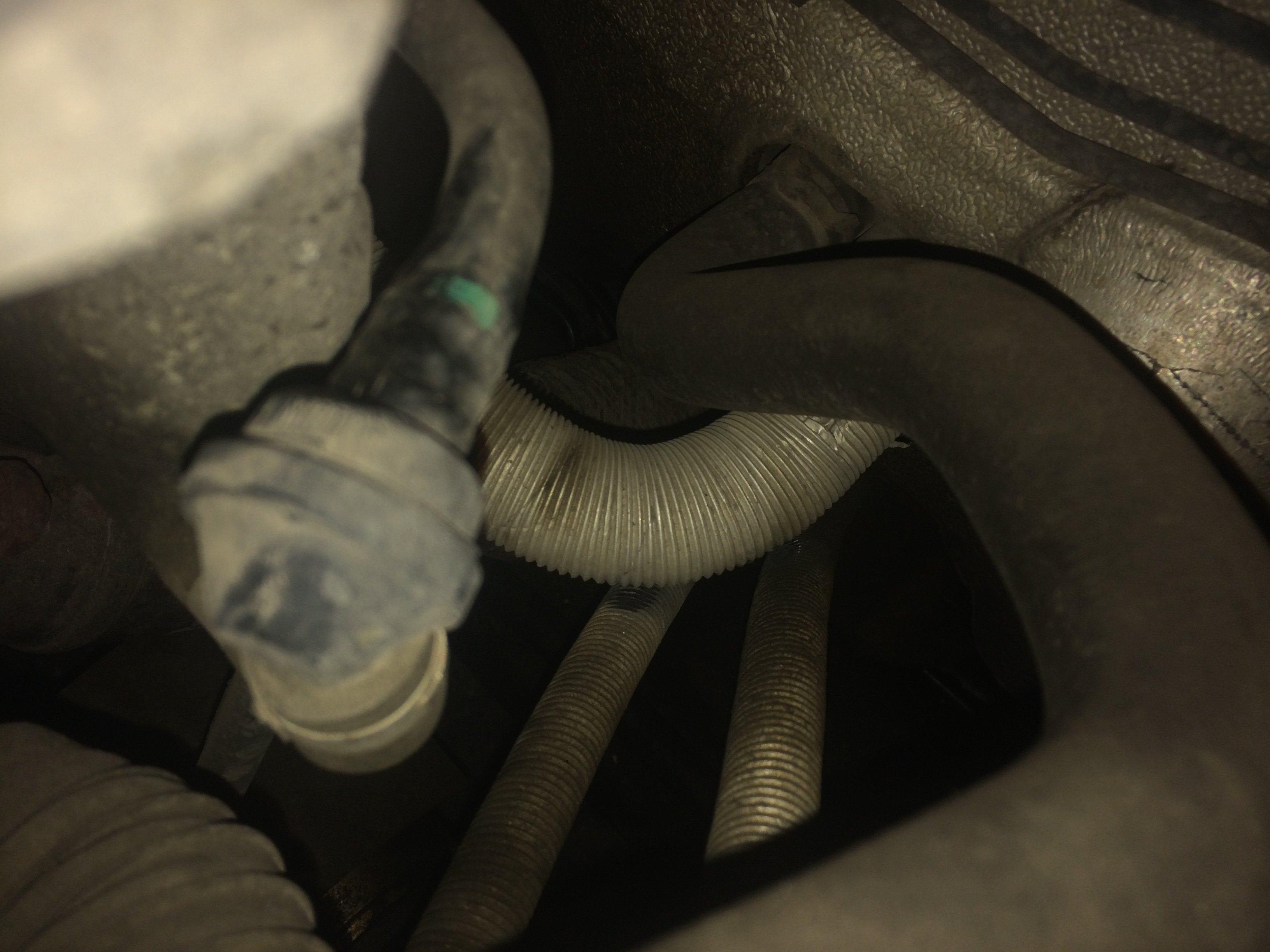

however there was one very slight split that I could see on the end, I’ve attached a photo. It’s not very clear, and I will try gaffa tape around it. Is this likely to make a huge difference?
Have you checked the bottom of it? That's where they often seem to split just out of sight.
I’ve had a feel, but there doesn’t feel anything as “dramatic” as some of the photos on this thread.
i tried getting my phone in, but couldn’t angle it for a decent shot
You need to check every joint in that pipe by giving each one a good tug, if the pipe is intact it won't come off, any splits you find will leak and need fixing.
