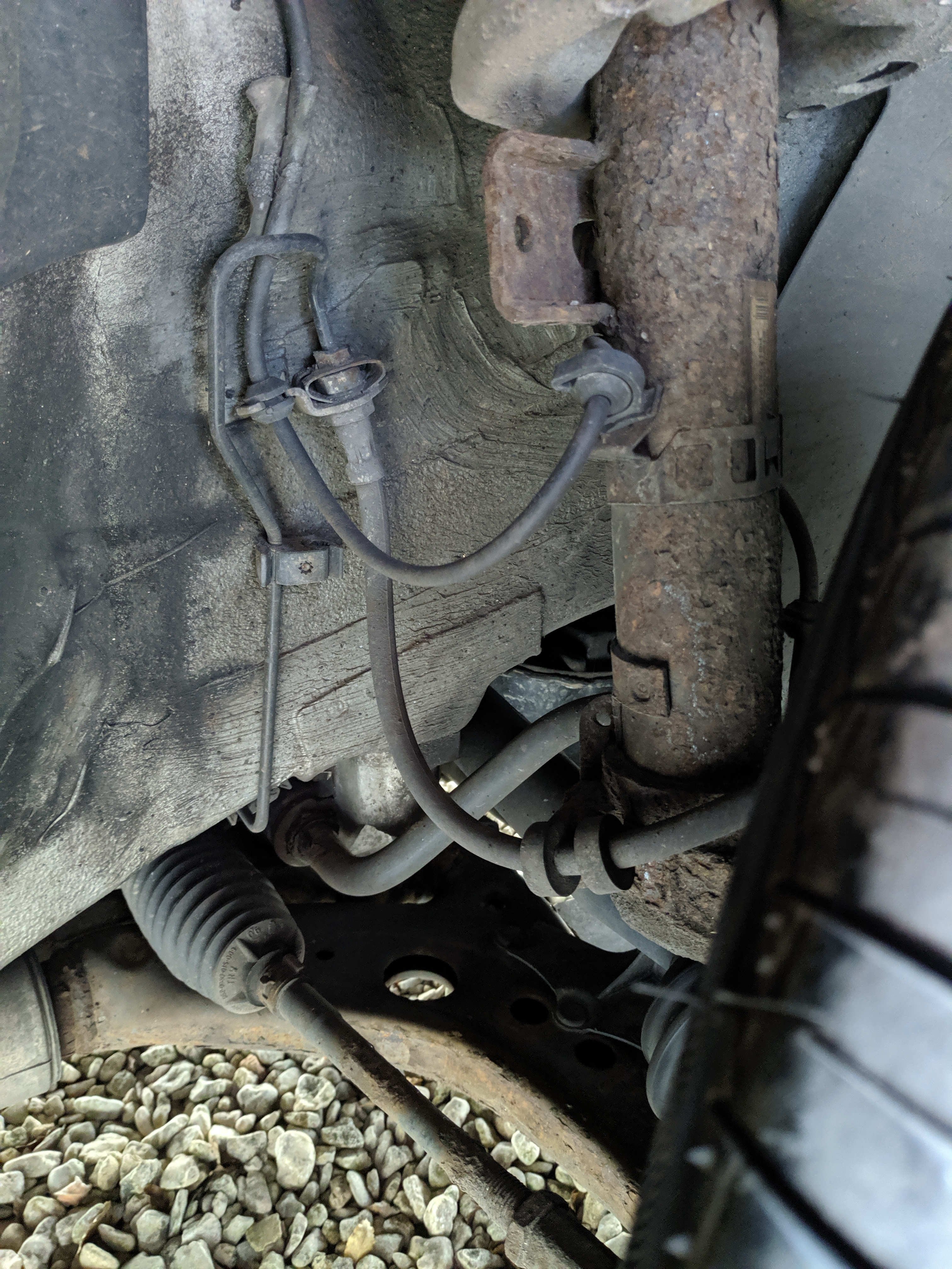

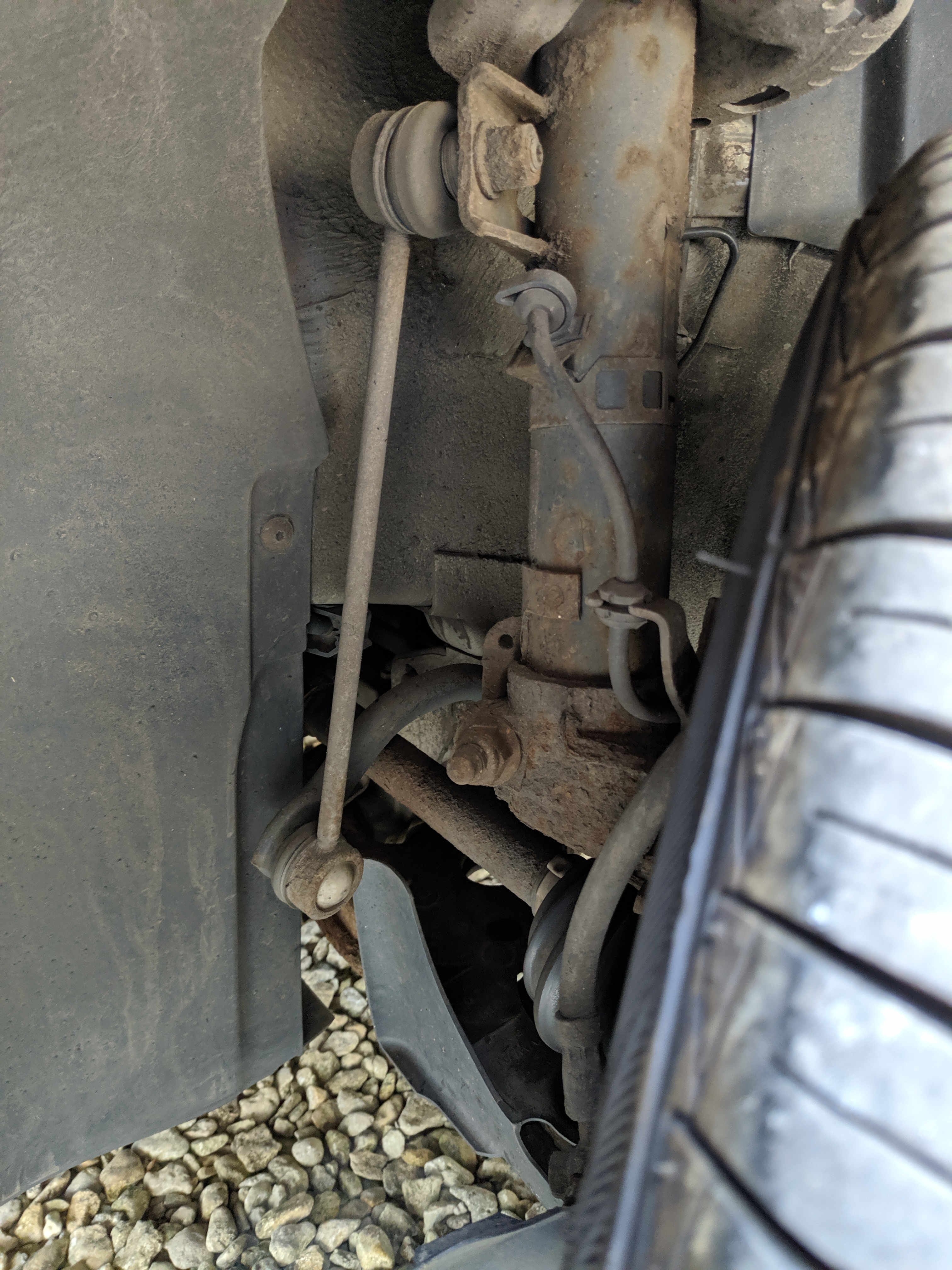

I wasn't sure what they were so I took a quick google and I made a mistake in my first post. I had the  Front Anti-roll bar linkage ball joints (and probably anything that was needed) replaced. Is this the same thing?
Yes and no; drop links connect the torsion bar (aka ARB) to the suspension arms or uprights, but they rarely use ball joints because they only need one degree of freedom, not two.

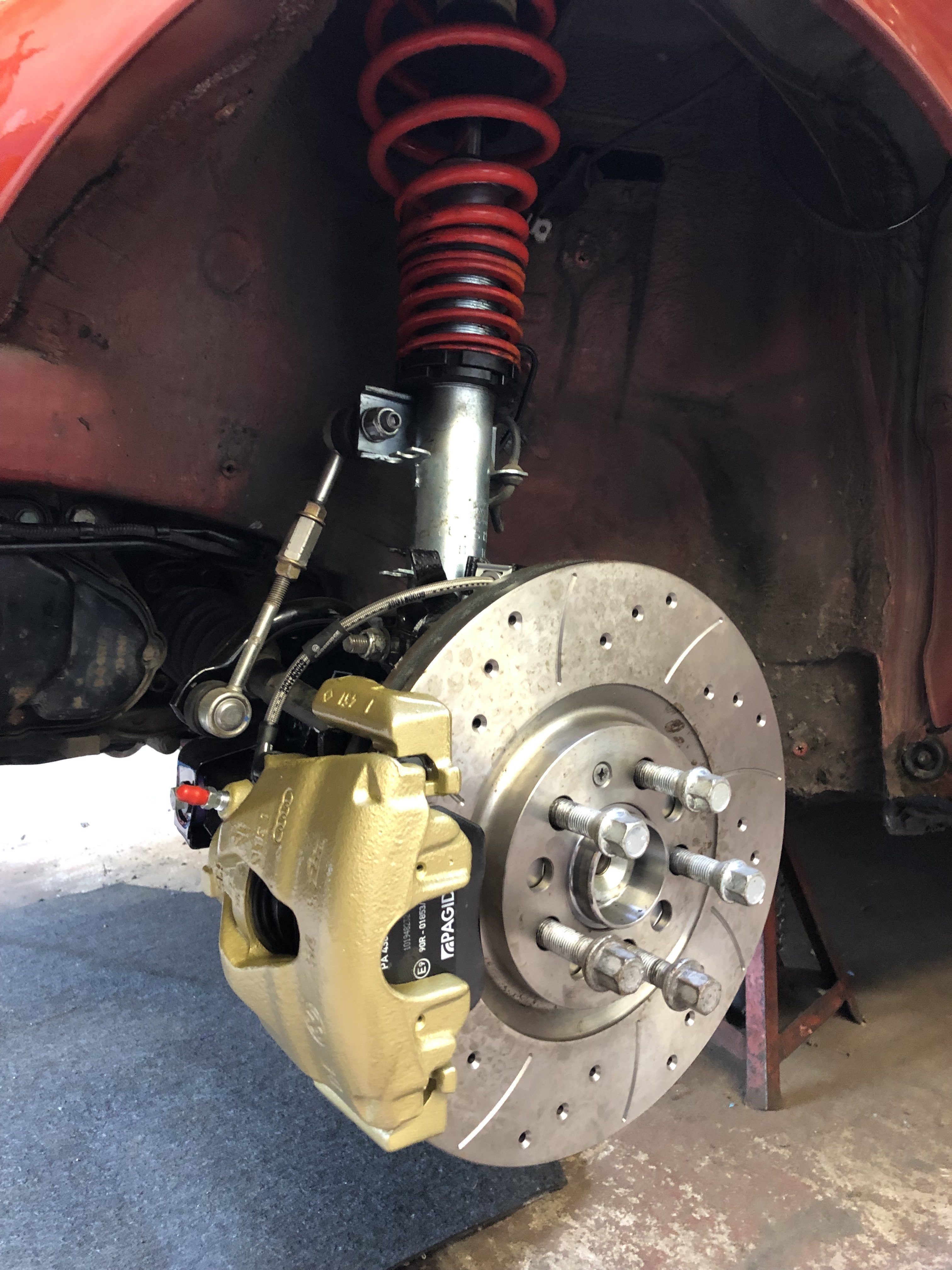

Ball joints on Fabia droplinks, both ends. Keep up Ken.
Yep, ball joint at top and bottom
That's super shiny. I've attached pictures of mine to show the comparison of what i'm use to seeing! 😛
