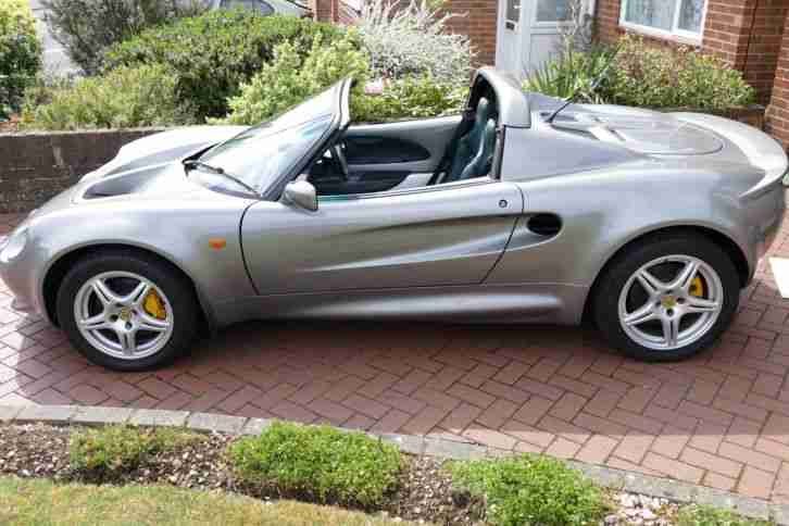

9 hours ago, digifish said:
That's completely crazy nonsense.
You put 15" and 19" on the same car.
You laugh but some people do
