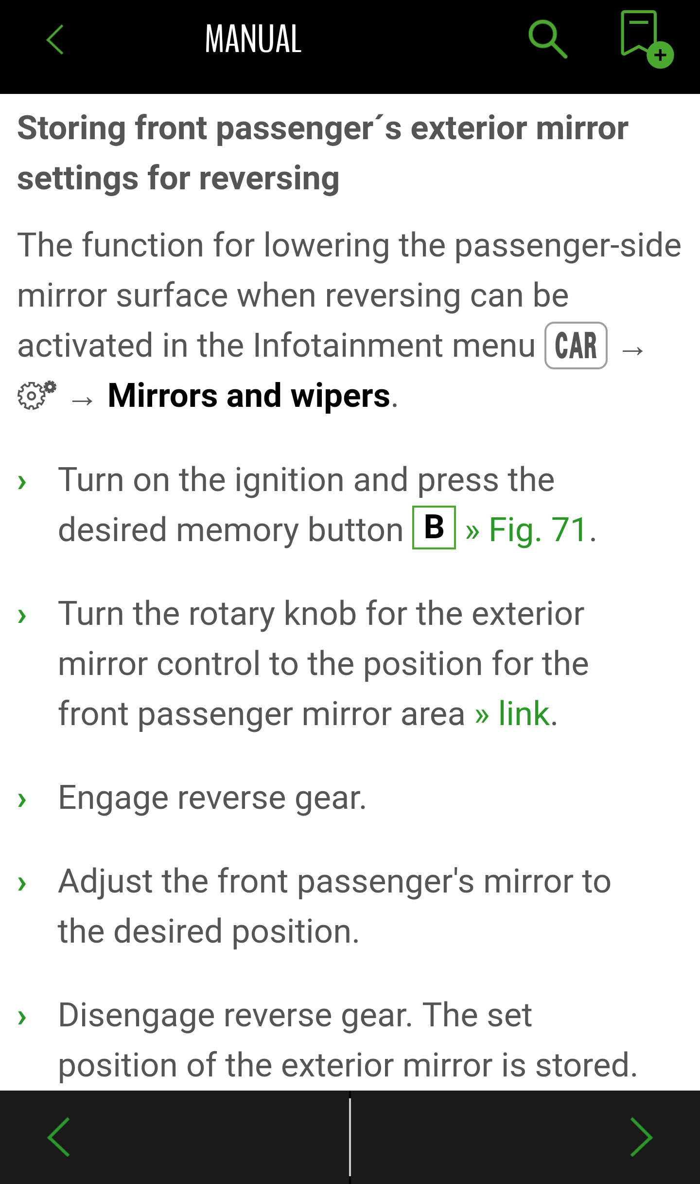

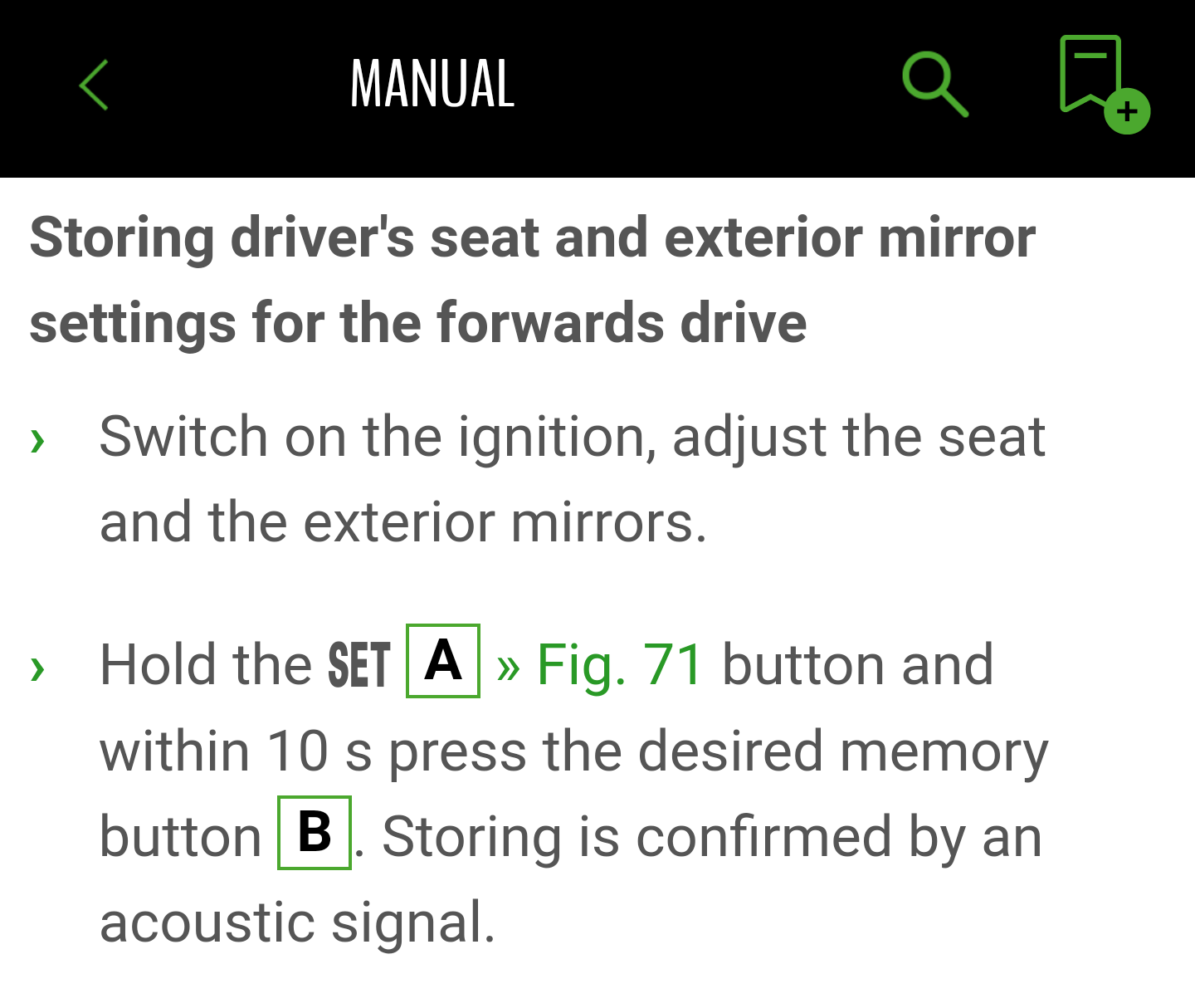

U need to do the seat memory storing procedure first, which stores seat position and mirror position.
Then u do the storing reversing mirror position procedure as explained below.
