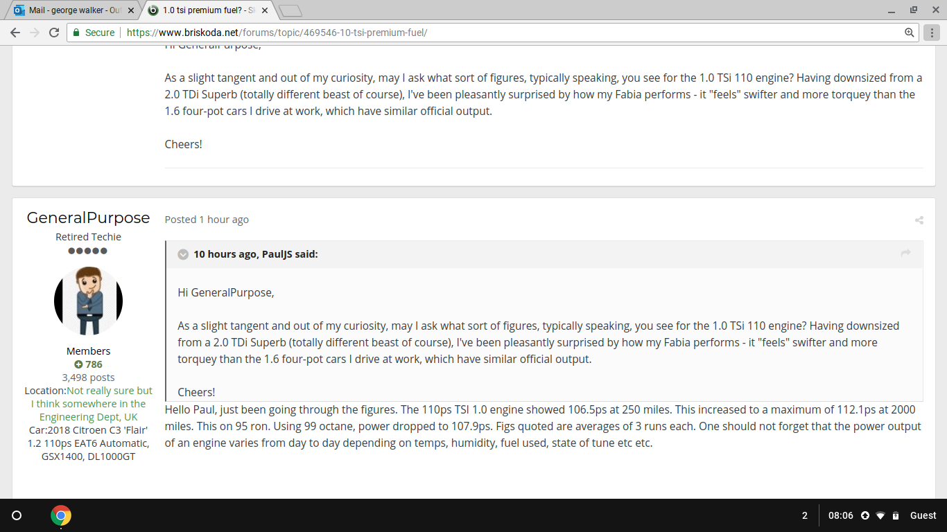

@GeneralPurpose
I had not spotted this post, interesting stuff indeed.
There is a Thread in Singletrack Forum on Super Unleaded and Small Capacity Engines that is saying much the same as you.

Hello Paul, just been going through the figures. The 110ps TSI 1.0 engine showed 106.5ps at 250 miles. This increased to a maximum of 112.1ps at 2000 miles. This on 95 ron. Using 99 octane, power dropped to 107.9ps. Figs quoted are averages of 3 runs each. One should not forget that the power output of an engine varies from day to day depending on temps, humidity, fuel used, state of tune etc etc.
Hi GeneralPurpose, thank you very much :) .

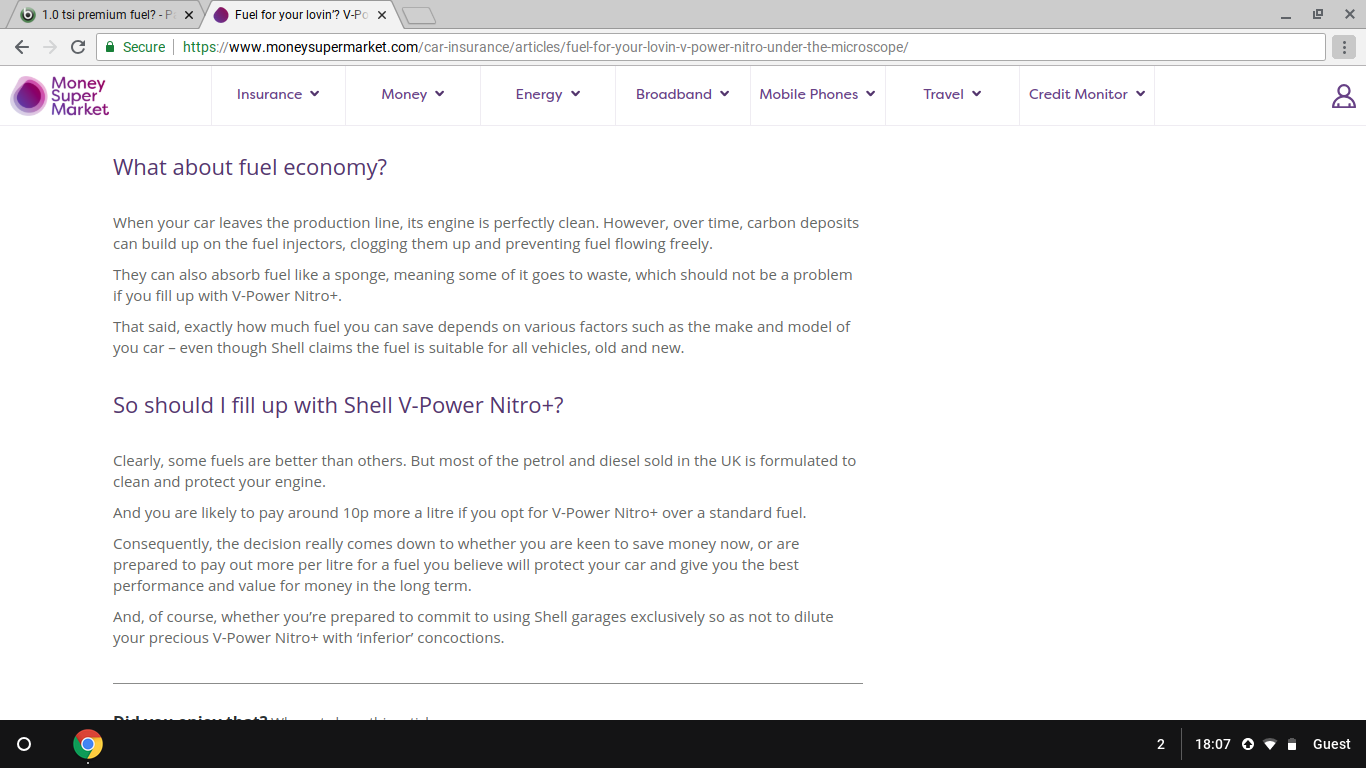

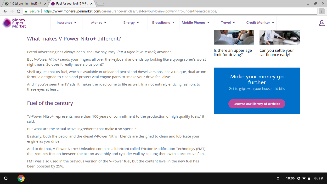

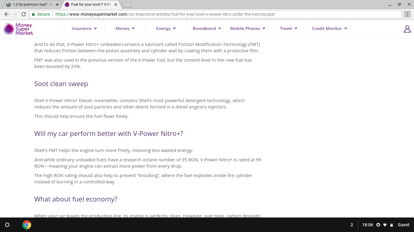

@GeneralPurpose
Which country is this Shell 97 ron from? & is this BP Unleaded in the UK as they do different fuels globally.
http://wikipedia.org/wiki/Shell_V-Power
In the UK Shell Super Unleaded was 98 ron (minimum)  until reformulated and renamed Shell V-Power & then again as Shell V-Power Nitro + which is 99 ron minimum in the UK.
http://costco.co.uk/kirkland-signature-fuel
http://costco.co.uk/fuel-q-and-a

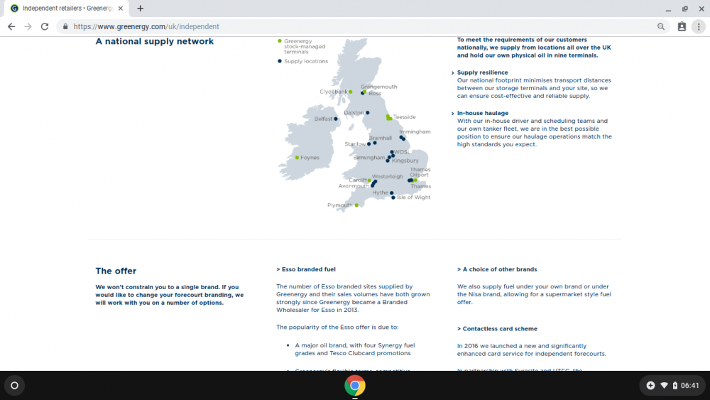

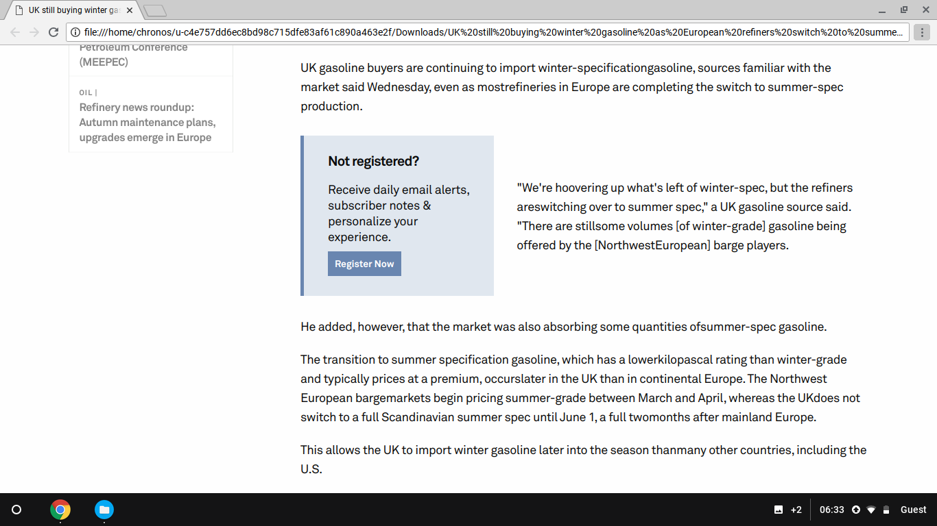

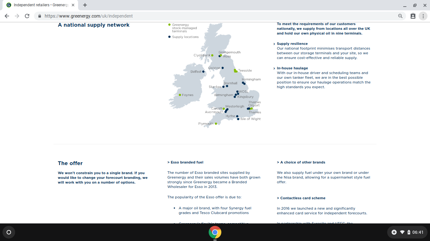

Really if these Fuel Producers, whole sellers and retailers had something special to show as to cleaning properties and increased fuel efficiency they would do side by side testing and give the results and not leave it to the likes of Fifth Gear to do.
Those that run large fleets of vehicles surely know what 95 ron in the UK would be most economic for their drivers to use.
As with diesel, billions of litres used annually from all different depots, pumps, brands.
Actually there are quite a lot of tests on shell v power's cleaning ability relative to other fuels.
We were not talking 'Cheap' Gas, as in the UK what you get is 'Gas' that might be less expensive than more expensive, but all to a standard, and often sourced from the cheapest source / supplier by retailers.
Then 95 unleaded, and is one different from another or Super Unleaded @97 ron or Super Unleaded @ 99 ron.
Do Royal Dutch Shell have a superior Additive Package in the fuel that they import with their partners Greenergy that produce and sell Momentum 99.
Or do BP, Esso or Gulf put in better additives in 95 than what Morrisons, Asda, Tesco, Sainsbury, or in the 97ron?
Below was published in 2012.
