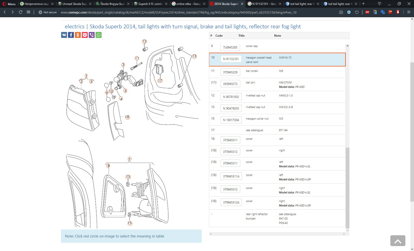

To "LBLJ" - If I understand you right - may be this is what you search: "N91132101"..
They are the 2 screws without reference behind the cover piece number 18.
I guess they are fairly standard but want to make sure to be on the safe side so that the car last as long as possible.
BTW: Very interesting site indeed .... :-)
Edited by LBLJ
Wrong part number on the schematics

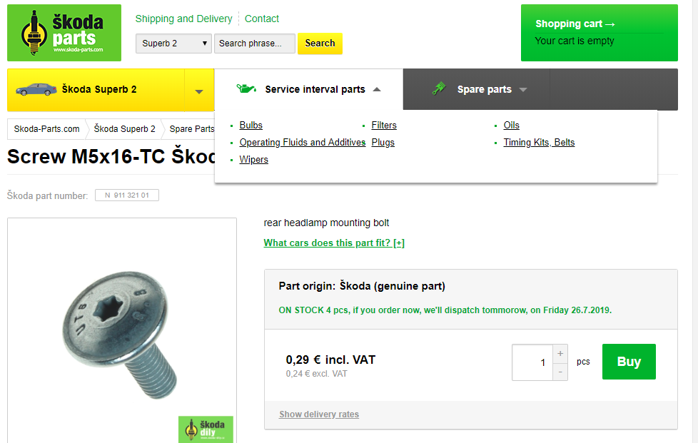

From the pictures it really look the same, I have ordered it. time will tell.
Thanks a lot :-)

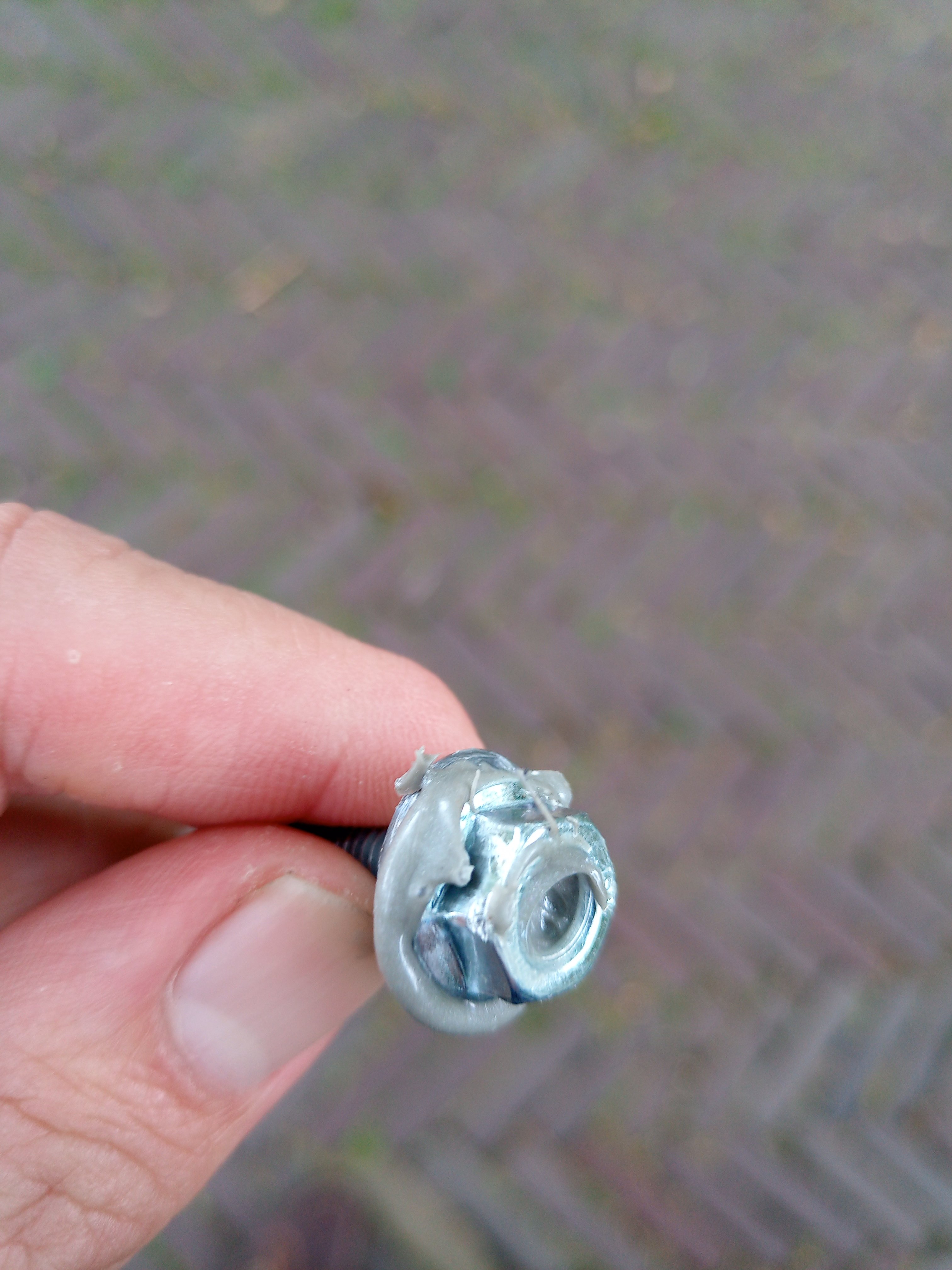

In the end did not needed to use a screw extractor. Used metallic epoxy to bind the screw head to an M6 nut.
Epoxy works wonders. Almost as useful as a Swiss army knife.
See attached picture.

To "LBLJ" - You are good :)
To "LBLJ" THANKS !  - never thought of that ! Was going to cut a slot with small anglegrinder disc and add WD40 and brute force.
It works as long as the parts which are going to be covered in Metal Epoxy resin of 2 pieces are degreased  __AND__ you let it solidify overnight so that the binding is really solid.
Same process with plastic parts but use plastic / general epoxy resin.
Edited by LBLJ
