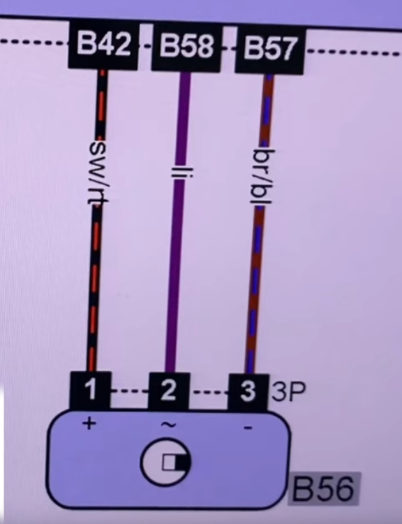

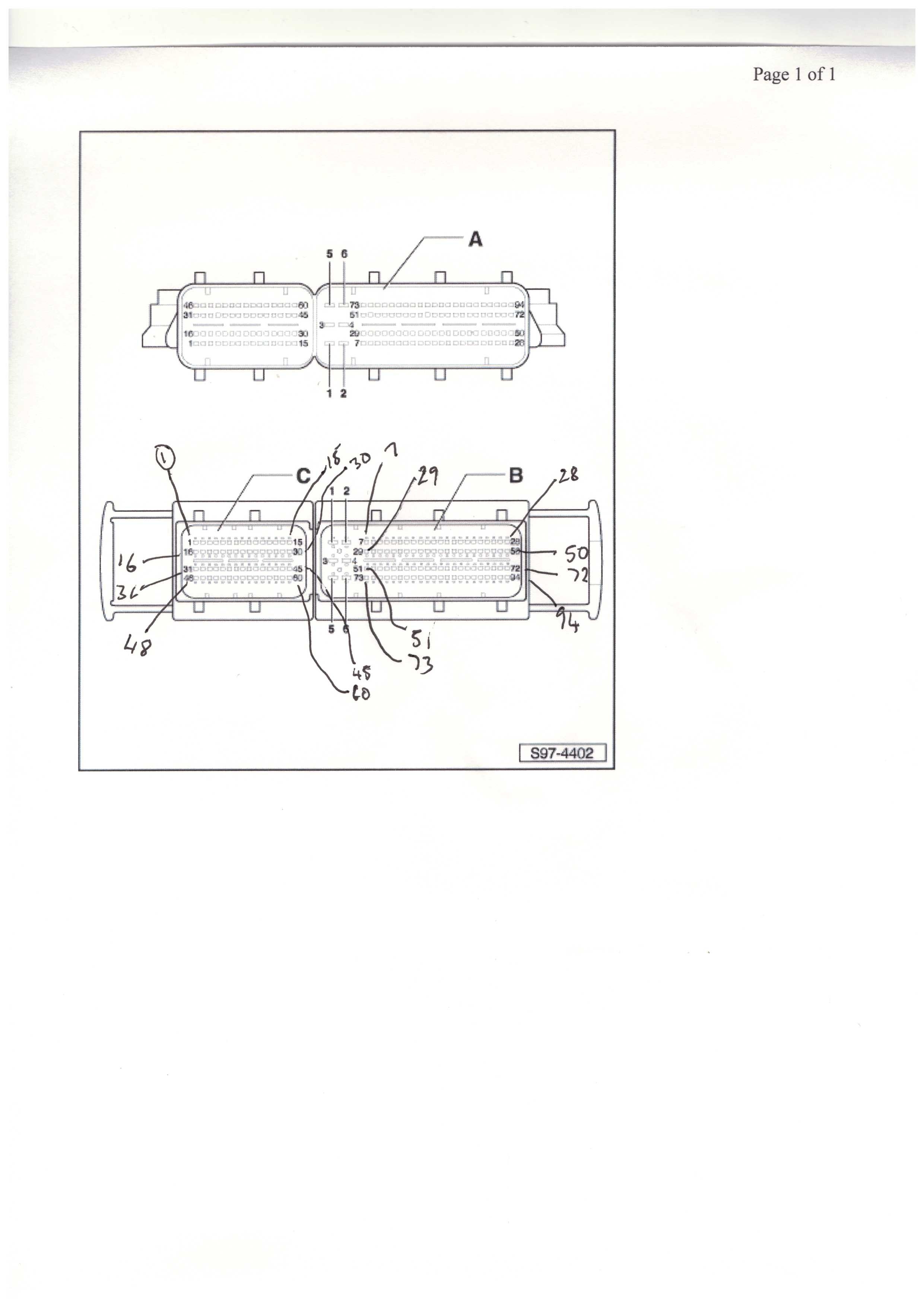

G28 pin 1 (Black/Red wire) ECU pin 42
G28 pin 2 (Lilac wire) ECU pin 58
G28 pin 3 (Brown/Blue wire) ECU pin 57

Connector "C" for referance

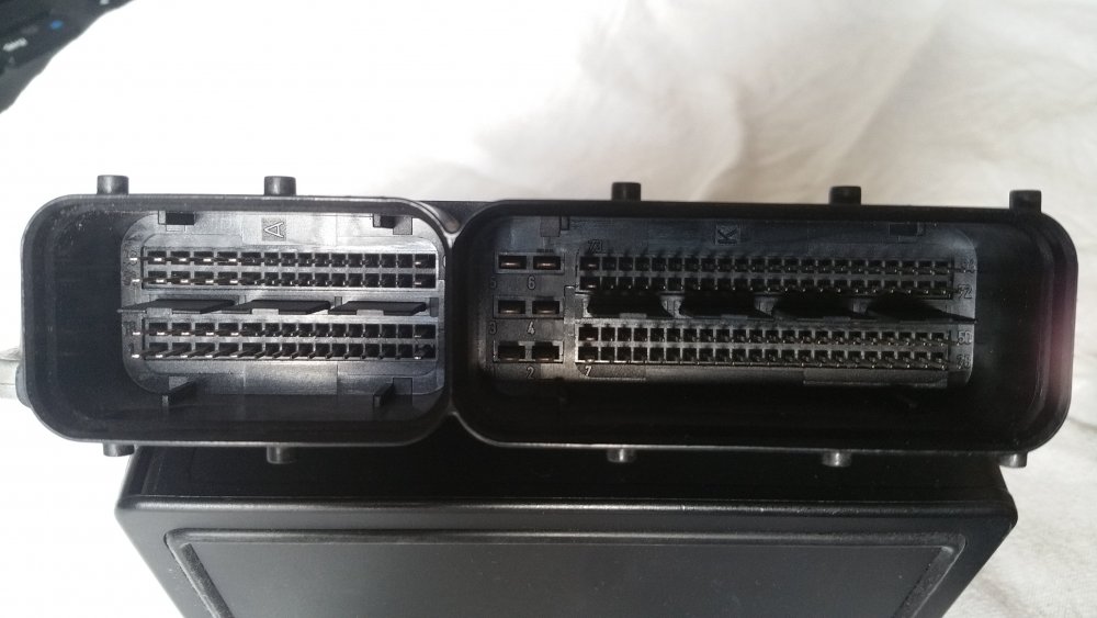

Just accessing the plug on the sensor is not easy and the ECU isn't much better. The ECU is held in place with an anti-tamper cover and there are a number of videos online showing how best to remove the dome headed screws using a Dremel. You may not even need to remove the ECU itself, you only need to remove the smaller of the 2 connectors at the front. This can be done by sliding the locking lever out so that the plug can be removed. The diagram that I have attached shows the connections and the wire colours. The diagram provided by nige8021 above shows the pin connections on the ECU plug. Look at the connector labelled 'C'. The back cover on the ECU plug can be slid off revealing the wire colours. Use a multimeter to check for continuity to the sensor plug. On mine, I had a 2 Mohm resistance on the lilac signal wire. Pulling on the loom just in front of the battery cause the resistance to change and one occasion I actually managed to get it to read 0 ohms.
