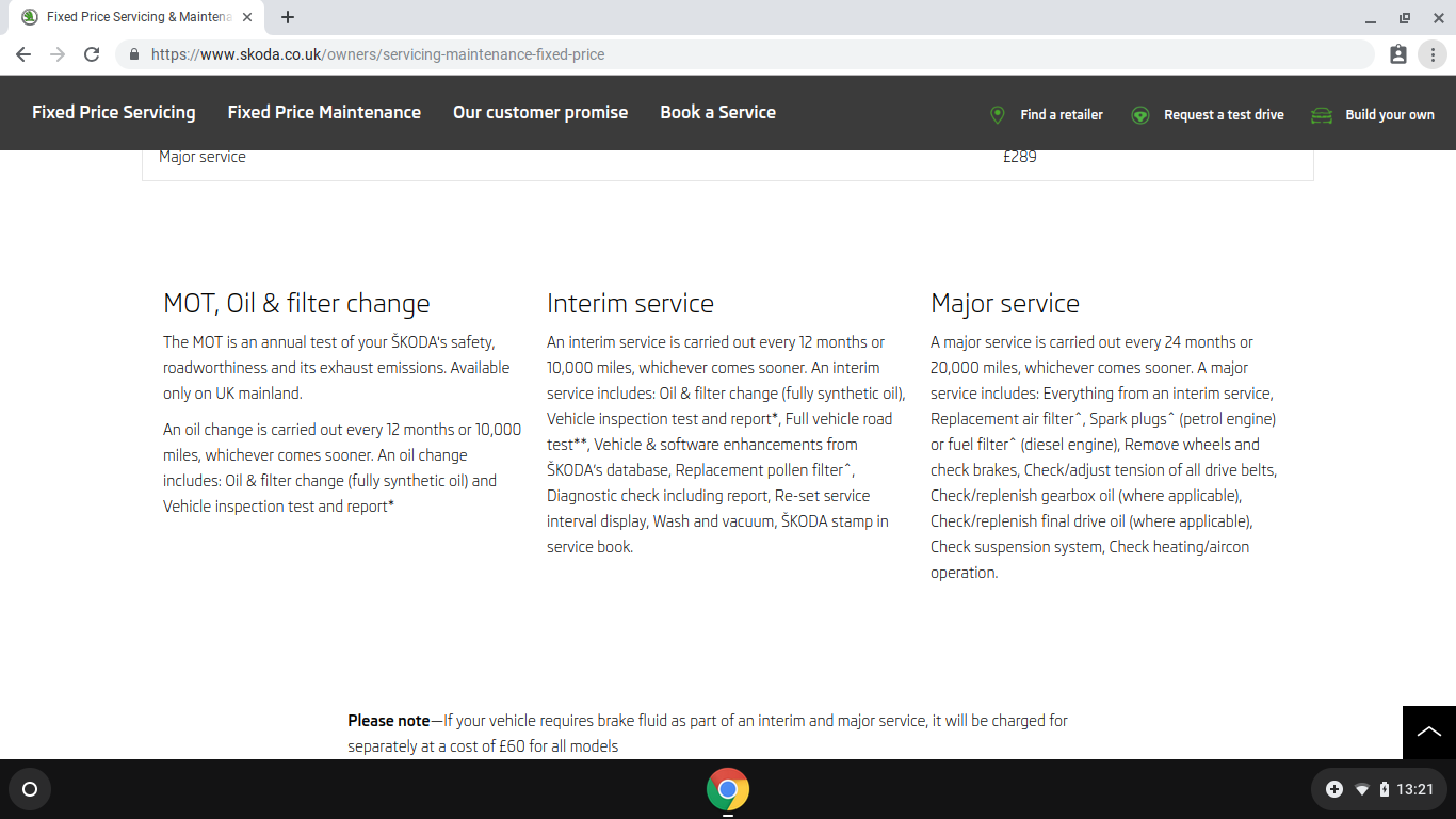

On fixed Servicing Pollen Filters are on the 2nd service (Major Service as they were called.)
@ 4 years which is the 2nd Major Service the Pollen filter would be due again, and the spark plugs and air filter,
but that would be if mot already changed, but then the Air Filter should be checked and if checking you put in a new one.
Same with Spark Plugs, if you are removing to check you are as well to fit new ones.
If anyone charges Fixed Prices and then do not fit the parts someone is doing well and is not the customer.

@Roottootemoot As they're a franchised dealer they advised me they don't offer fixed price servicing. I paid around £200, with everything itemised on the bill. £75ish for labour then parts, oil plug, screen wash (pah), cleaner?, oil, filter, pollen/dust filter. They also tested the air conditioning for free apparently. Can't see any mention of plugs on the service history, although it had a "brake fluid service" back in July last year. They guy had to call me back to check what was needed first before I booked it in and he could give me a price.
So they just did the Interim Service that Franchised Dealers participating in the Fixed Price Servicing do for £179 but charge more.
Looks like it 😛 I miss having a printed service schedule outlining exactly whats supposed to be done when for this particular engine. Even that skoda website says "These items will be replaced, if required. This will be determined by the manufacturer's service regime data." but then, how do you know what the regime is 😕

The point is.  The Manufacturers Recommendations are at 40,000 miles or 4 years for Spark Plugs and Air Filter.
But some pay for a 'major Service' at the 2nd Major Service and a Technician decides without checking.
The Brake Fluid recommended schedule is clear, but Wet Clutch DSG Oil Changes at 40,000 miles and Haldex @ 3 years are to be found but buy a Service Plan and they are not done at the Services. Pay extras.

If Spark plugs are each 2nd major service and Air Filter at a 3rd major service it just shows the rip off the Fixed Price Service is @ £289 where parts are not getting supplied.
Parts in the stock room, no labour checking the Plugs or Parts not being changed but the bill including 20% VAT is the same.
