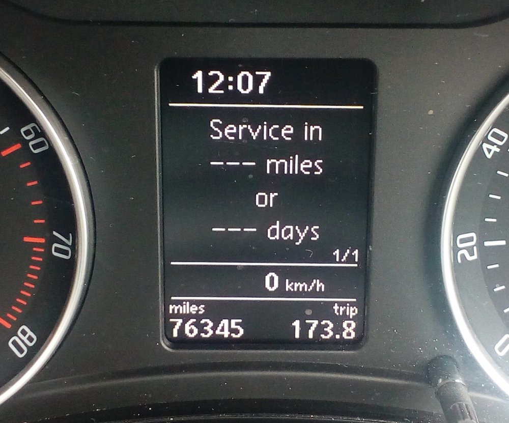

Got home ; checked MFD Vehicle Info display - ; it said “service in 370 days/9,400 miles” ie in 12 months.
I concluded that technician had just reset existing service schedule with his CAN device – without changing the Fixed/Variable setting.
Took car back – Service Receptionist said “no prob. - to change ; will take 1 minute”.
Car returned to me : drove home.
Today I’ve checked MFD Vehicle Info – and what it says is in the photo.
Can see that Service Interval has been changed to Variable as requested.
QUESTION: Should the mileage and date values have been entered by the technician?
Or does the car generate these values itself based on its assessment of how it’s being driven?
As it's on variable, it'll take a little while for those figures to appear. Completely normal :)
Most people suggest if you're doing less than 10k a year and it's mostly shorter journeys, you're better to stay on the fixed service option for engine longevity.
Hi langers2k : many thanks for your quick and reassuring answer : will await my car's auto up-date of info in due course.
