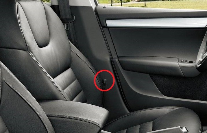

Do anyone knows what this thing is? is it an alarm sensor or a button for something? i have seen the same on Superb II also.

I think you forgot to post the picture...
ahh, sorry 😛 Now you have it ;)
Edited by 95mathias
Probably the button for deactivating the interior monitoring.
Okay, thanks for the quick reply ;)
Yes it is
I believe you also can double click on the  lock button on the key fob, this will also lock car and activate the alarm but not the interior sensor.
The second press also deactivates the deadlock security.
