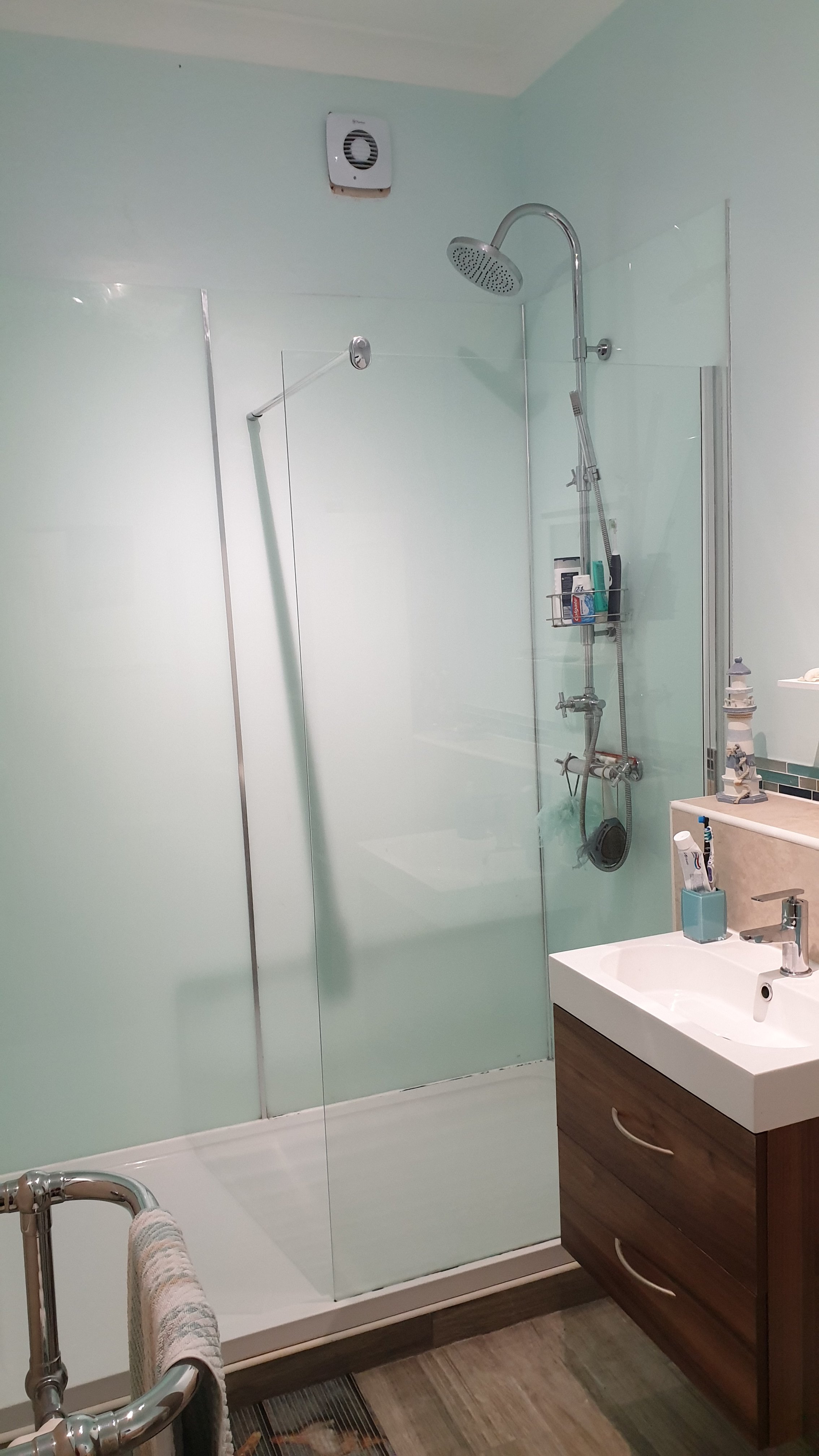

This is the layout of the bathroom from the door.  In this part of the house (tenement section) I have people living directly above me, so a ceiling mounted fan is out.
The exposed plaster below the fan is from when the original Cyfan was installed. The current fan was only a temporary measure until the (broken) replacement one was installed.

@Fin69  - I'd second the recommendation of a Manrose, and I know they do a model that fits where the one in your photo is.
I would start by looking at the decibel rating,   basically you have to pay more for a quiet fan
There are versions with in-line fans (fan goes in the ducting) but these are really for lofts or where the duct passes through a cupboard
If your bathroom is 4m (13 feet) long you need to be looking at ones with 5 inch or 6 inch ducting to move the volume,
try this list, Manrose are good
https://www.tlc-direct.co.uk/Main_Index/Ventilation_Index/index.html
