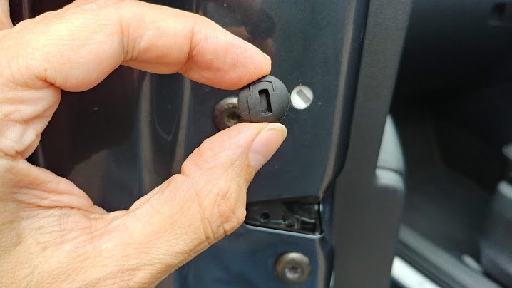

Looking at the drivers and passenger doors there is a soft rubber grommet with a drivers sized key slot covering a nylon button also with a key sized slot underneath,didn't want to mess with these as I'm not sure what they are ?
They are Child Locks/ Back of Police car keep detained persons in,

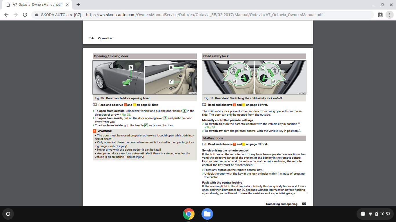

The OP is talking about the front doors.  You won't get child locks on those doors.
Sorry about that, i looked at the picture and did not even do that properly and never read every word.

I can open the doors from the inside only, all external door handles including the boot are locked. I think the nylon buttons maybe to release the door locks when the doors are locked in the open position,they are located on all doors.
