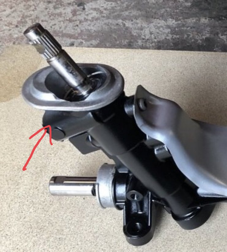

is there a guide on location and how to replace this please
to be honest, I am just fed up with paying money and the problem persists
The sensor it mounted in the side of the rack, held in by two screws.  Very easy to change.

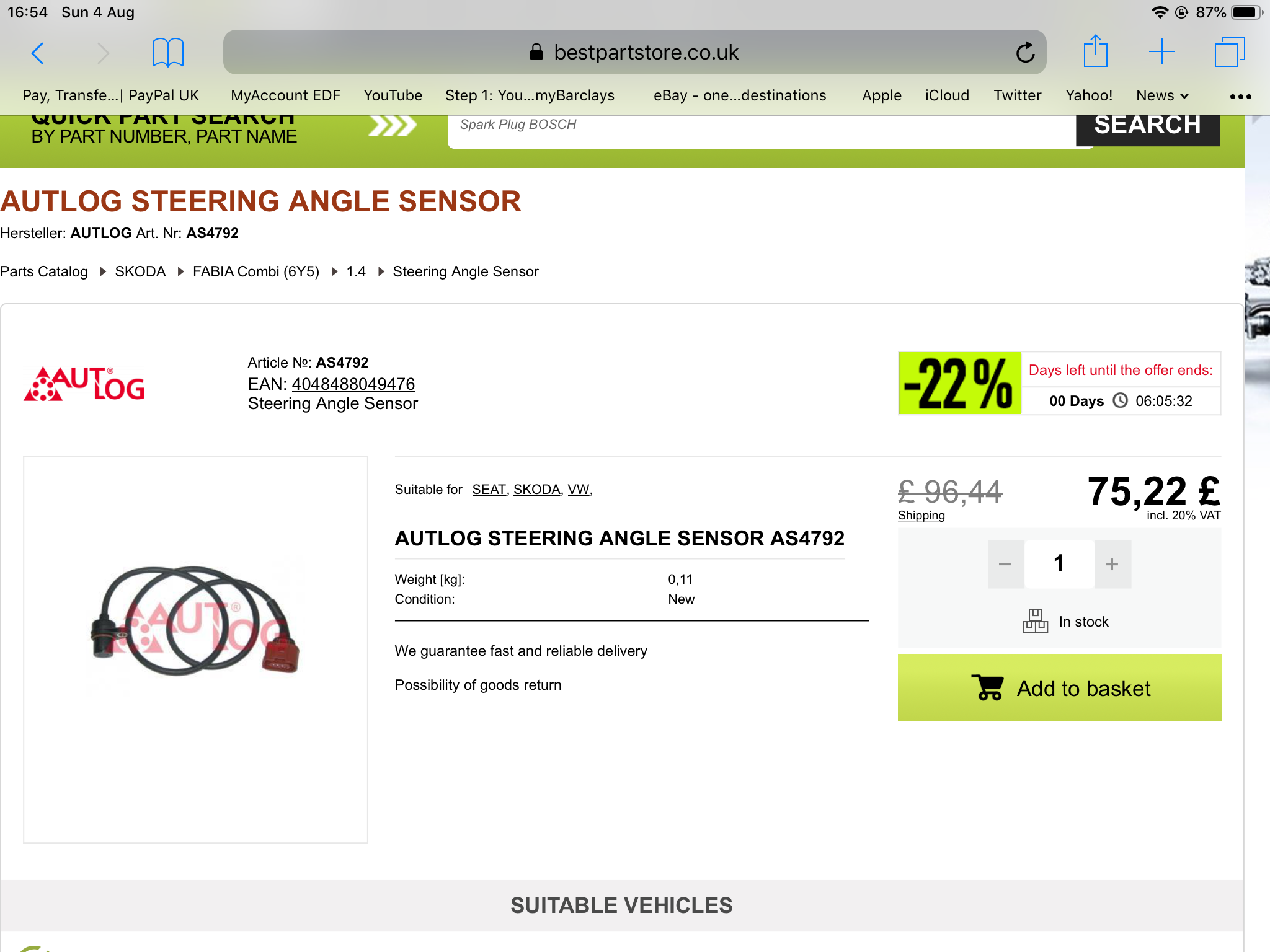

can I ask does this have to be genuine Skoda part or is aftermarket ok
have spent so much on car recently
Not sure I’ve seen an aftermarket one.

do you know rough price of genuine Skoda part

It's two torx headed machine screws, you don't need to remove the arch liner, just chuck it on the four poster because it's a pain changing the cable.
